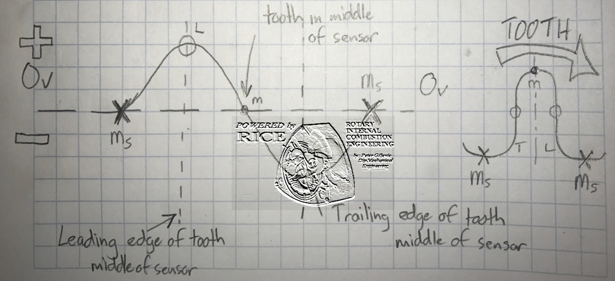

stevieturbo wrote: Wed Aug 28, 2019 10:23 pm edit, notations on my first pic pic probably didnt make so much sense, so have amended it here
Stevie did a good job above.

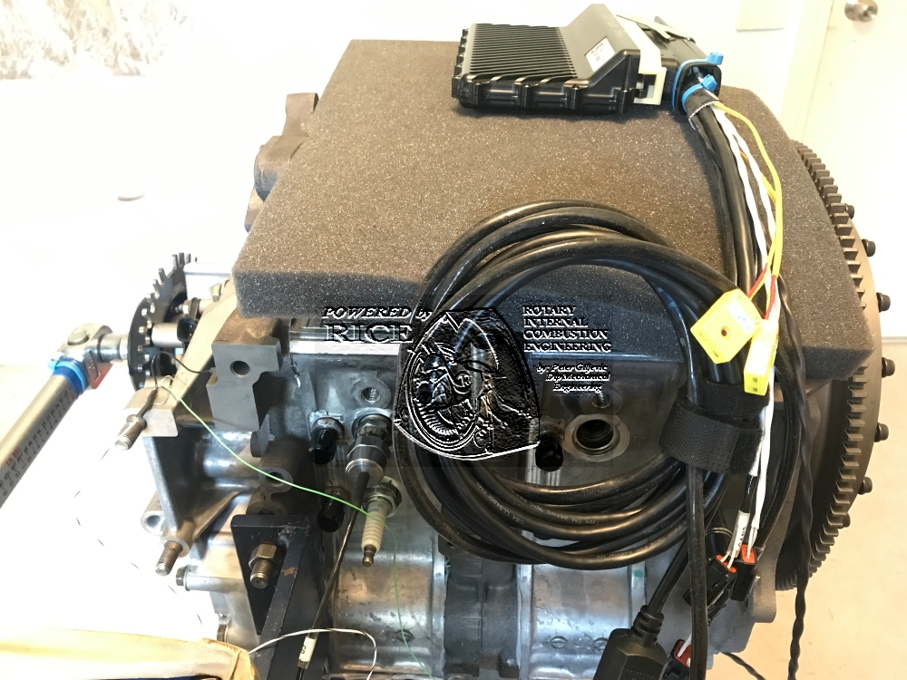

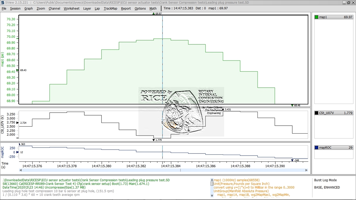

Here I same idea of logging the crank wheel I made up and a Syvecs pressure sensor (of appropriate range) to do a non running or roughly cranking speed engine TDC indirect measure, as its on a total shit box of an engine (Wanker or Wankel) :) there are a few caveats but once you do some testing its repeatable and an alternate method where direct measurement is not possible ;)
Also debunked a rubbish technique someone high lighted to me about using Mr Bubbles to do a similar thing....... that is not so nice :lol:
VIDEO > https://www.youtube.com/watch?v=wtOWk260sPc
And a few [pics] below....

Would be interesting to see with 2 sensors what pressure in the chamber is like there ? Or do you think they'd pretty much mirror each other ?
Re: 36-1 Trigger wheel fitting
Posted: Fri May 29, 2020 3:23 pm
stevieturbo wrote: Fri May 29, 2020 2:35 pm Would be interesting to see with 2 sensors what pressure in the chamber is like there ? Or do you think they'd pretty much mirror each other ?
You mean the T & L plug locations? if so those are basically the same despite having the T hole (very small opening to chamber) and L hole being full sized of spark plug diameter opening.
I did not want to make a career out of it so once I gathered the data I called it :lol:
