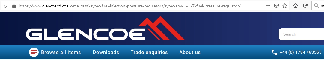

So I say I will just send him a link after he says I should have contacted them to supply the right part :roll: cause their own web site listed it as 1.7:1 then they told me on email it was 1.7:1 and been supply for years and I am the first one ever to report otherwise (that old classic) last thing I wanted to be doing is wasting my time on FPR testing :lol: Anyway I digress, go to look on their site https://www.glencoeltd.co.uk/malpassi-s ... regulator/ just now to send to my friend and just like that "it gone" :lol: but they are still all over ebay so took a few happy snaps for history sake ;)
Moral is Stevie not so much that they look cheap but I guess I had to prove the function of it. The principle has merits, just need a unit that does the rising rate as per the advice and all will be good. Will get some of the right part number to test no doubt, don't think it will come from these people at a guess............
Just putting this here for others information cause I guess in time there will still be some kicking about or being sold on E-Bay, just don't get it expecting that it will be a 1.7:1 enrichment rate, hope this helps.

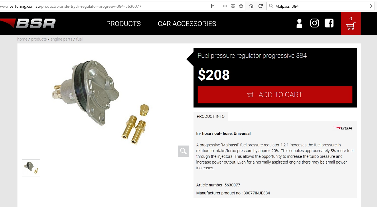

old mate LOLZ.jpg (93.34 KiB) Viewed 61323 times

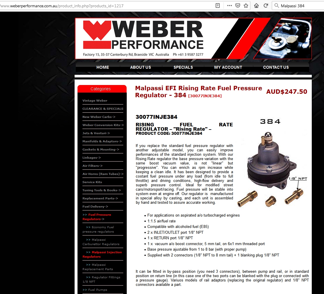

lol 3.jpg (111.66 KiB) Viewed 61323 times
lolz 2.jpg (432.07 KiB) Viewed 61323 times

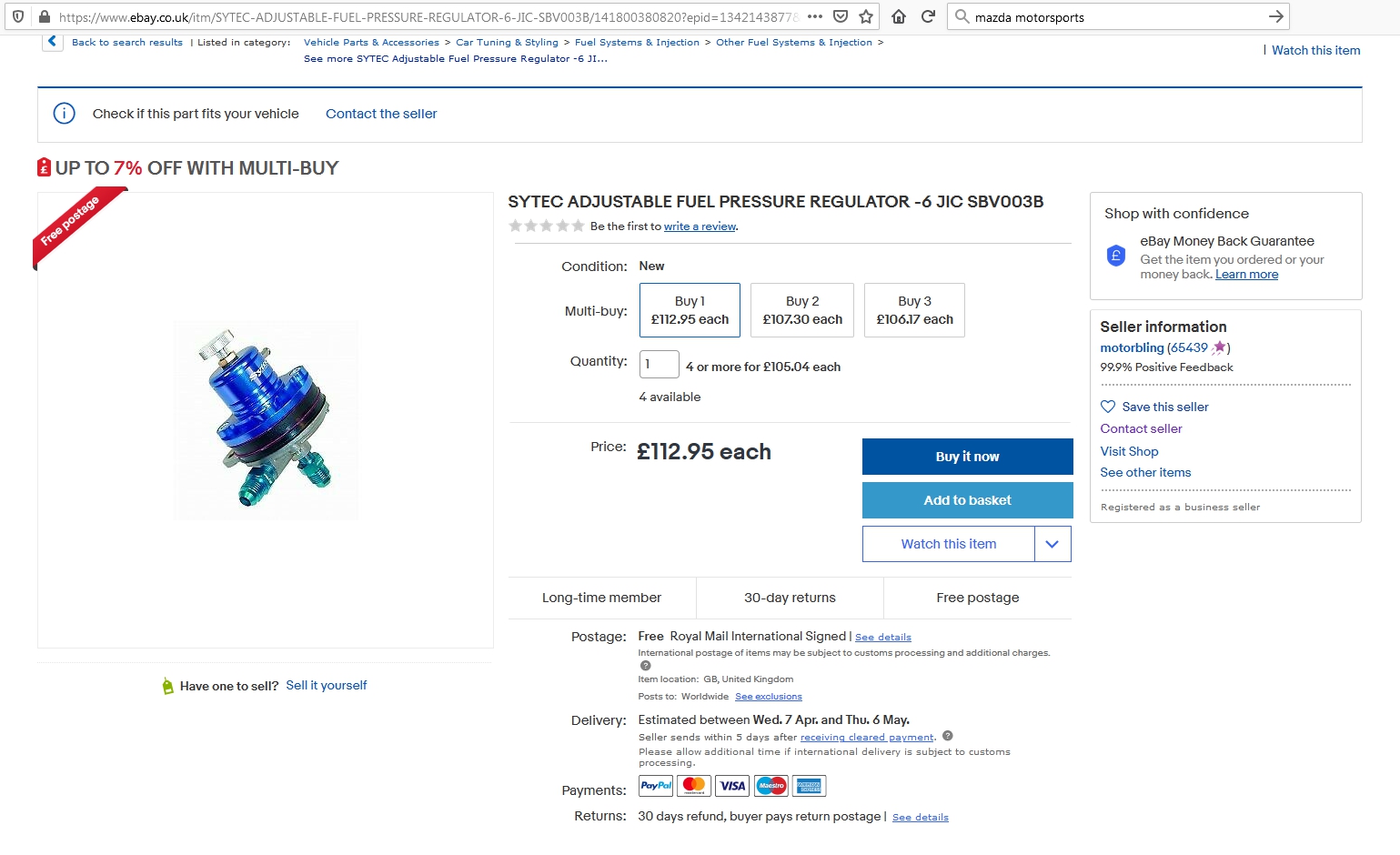

Boxes for the Sytec SBV units I have are printed 1.7:1, you can image my shock when they tested at 0.97:1 once on boost :lol:

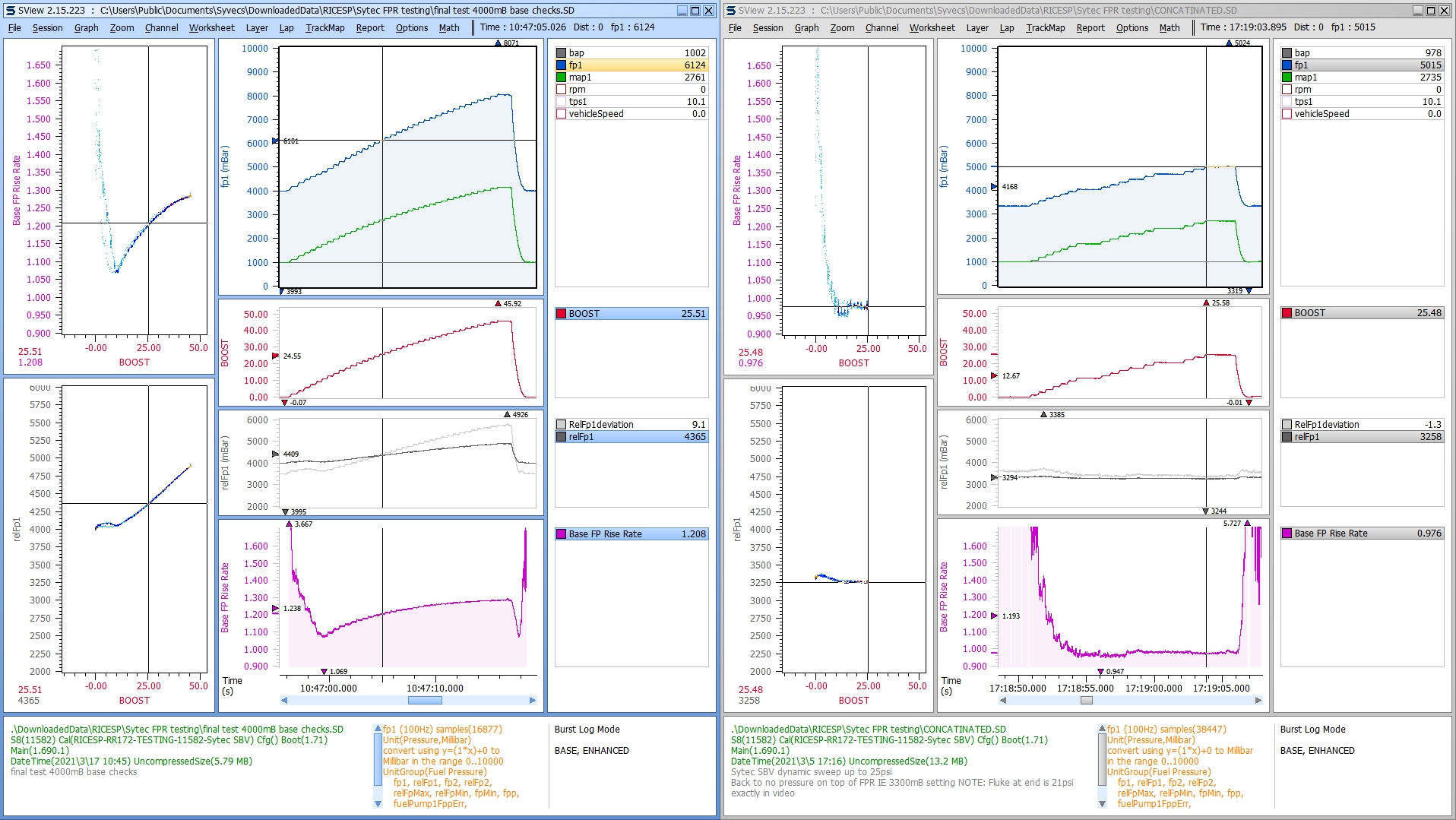

My 'gut' feeling is that all of these in stock form maybe are only applying a rising rate in vacuum, and on boost are 1:1 (or there abouts)
See the original test (on boost) clearly 1:1 rate, in video I show its only rate change happens in vacuum region, maybe this is what they intended? wont know till I get other models and test them an plot the curves.
25psi 1 to 1 V 1.2 to 1 YO.jpg (910.14 KiB) Viewed 61302 times

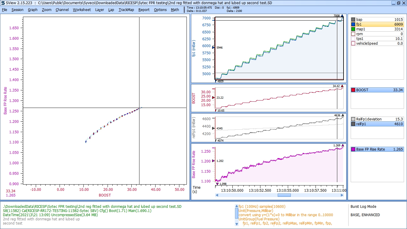

Here is a close up of my modified reg, very smooth in response to step changes, and is true rising rate in boost, picked normal levels of boost people use typically as example range.
10psi to 33psi don.jpg (434.44 KiB) Viewed 61302 times

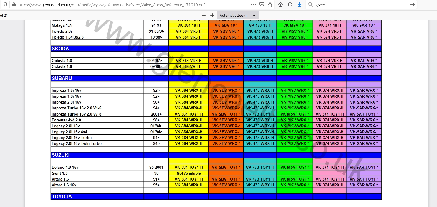

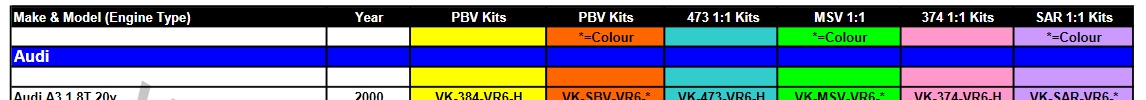

My friend I was telling you about who told me I should have rang them to get the right part (lol) seems like he has the wrong part as well !
https://www.glencoeltd.co.uk/pub/media/ ... 171019.pdf
Regulator 1 2021.JPG (109.05 KiB) Viewed 61268 times

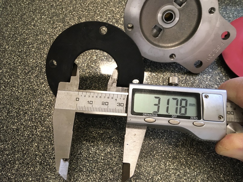

Posts: 524
Re: Port Injection Fuel Pressure Regulators
FYI a "power boost valve 384" and Sytec "SBV" is the same shit only difference is a changed top hat some longer bolts and nuts on bottom to hold it together all else is identical, listed as 1.7:1 rising rate :lol: which we know is bullshit cause I tested two of them and they showed 0.97:1 rate in boost.

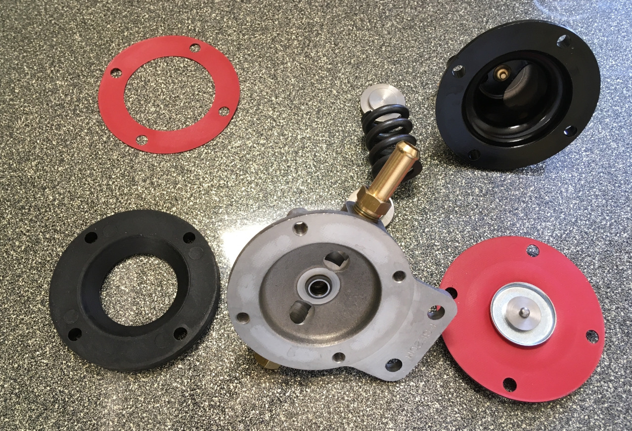

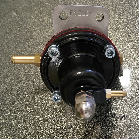

Here is what my mate ordered pulled down.
Little technical explanation there is no way in hell it can be a rising rate in boost cause as assembled the larger area of the disk points down and matched the area size on the fuel chamber side so any imparted force cancels out the fuel side, there is no multiple so indeed it will be 1:1 (as they list on their own PDF) but they still sold it to him as a 1.7:1?????????
Stevie is seems was right about this company :lol: lucky for me I made my own after working it out myself with zero help from them or Malpassi :roll:
Regulator 4 2021.JPG (143.02 KiB) Viewed 61268 times

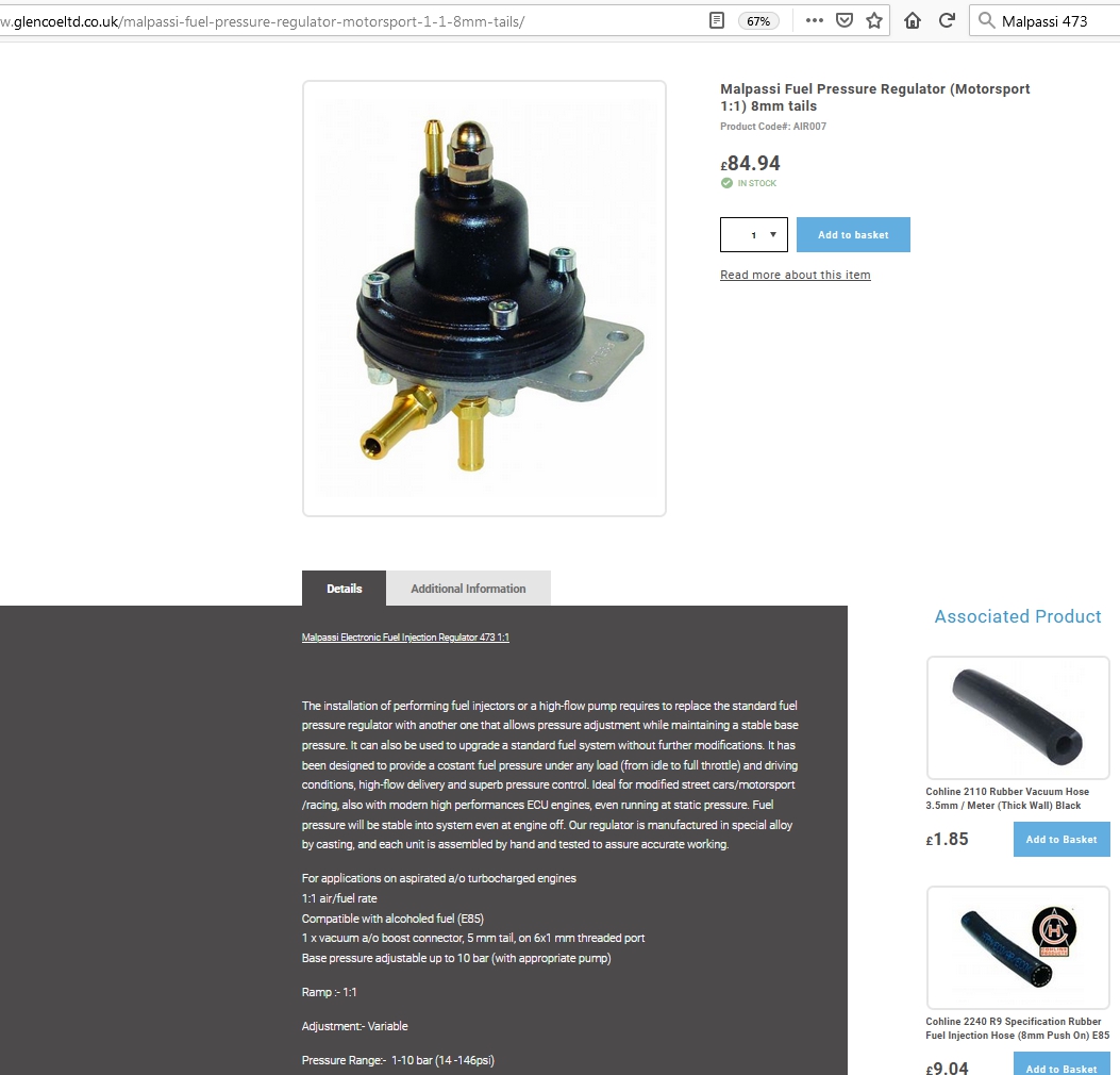

384 type is not 1.5:1 or 1.7:1 (or 1.2:1 in one ad)...... just pick a number out of thin air and sell it lol
473 type is 1:1 not 1.7:1
LOL 473 1 to 1 wtf.jpg (307.44 KiB) Viewed 61261 times
