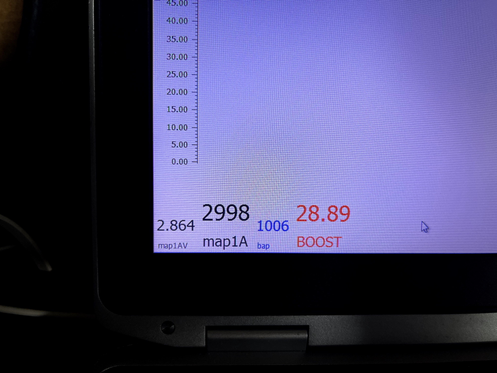

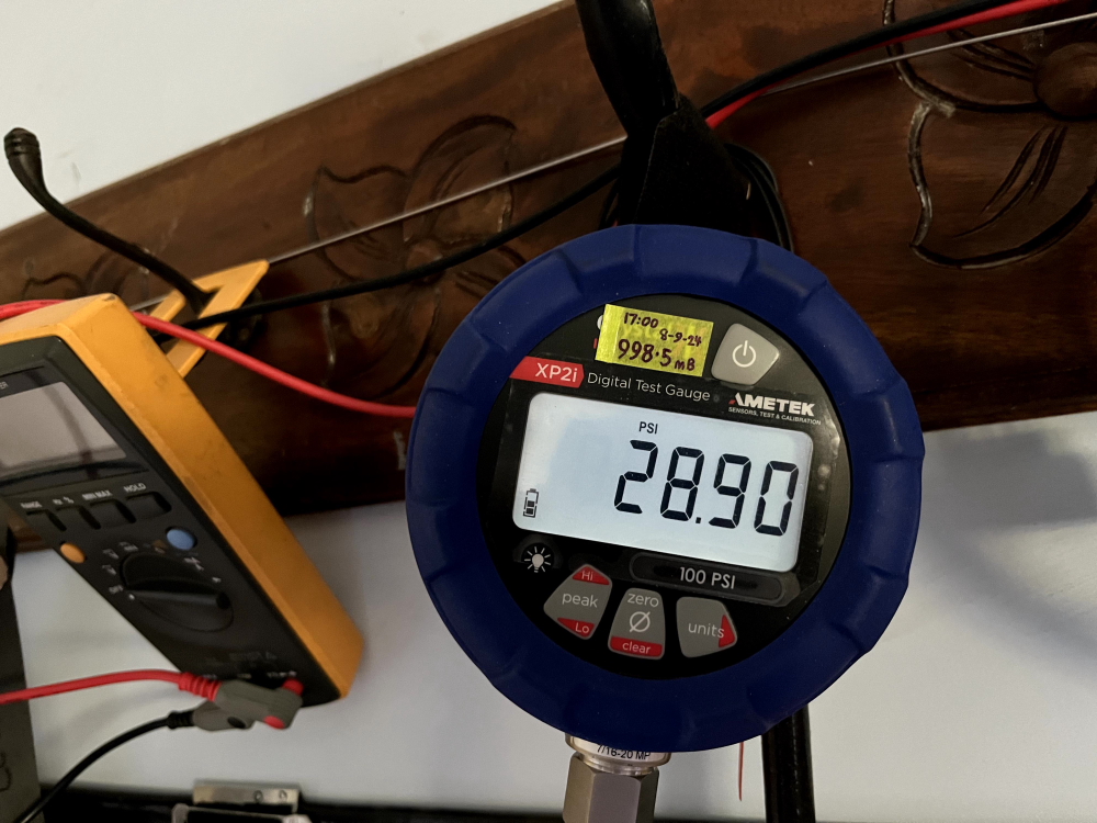

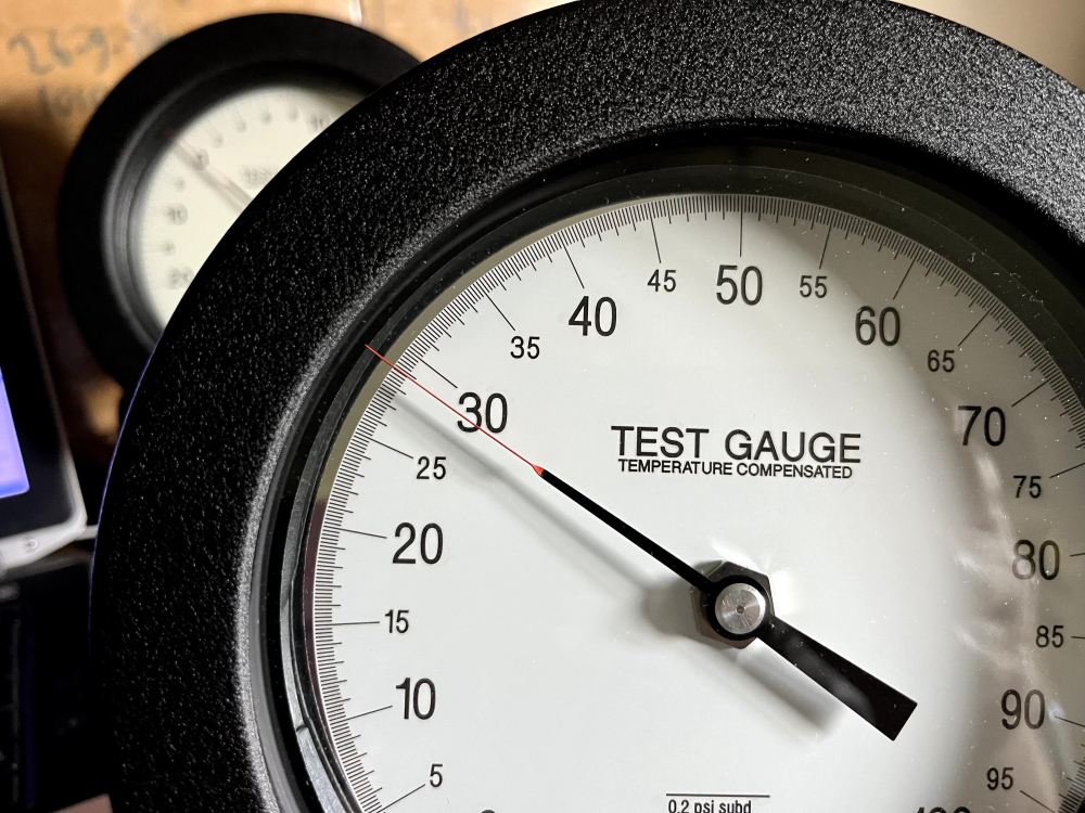

Depends how excited you want to get (like everything in life) but is nice to do your own calibrations of all sensors.
Here is how I do mine and for others if you want perfection
MAP sensors you need to know your exact ambient pressure at the time you calibrate then (easy enough to get) and validate if you have an appropriate reference sensor and do some maths as pictured, or you can guess it as well using tools in your phone if you have nothing else on hand
cal don yo3.JPG (577.5 KiB) Viewed 30007 times

Re: Syvecs map sensor identification
Posted: Sat Sep 28, 2024 10:11 pm
I use a live bap reading sensor input as its is amazing how much it can change in the course of running a test, it is all down to how anal you are, some love anal more than others
