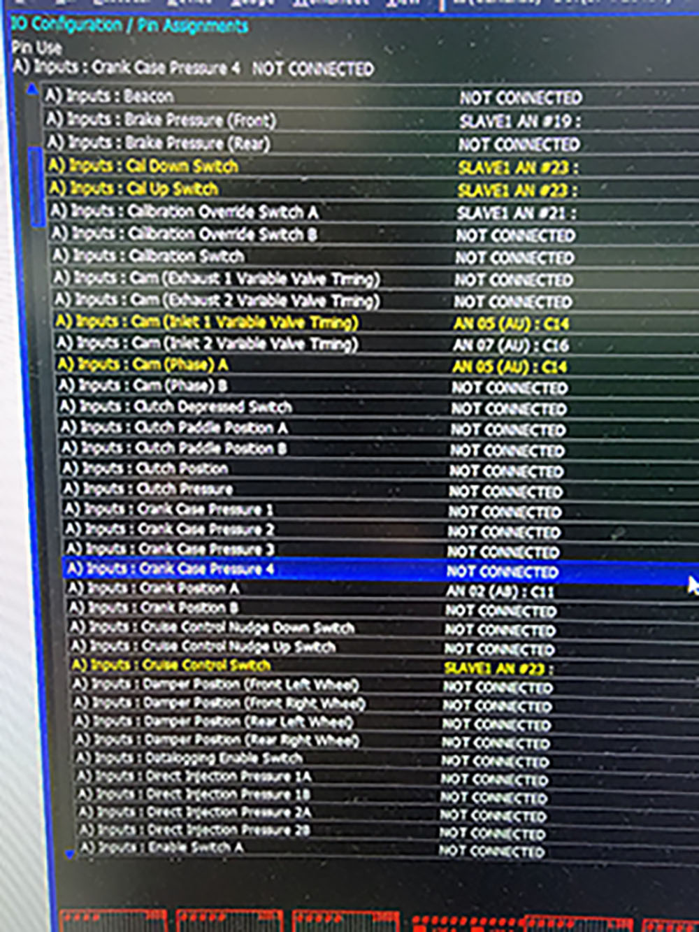

So you're right yellow is signifying double assignment. So i have a few things that are double assigned. I definitely did not change any pin assignments, and have just been running this how it shipped out of the box being a plug and play kit. I have double checked assignments with the Syvecs manual pinout. Crank sensor is assigned correctly to AN02. And cam is supposed to be AN05. I am leaning on the fact that the Cam (Inlet Variable Valve Timing) is not supposed to be assigned at all as i don't see it depicted in the manual. There are two other outputs for variable valve timing. (FUEL15:A24, and FUEL16:A25) which are correct.
Seems beyond strange, but could the ecu have reassigned pins while it was running? I doubt i could have fat fingered a shortcut that would have caused this...
The other odd thing that was happening just before all of this was the TACH needle sweeping to max and holding there, as well as what seemed to be a %25 TPS limit. Not sure what that's about, but at this point that is a secondary concern. Maybe something to do with a limp mode. Also, I have no intention of using the Cal switch out of the gate, but for some reason that is triple assigned. Again probably not related to the trigger issues, but just noting.
I will get a live view of the synclog after work today. Figured id start by confirming all the pin assignments are correct.

Crank is fine, not doubled up
Cam looks ok too seeing as it's used for main cam sensor and the VVT aspect. If the ecu was not happy with it, it would be reporting a problem in the messages in the bottom right.
I think it'd be red if it was a problem there. Haven't used the black screen in ages though, so colours will vary.

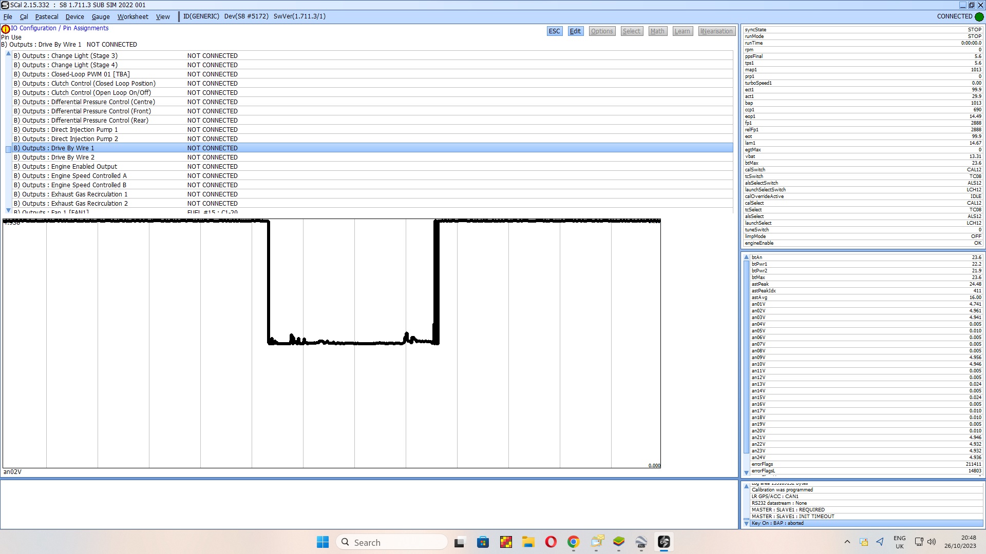

As said before, either short the two sensor wires together and see what AN02V does on the trace, or apply 5v to the signal wire. DO NOT apply 5v to the sensor ground wire.
That will at least prove continuity of wiring to the ecu.
Sitting open circuit it will be close to 5v on AN02V.
If you short the two together, it will drop to around 2.5v on the trace. This will prove your wiring is intact, and of course that the ecu input is working too.
I've just done it sitting on a bench test here on an S8. That's with AN02 configured as bipolar as it would be for a VR sensor as your trace appears to be

Posted: Thu Oct 26, 2023 8:50 pm
voltage high, nothing connected
voltage mid way, the two pints shorted together, AN02 to sensor ground. Then release again
