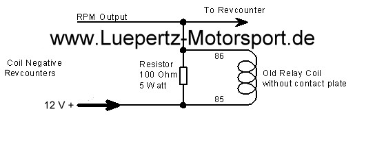

i have done a lot of Toyota MR 2 and Celica conversions from single coil to coil on plug or wasted spark Coil packs.
Most of the older Toyota Rev Counters are Coil negative Rev Counters which may not work with the above connetions because they need a voltage spike rather then a ground signal. My solution is the following circuit, which generates a voltage spike and works in most cases.
If it still does not work some Rev Counter may need a 220Ohm 5Watt Resistor instead.

I now put in a circuit Heinz suggested and I now have close to 4000rpm in idle ;) but at least I have some reaction and I am pretty sure, the rest can be sorted out with adjusting the signal pulses coming from the S6
