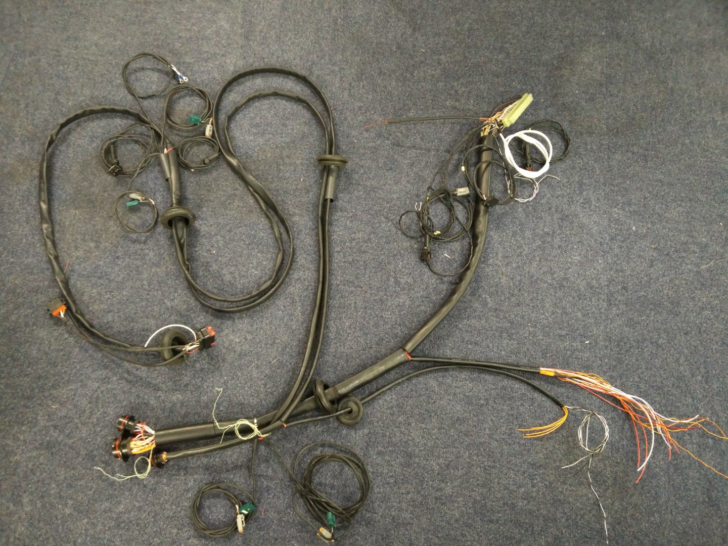

Any recommendations for connectors and any pics that can be shown?
Re: Tools for making Harness'
Posted: Fri Jan 22, 2016 12:55 am
Deutsch Autosport connectors are the ones many (and I) use. Reckon on around £200 for the connector pair though!
Here's a loom I was working in recently with 2x AS bulkhead connectors (before the DR25 was shrunk down, boots put on, etc.)
