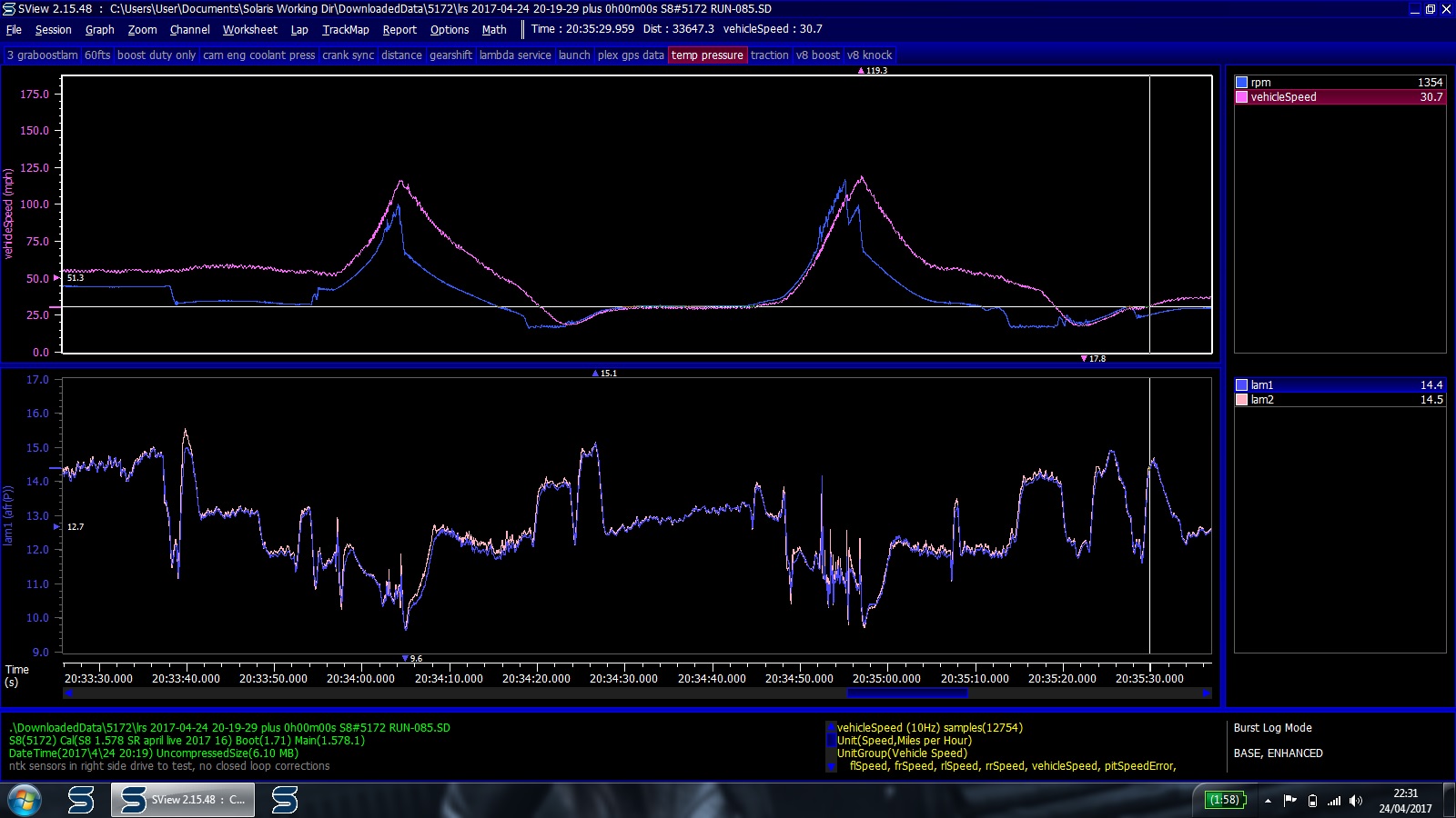

So, after changing to an S8, I have dual lambda ability onboard with the ecu.
I fitted 2 LZA sensors into the same right hand bank of my V8. One is installed vertically into the exhaust stream, the other about 4inches downstream and at an angle. This was simply how I'd installed the lambda bungs for clearance reasons.
Either way, they're in the same pipe and close together. Using the same LZA calibration as supplied.
Are the two perfect at all times ? no, but they're damn close the majority of the time. The log is much longer but here is a snapshot, top graph rpm/speed only and bottom graph LAM1 and 2
Not a lot of point zooming in as the two lines track each other very closely almost the entire time so wanted to show a more long term view. On load graph is erratic due to traction loss/control being active. But it's about 2m30s on screen.
Of course all this shows is that two sensors will read pretty close to the same. One sensor ( LAM2 ) is around 2 years old, LAM1 is brand new today. Are they "accurate" ? I've no idea. I guess it depends what is classed as accurate.
But as said, comparing to similar tests ages ago with the other widebands I have, one with an original L1H1 and another LSU4.9, they all read damn close when placed in the same pipe. I'm not about to weld 4 bungs into one pipe to test them all at once though
