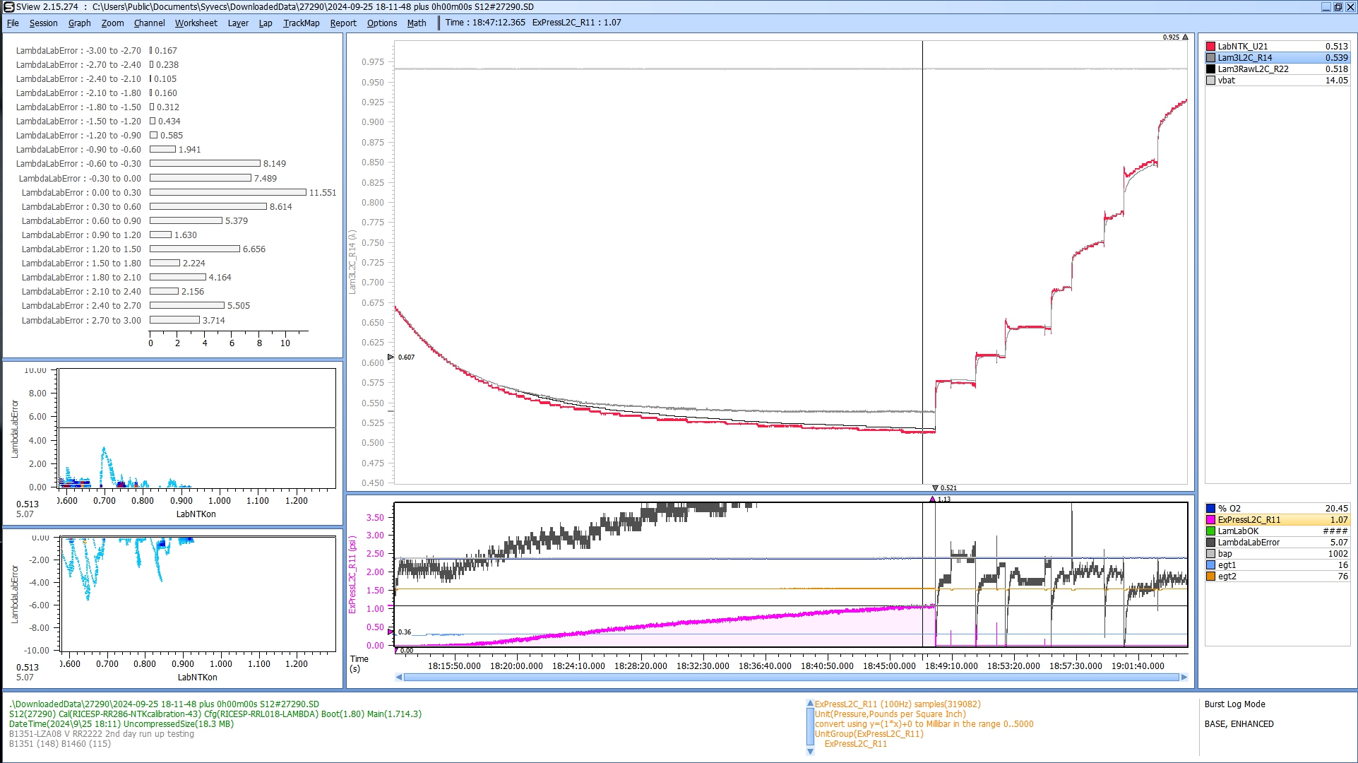

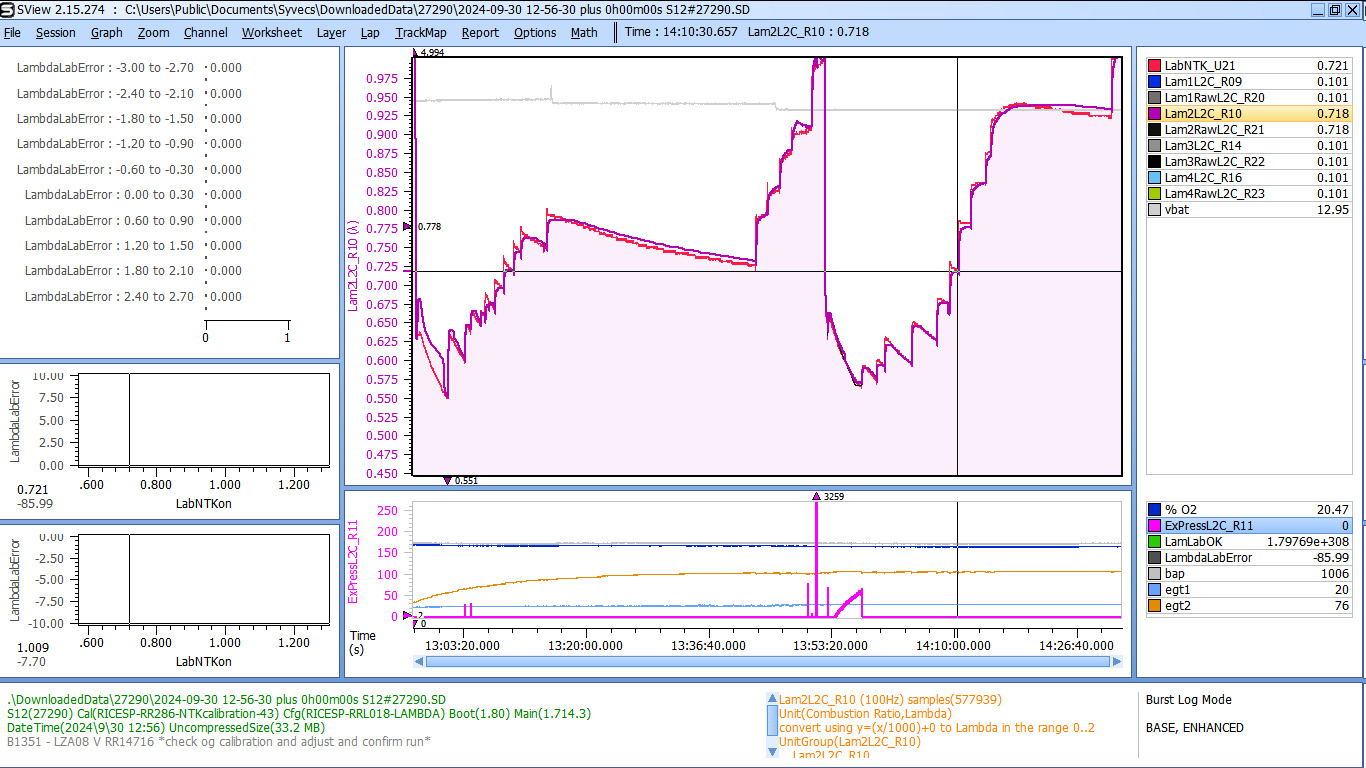

Posted: Mon Sep 30, 2024 1:55 pm
Had a long term use unit shipped back to run up as a check
  • Calibrated 8 years ago
Run up in Syvecs Lambda to Can unit (was originally done in F88), only area that was out was extreme rich end due to changed systems on my end and also changes in firmware allowing much easier calibration of lambda sensors which was rather tedious in a bench setting waaaaaaay back then !
The results are impressive - *DONMEGA FTW*

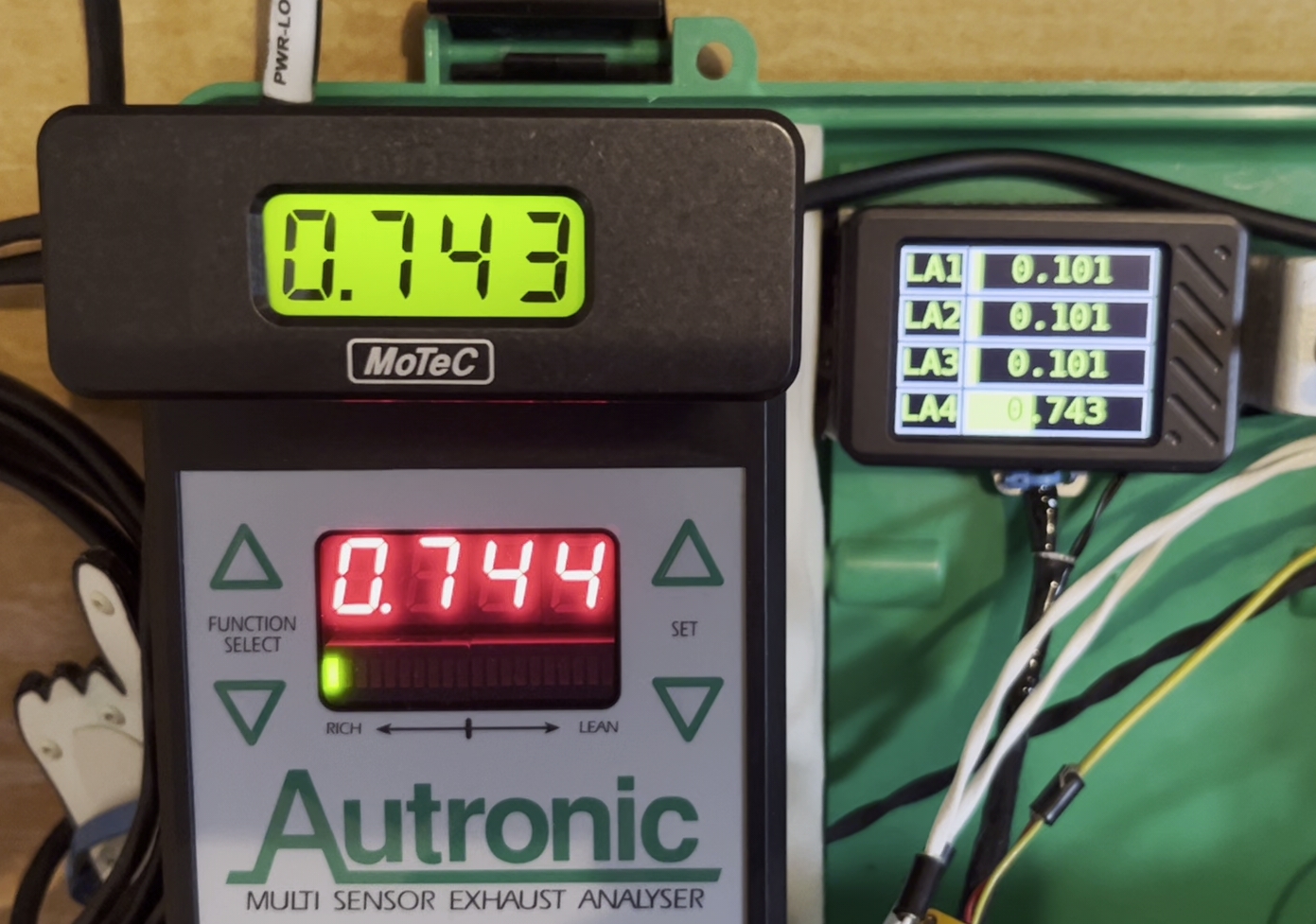

MoWreC PLM, after *donmega calibration*
tested all options and multitude of sensors and full developed for RR spec NTK so is usable for real methanol ranges of use without the dreaded C-6 error of death

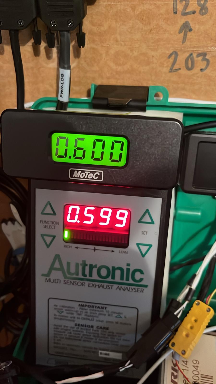

Same has been done on the MoWreC LTC-NTK
applied to RR NTK sensor and usable range down to 0.550 Lambda
again, its no Syvecs Lamba To Can quality of unit and has a raft of issues indicative of 'hobby motorsports' claiming to be professional, BUT I have managed to massage a turd and make it acceptable for the groupies who gag over this brand
