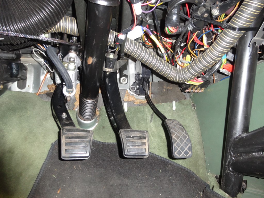

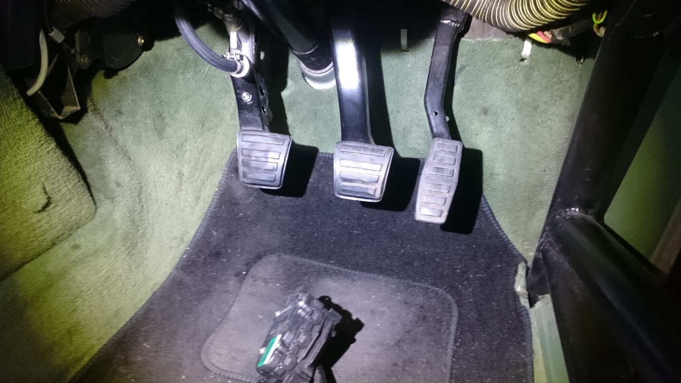

And the Subaru pedal with the metal arm means it's easy to cut/adapt/shape the pedal arm to whatever you want. I used the Subaru base but ended up putting an Audi rubber pedal lower onto it for mine so the pedal looked more appropriate for the car
Before
After
I had bought a complete Audi pedal...but overall it would have been far more difficult to use despite similar mounting arrangements
