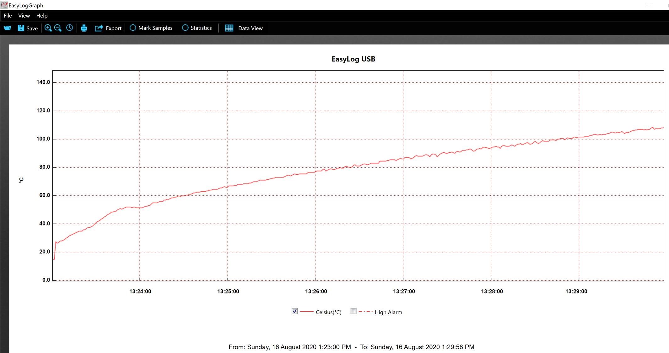

Posted: Wed Aug 19, 2020 1:25 am
by rac
TimH wrote: Tue Apr 21, 2020 11:36 am
rac wrote: Tue Apr 21, 2020 6:46 am I've ordered some thermocouple bits and pieces to log both the egt and the pipe surface temperature at the wideband install location. will be interesting to see what the environment is like at cold start.
Will be very interested in the results of this - please share if you're willing :)
Makes me wonder about enhancing our mini expansion unit (MEU) to make use of the EGT circuitry as part of the LSU control strategy - perhaps using a strap-on sensor to give an indicative reading :ugeek:
so bit of a delay on this one, i was part way through re-wiring the ecu direct to oem harness and then broke my wrist playing futsal. wiring with a cast has been a joy....
anyway regards EGT at wideband location - my widebands are probably as far as they would normally get being a long runner top mounted turbo and the widebands at the base of the downpipe and the rear of the engine bay. so with this distance, running a rich start up from cold and with ~15 deg C ambient the EGT time to 100 deg C was pretty much bang on 6 mins.
the pipe surface temperature actually fell initially and rose after engine shut down (only a few degrees) so one can assume the pipe at this distance heats up very slowly, i didnt bother logging it. I imagine if i repeated this as a hot start, the warm up would be much faster.
