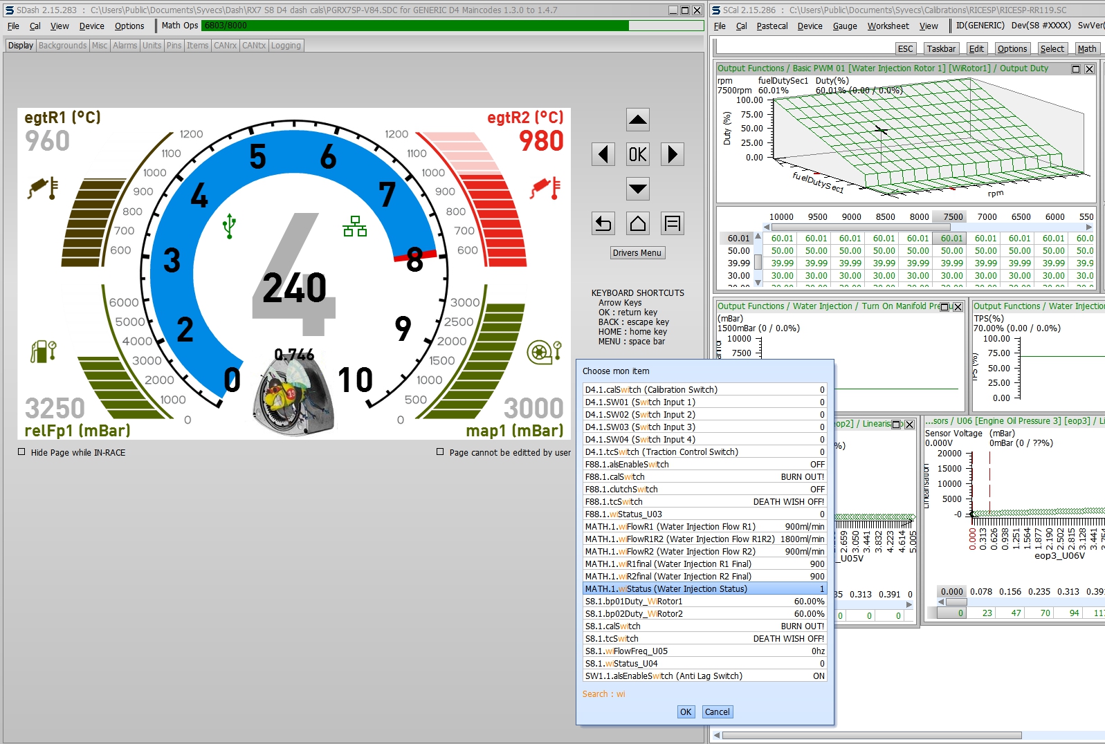

Posted: Mon Aug 10, 2020 1:51 am
Now doing full integration with Dash/ECU, running complete strategies to measure flow/s, status, and per bank or rotor control.
Basics are:
*low flow
*high flow
*differential flow
*Solenoid fault
*Pump fault
Other items to follow....

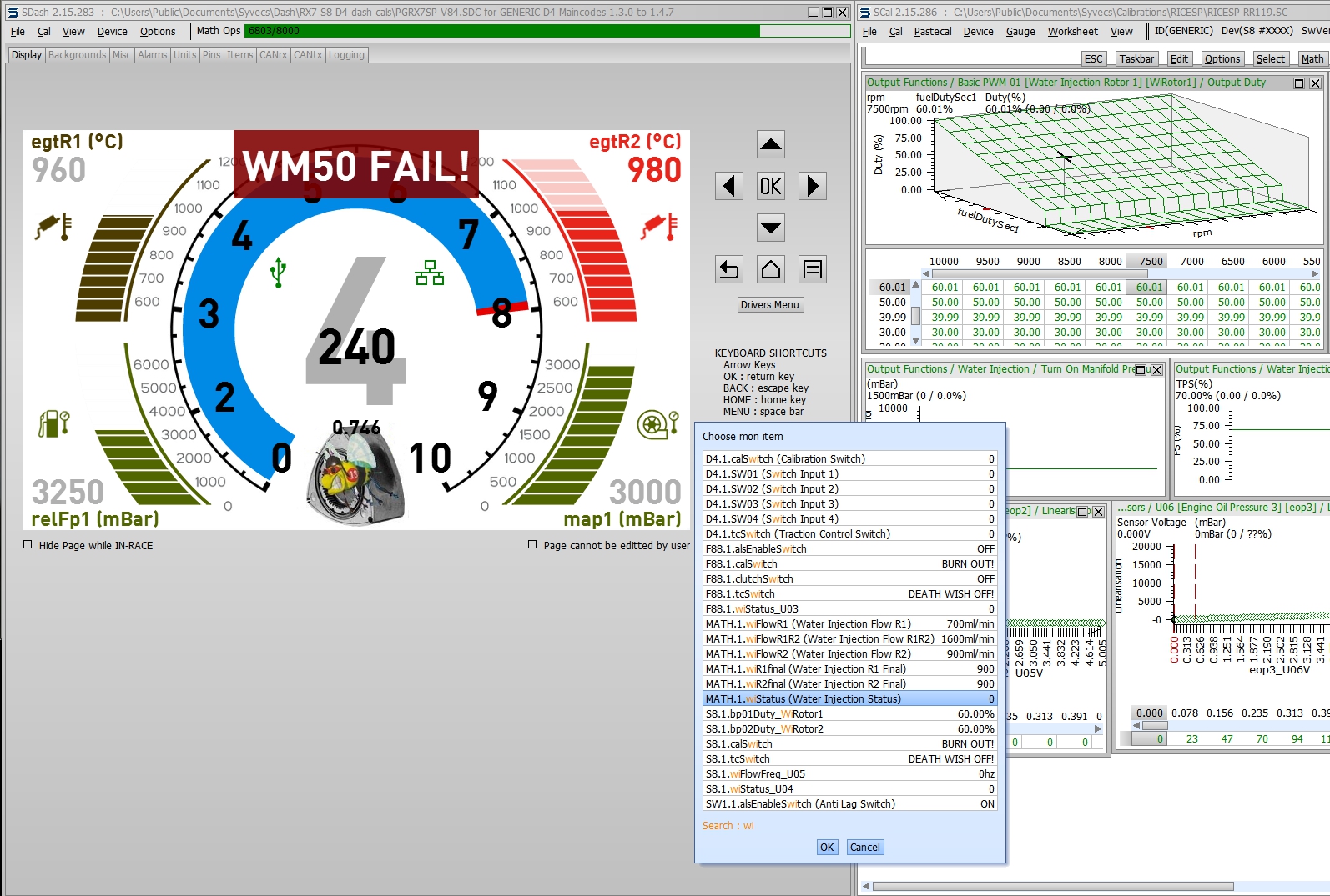

Posted: Mon Aug 10, 2020 8:09 am
Simulation testing the control logic, all works
Maths used is allot more than posted above but hope it helps people interested in doing this.
Final Solution counters all Leak Block or Differential detection limits (Bank 1 Bank 2) or in this case per rotor ;)
