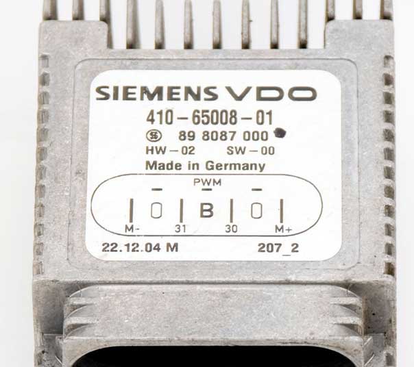

problem sorted, just waiting for it to arrive
100 hz control. 600watt

That looks identical to the GM fan controller.
Some info from one of the guys on LS1Tech ( and other forums, he also listed the part numbers on Amazon too )
ACDelco 15-80803 GM Original Equipment Engine Cooling Fan Module
For anyone that own a C6 Corvette and is in need of a stock fan controller, this product does the job very well. However, there are a lot of people that use this fan controller in custom applications. Any aftermarket EFI system that is able to send a PWM signal can use this fan controller to allow the fan to operate at variable speed based on the temperature of the engine. This is how the C6 Corvette works and it can work for others.
I use a Holley Dominator EFI system and use this fan controller so that my cooling fan operates at low speeds when the engine is barely above acceptable range and then the fan speeds up as temperature rises. This makes for a fan that is quiet as opposed to simply being turned ON/OFF.

PWM Fan Control Module - AC Delco 15-80803
Pinouts
1) Fan (-)
2) Battery (-)
3) Battery (+) fused
4) Fan (+)
6) PWM output from ECM (J3-49)

Still think a decent SSR would do exactly the same...and that's probably all the Siemens unit is (but, crucially, it does have a heatsink!).
Re: Output Current Limits
Posted: Sat Jul 01, 2017 8:43 pm
TimH wrote:Still think a decent SSR would do exactly the same...and that's probably all the Siemens unit is (but, crucially, it does have a heatsink!).
That unit may receive a 100Hz input signal, but fairly sure it will not be outputting a 100Hz signal.
That's probably a key difference

yes, i think it is around 15khz.
inside the unit has alot of capacitors/inductors/diodes etc etc. 3 or 4 big mosfets. when i get it il pop it apart to see.
