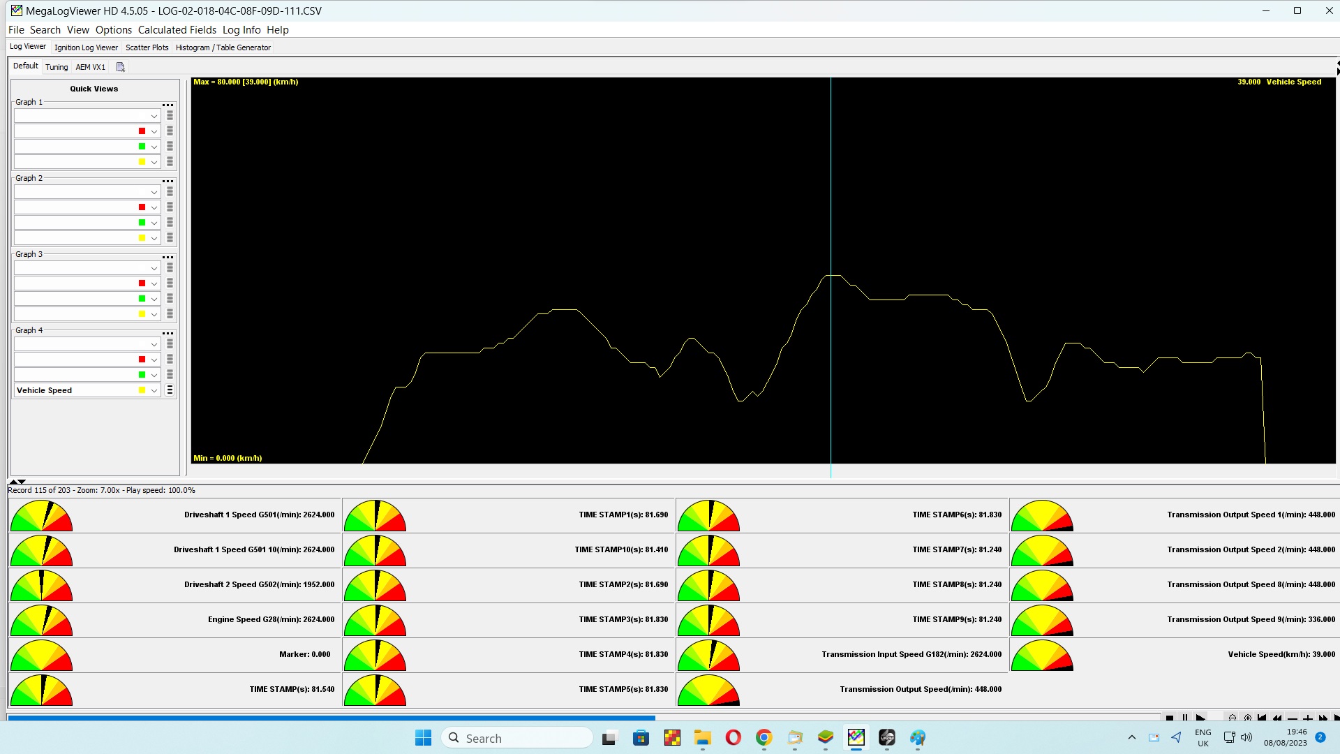

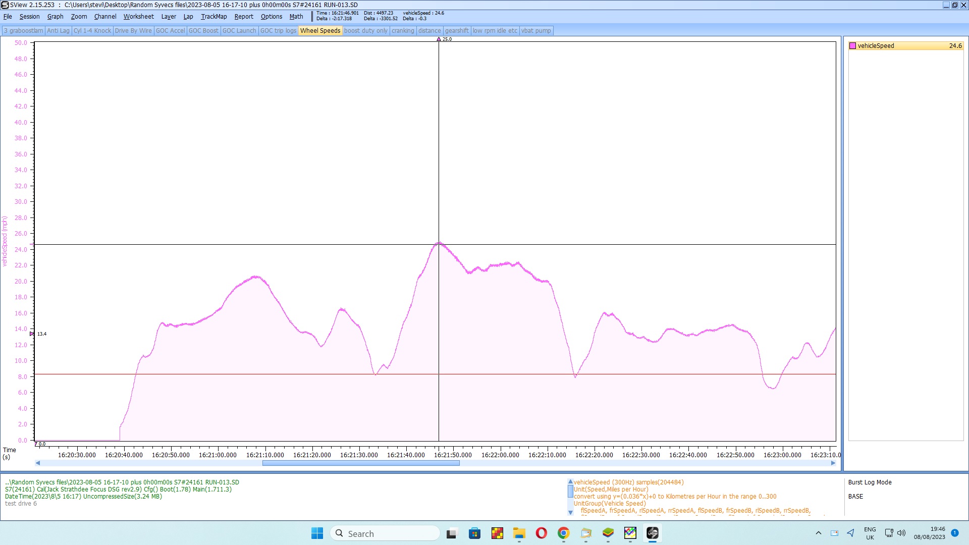

Jackstrath wrote: Tue Aug 08, 2023 6:03 pm Well i dont know if my wheel speed is correct..... I have noticed the tyre circumference is different, iv got 1.5m in there when my 255/35/18 works out to be 1996cm. Iv never looked at it since moving to the S7, on the S6 i only needed it to give me a speedo for road driving nothing else. il need to turn on the racelogic and get the speed off its GPS and cross ref.
On your log, your mph at specific points corresponds to the kph reading from the vcds log.
The short section after the first long stop, you can see both are logging the same thing from the identical shape of the speed trace.
Your fastest speed there ( from memory, didn't open it again ) was around 39kph, 25mph

Or is what you're logging via VCDS...just what it is receiving from the Syvecs in terms of vehicle speed for both ?
Maybe that's why they're the same ? but different.

What’s metalog!? That looks much better than the excel document 🤣
Well that’s what I’m thinking it’s coming from the syvecs. Or as I don’t think Iv been logging the two sensors that are faulting… but I can’t seem to see them in the softwear but il have another look and see what I can see!
Posted: Tue Aug 08, 2023 8:28 pm
Megalog viewer, derived from Megasquirt etc but it's a pretty good generic datalog viewer for all sorts of files.
Not as good as SView for Syvecs files. But SView is a nightmare to import .csv files or other types of log files
MLV is dead handy in that regard
https://www.efianalytics.com/MegaLogViewer/

Cheers steve, downloaded the free one and played about with it, took a second to figure out how to get the names of the sensors in the right place but figured it out.
