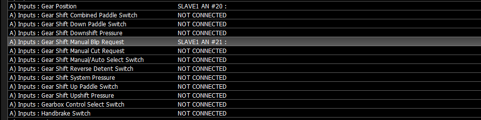

I think i might of just found it, decided to go looking through the other calibration i had double checking everything and boom I didnt have pin Gear shift manual blip request assigned.....
Honestly a bit of a how to from beek would of been nice, i just so happened to ask them for all the inputs from CAN that i could use and they emailed me a list:
FLSPEED_SLOT //Slave an13
FRSPEED_SLOT //Slave an14
RLSPEED_SLOT //Slave an15
RRSPEED_SLOT //Slave an16
LATG_SLOT //Slave an17
SHIFTER_SLOT //Slave an18
BRAKEP_SLOT //Slave an19
GEAR_SLOT //Slave an20
BLIP_SLOT //Slave an21
ACREQ_SLOT //Slave an22
LIMP_SLOT //Slave an23
TRQLIM_SLOT //Slave an24
GEARCUT_SLOT //Slave an25
REVERSE_SLOT //Slave an26
CLUTCHA_SLOT //Slave an27
CLUTCHB_SLOT //Slave an28
But had i not asked i would of never got!
Jackstrath
- Posts: 160
- gearcutg.jpg (184.45 KiB) Viewed 54412 times
- Posts: 1413
blip is assigned ? but cut not ?
Jackstrath
- Posts: 160
No i didnt have it assigned as i didnt think i had to... This was all i got from them origanally... small mirical its worked as well as it has so far! Thanks to you, Craig from DSG south africa and Gaz from GR

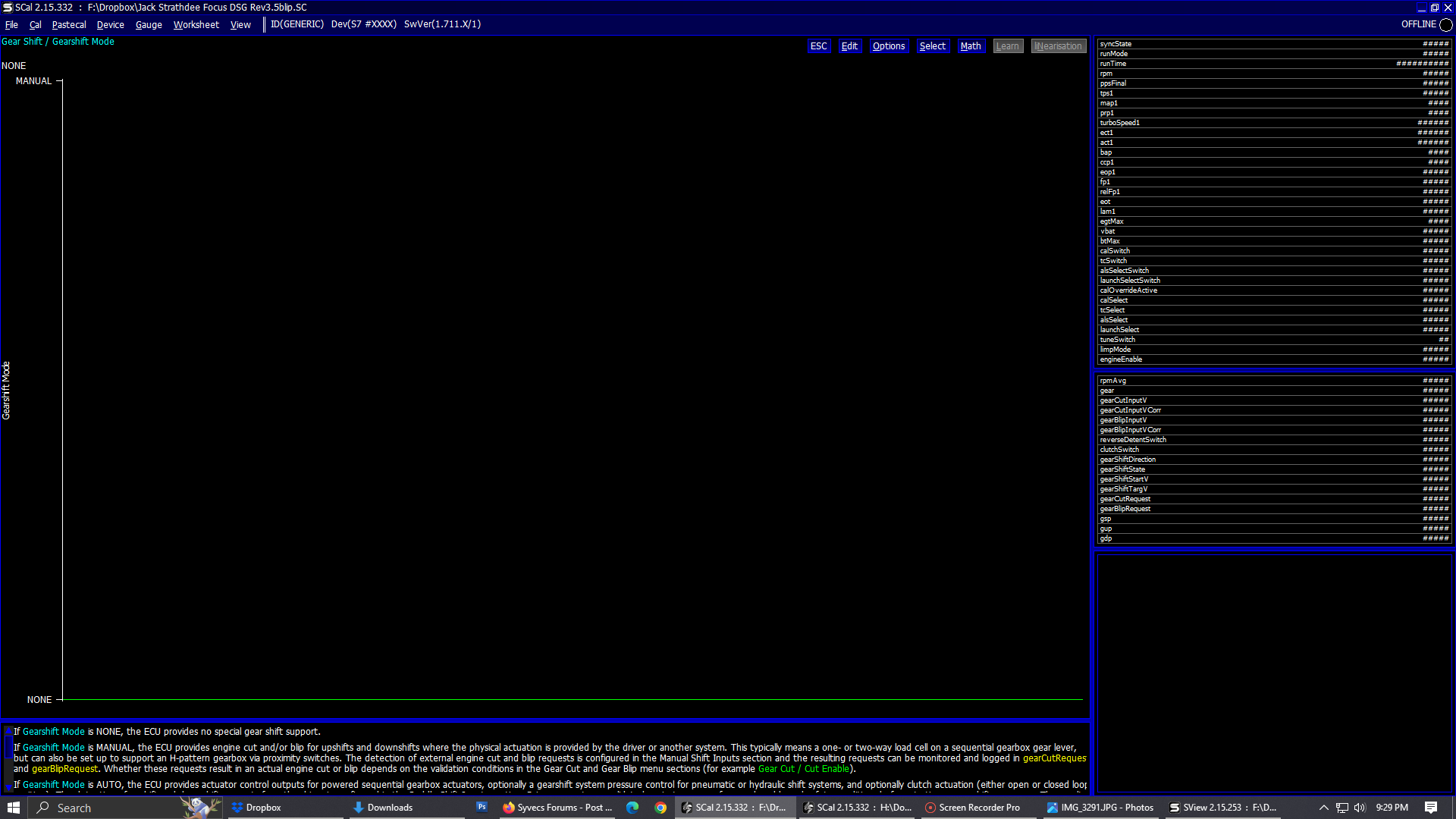

Soooo i have been having a good look about in the Cal again and my Gearshift mode is set to NONE..... Could this be the reason.....
- gearmode.png (127.09 KiB) Viewed 54383 times
- Posts: 1413
I never said gear cut.
I stated you need to, log the reasons for the torque reductions.
