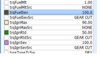

without knowing what the slave inputs are used for, they'd mean nothing to me.
As stated multiple times, log the reasons for the torque reductions..
ie.
syvecs trqsvrc.jpg (29.55 KiB) Viewed 50214 times

Il hopefully get the car out this weekend Stevie, is the screenshot you have attached what I should be looking to set up and log?
Posted: Thu Mar 21, 2024 8:35 pm
log all the sevsrc parameters and it will tell what reduction is active.
Again, no idea how their coding works for the box, but that should identify why any torque reductions are happening
