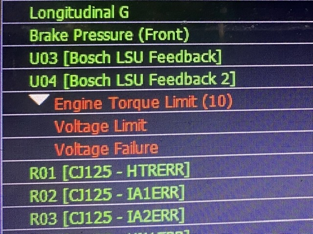

I have entered the correct data with the assistance of teamviewer and LMS. Unfortunately the car has the same issue. :(
I contacted the tuner that I was going to have tune the car, they have stated they will not tune the car do to me building it and also not buying the Syvecs from them. Believe it or not, this was devastating to hear, they are the best of the best, and so is the car. Now I’m lost at who to have tune it, if I had time I’d just take a training course. :(
I have tuned many cars over the years with different systems. I built a beta test car for Frankenturbo using Eurodyne, nascar based street engine using Accel, and tons of cars with including a 1000hp car in Hotrod magazine.
However, this software is NOT user friendly at all. I am very disappointed right now, I am lost as to the functionality of this at this point.
Part of the issue is that I am forced to work a high amount of hours, and right now being a nurse is taking up all my time. I have minimal time to learn this software, so I’d rather pay to have local tuning help. I cant find any.
Another issue is the massive lack of support because it’s a Porsche, and because it’s automatic. It’s just an engine, same as any other engine. Lol
Thanks for your help. I’m trying to figure this out in my spare time.
The car runs, but not driveable on a stock startup file. Obviously I need to rid the error message. How do I figure out what signal on what pinout the Syvecs is looking for that is tripping the error messages? If I can find that out I can fix the issue as long as its not software related.

And I will repeat yet again....
The info it needs will be transmitted via CAN. It is not a case of just 1 pin. It's data, not a simple raw voltage signal. If the CAN wiring was not correct, you'd be getting a load of errors
Presumably you are in the US, there are quite a few tuners in the US who would be competent with Syvecs as it's very common on GTR's, Lambos and Porsche, BMW as well as the VW stuff.
As Code 01 and 02 seem to be reversed, did you try inputting the numnbers as per instructions in the 01/02 sections ? rather than the naming of them in the file you posted ?
You can change the name easily if you need to, although it is just a name, as doesnt have any actual impact.

Yes, the car coding is per the manual, even though it doesn’t make sense as to how the software labels it for 01 and 02. Did not try reversing them.
Still getting the trans limp mode message on dash, even with KOEO. Also still have the same “Engine torque limit” error message on Syvecs. Based on this error message also saying “voltage limit” and “voltage failure”, it must not be receiving an input signal either from a pinout/connection issue, or a software setting. I need to email Syvecs and find out what trips that message. Wish I could get an actual normal engine code for this error, I’d have it figured out already.

Nitrorocket wrote: Sun Mar 29, 2020 4:07 pm Yes, the car coding is per the manual, even though it doesn’t make sense as to how the software labels it for 01 and 02. Did not try reversing them.
I would try putting the numbers in as per the named fields for Coding 01 and 02 then, even if it isnt quite "correct" as per the manual.
Any lack of signal relating to that item...will cause the trip. A generic OBD code would do nothing regardless because that is not how CAN works.
