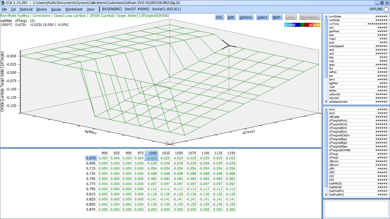

Posted: Sun Jun 07, 2020 4:18 pm
Grabla66 wrote: Sun Jun 07, 2020 3:53 pm Cheers. Just found there is a target adder f(egt1) in Run Mode Fuelling / Corrections / Closed Loop Lambda which is set to 0 for all breakpoints. (I'll not be changing that)
That is a really basic function table, its better when you do your own CM map as in one customers car below, running KT8 and just one of the tables used. This is doing what you are asking about, allowing maximum engine performance up to a certain EGT limit then cooling the engine in this case to keep knock under control as an example. EGT max is useful here for obvious reasons.
