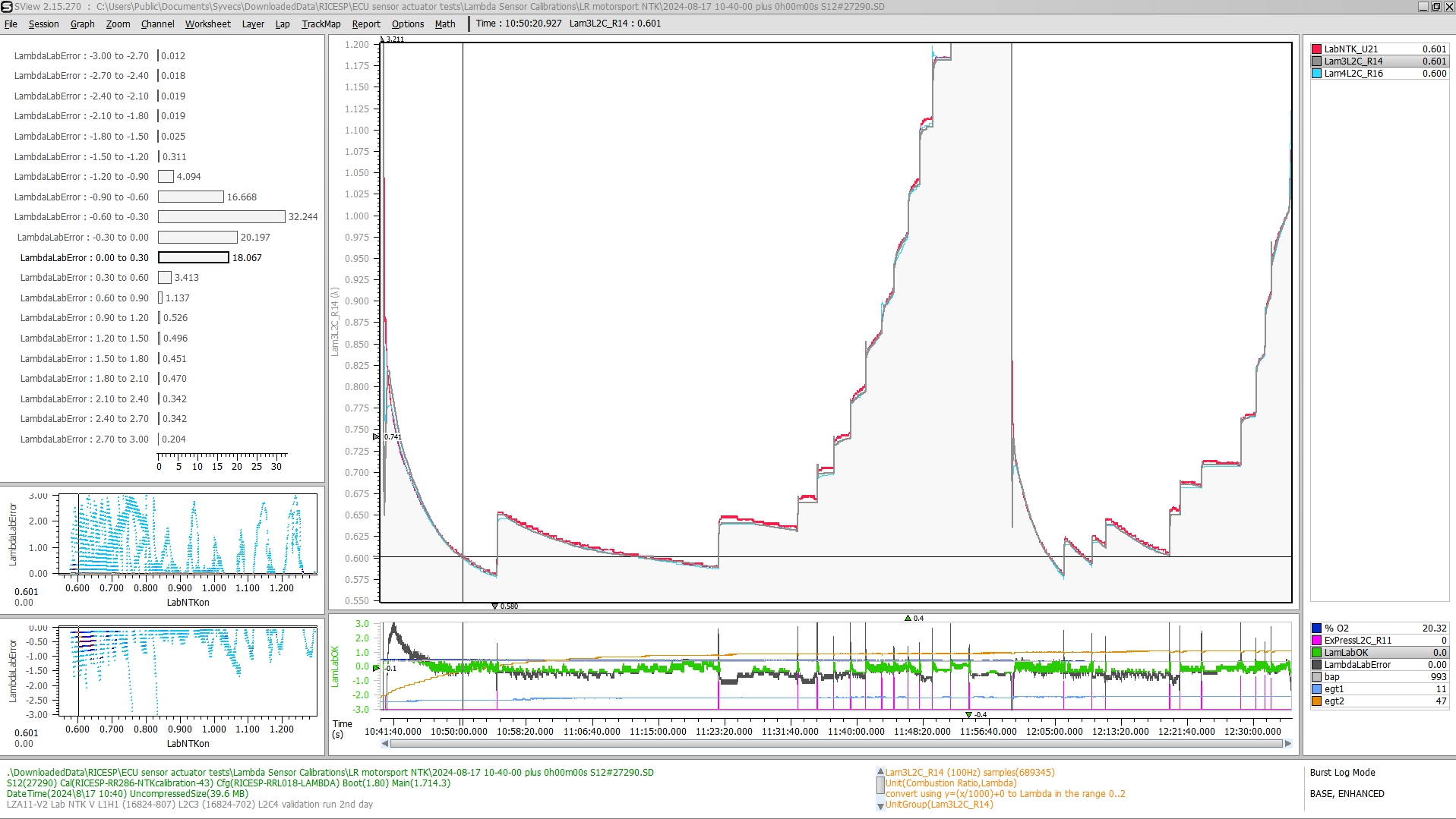

Here is better view just showing the said sensors (RR calibrated), I always recheck all sensors a following day as validation of calibration curves (bespoke to each sensor)
  • reference meter
  • 1st LR motorsport NTK
  • 2nd LR motorsport NTK
There is no difference if the supplied calibration curve is put into one of our Lambda to Can 8 channel units (in this log) or previously shown into any LR /Syvecs ECU, its been tested across multiple S8's-S12's-S7's-S6's for 10 years now, they are spot on ;)

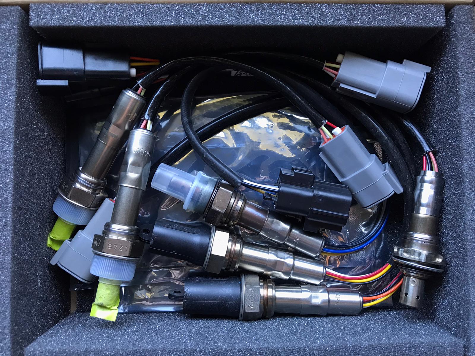

Small selection of RR test NTK's
Literally hundreds of hours of testing, many more multiples of these hours out in field, across all applications you can imagine.
GET ON IT !
p.s. For the 100% meth addicts out there I have not forgot about you, is coming !

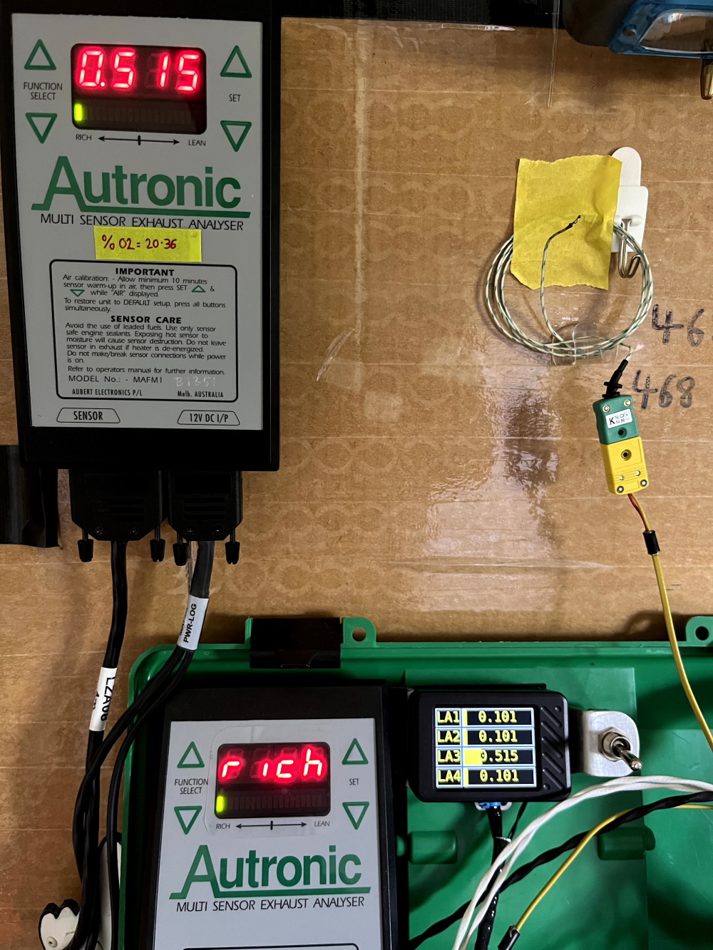

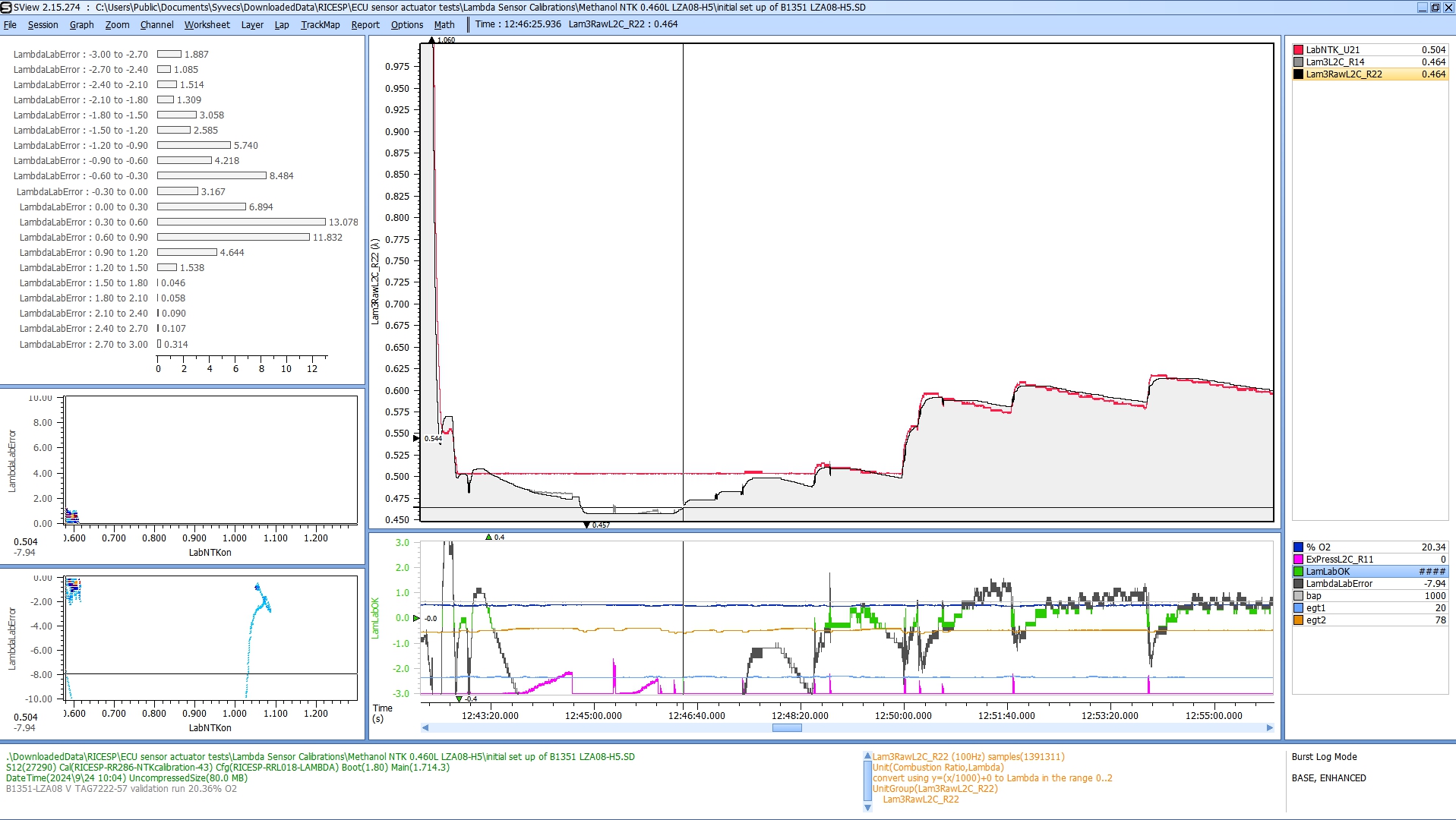

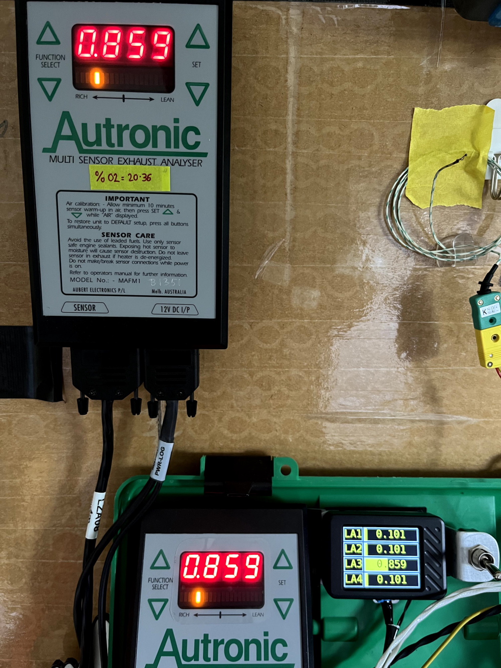

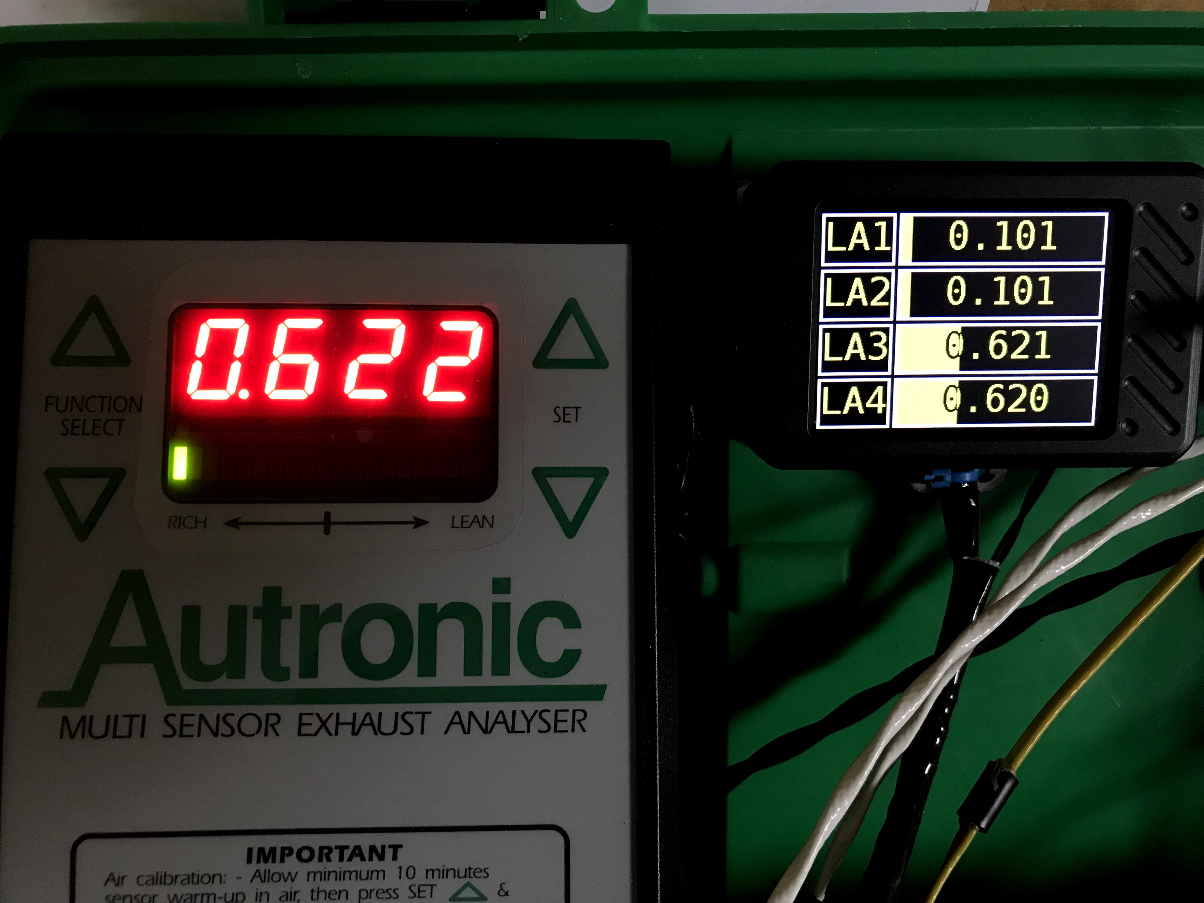

Here you go.
Shows how good the L2C really is, not to mention the Autronic EGA I call against, same cant be said for others which have run back to back.
One meter is specifically set up for methanol and unlike the pretenders this is an actual reading for mixture not an inferred one! thus has none of the stupid errors that don't add up to any reality when checking mass of air and fuel.
We guarantee this down to 0.500L and the final part is extrapolated in the L2C down to the sensor actual rich limit ability, if you have to run more than this then you are not going to ever have a true reading of mixture, let alone a functioning engine of any note.
Unlike the pretenders we run these engines and have proven them and tested all the market offerings (some claimed leaders) the disparities and claims to greatness and inference of 'setting the benchmark std to which all others are judged' is nothing more than a certified joke at best and outright lies at worst. I have even seen funny things where its obvious some brands have obviously copied the 'wrong' reference std point for point :roll:

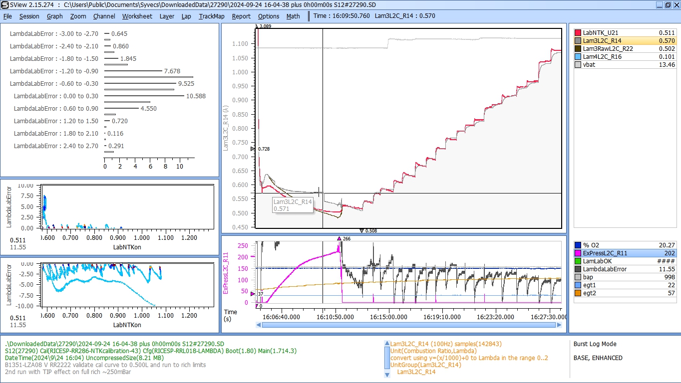

This shows how small amounts of TIP skew actual mixture readings when run at this point on methanol race engines, again another reason why you want RR sensors and actual race experience applied and proven

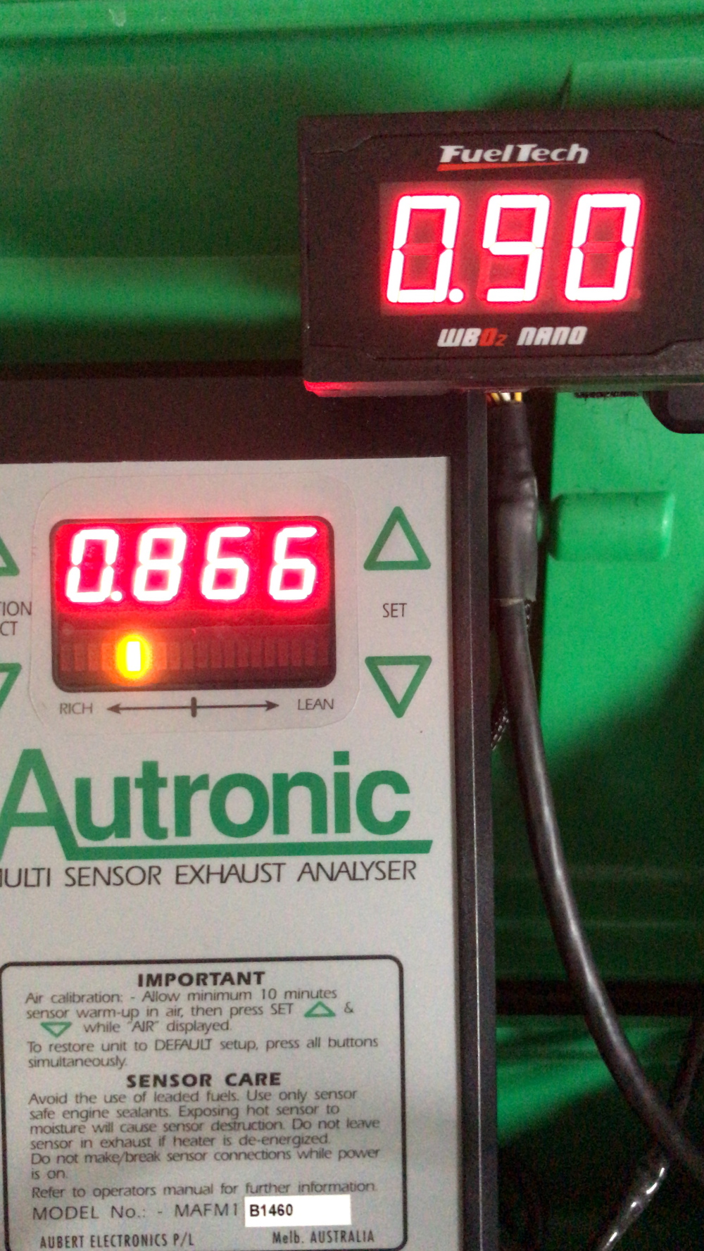

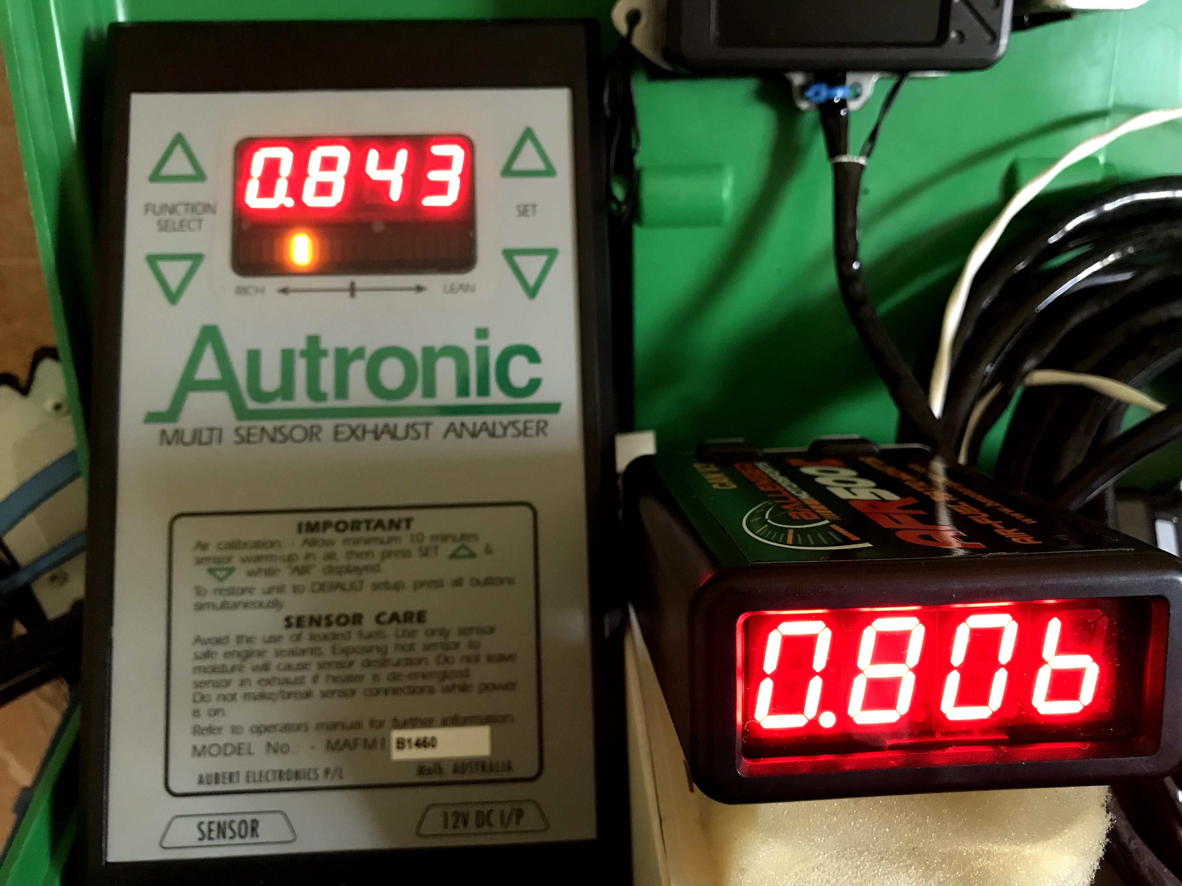

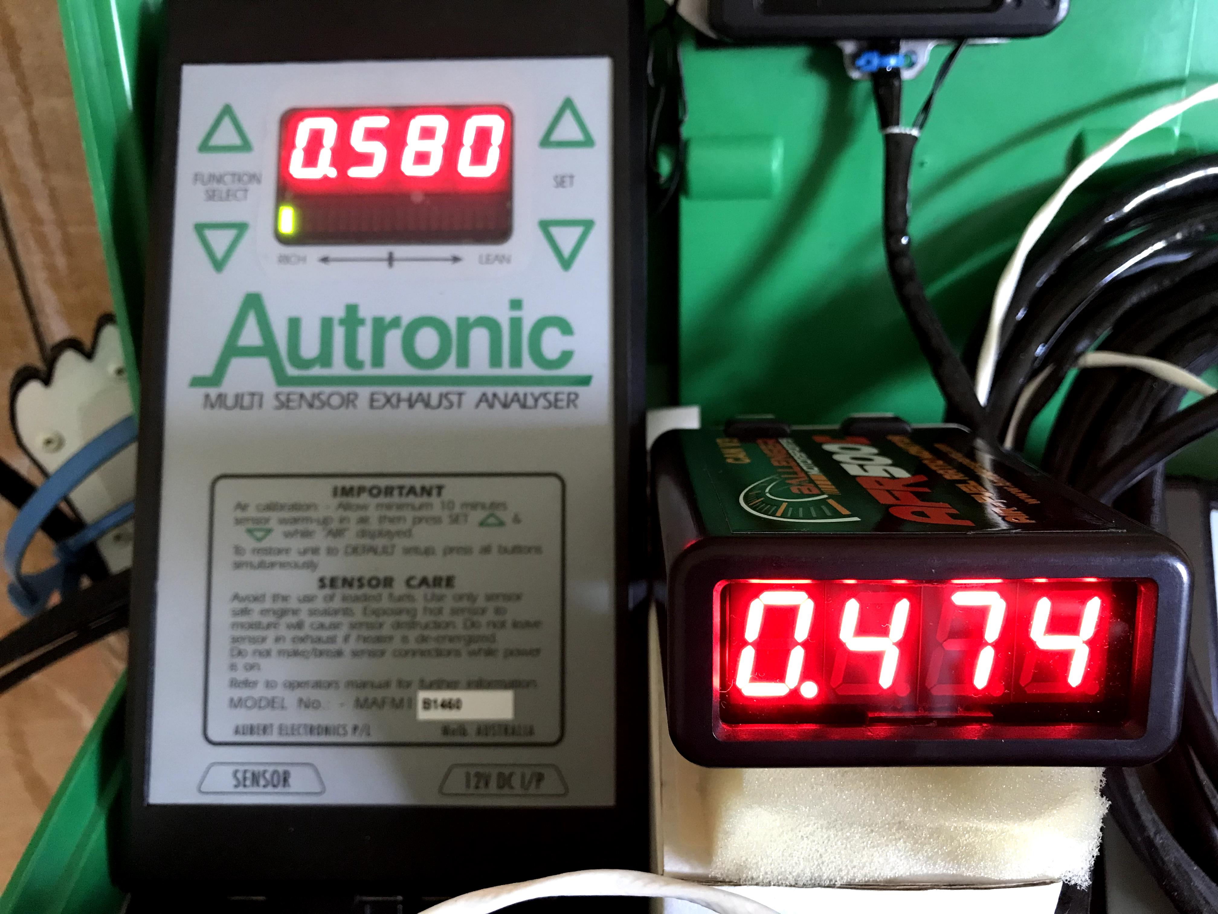

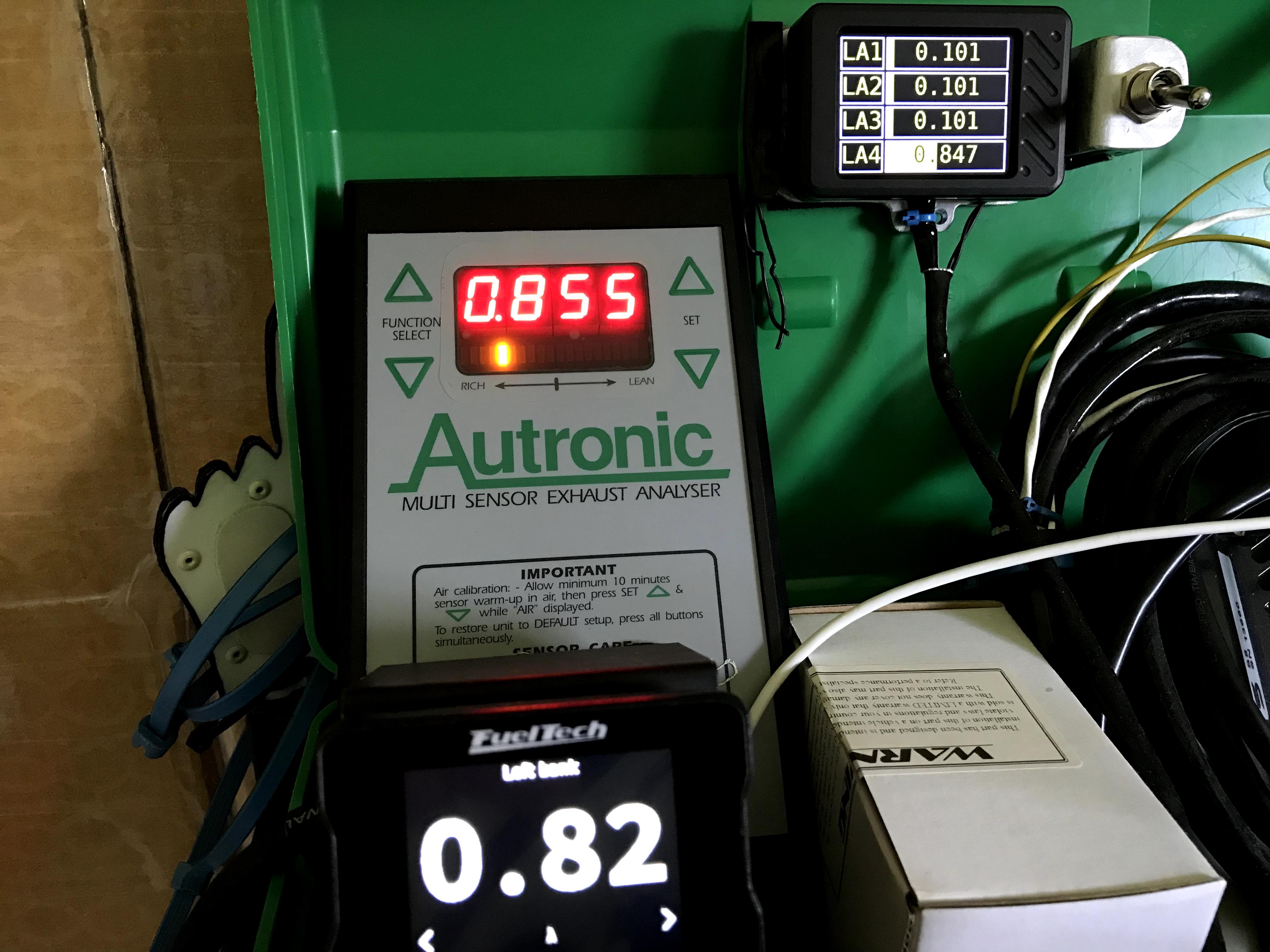

Here is but a simple example:
LSU AIDZ
NTK 'LEB GRADE' AIDZ
NTK 'KALIBRATION GRADE CLAIMED BEST MAKER ON EARTH' AIDZ
This is a common 'power setting' of ~0.85L where honestly any piece of shit meter should be able to work, keep in mind one of these is 'high dollar' Leb Grade NTK and claimed best unit on market as used by racers for racers bullshit advertising.
Also of note I have had many many times teams send me multiple such items (not picking on any brand in particular) and same unit same harness same sensor and the dog shit units cannot agree on a number, pick a number any number !
No wonder cunts blow up on a regular basis and many seasoned people say and I quote ' we don't trust the lambda readings' :lol:

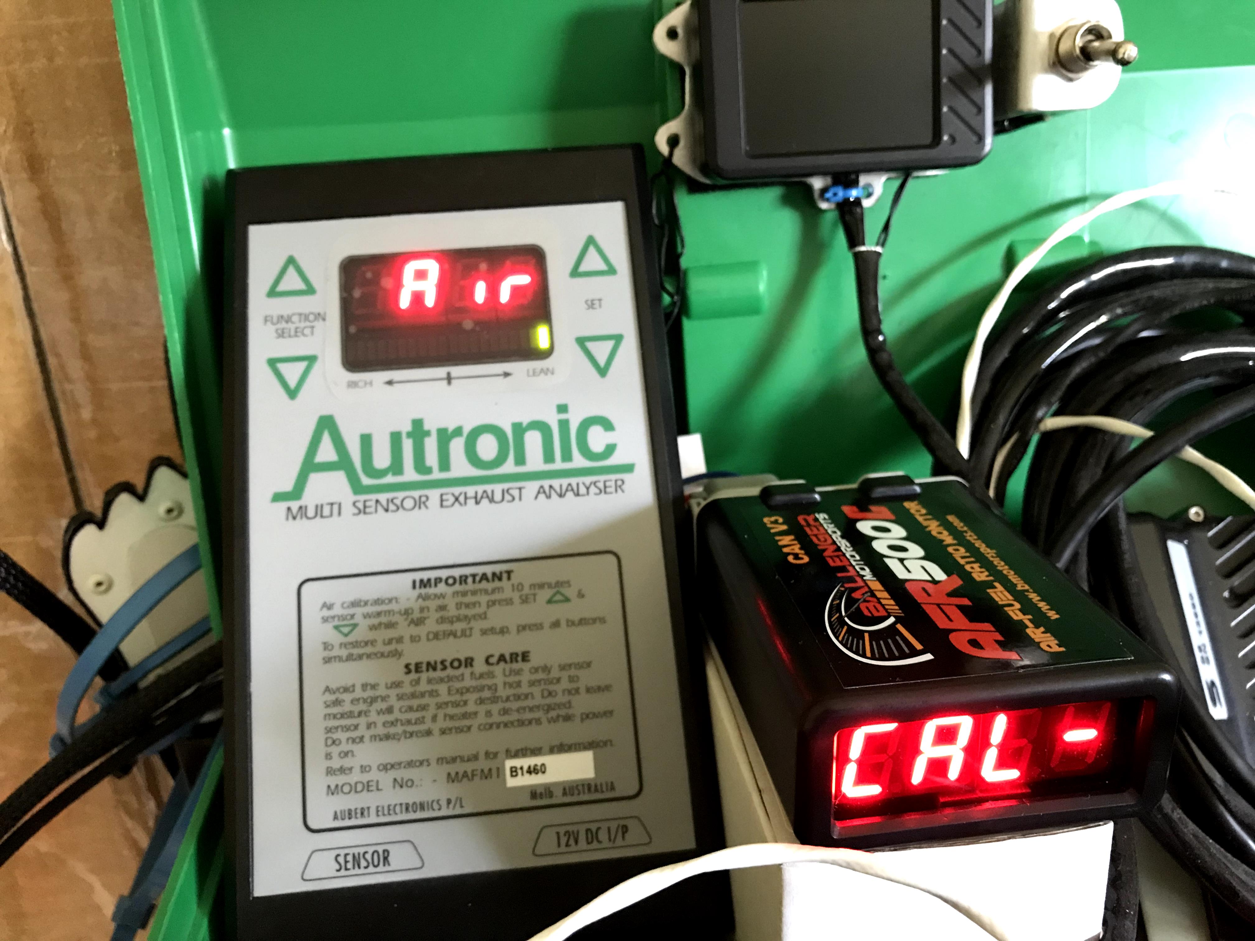

some more aidz
