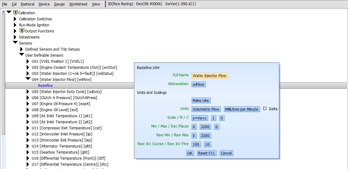

I have to measure on my tfsi the exhaust gas pressure. However, nothing is configured in front of "sensors".
Can I invent a "sensor" myself and enter the name? with characteristic line etc.

Yes :)
See below.
example of user defined sensor

i only see these options the calibrate the sensor ....

Type
V (view)
C (customizing options)
You will then see the table I posted,under sensors, user definable sensors.

Thank yoou for your help guys, now it working fine=)
