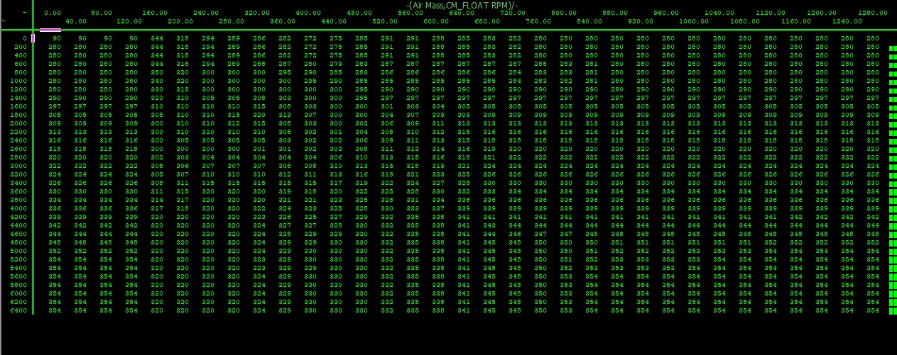

I made direct injection end angle values that injection occur at middle of the intake stroke. It works but I would like to hear some suggestions about that.

This is from a ~2016 Vauxhall Astra VxR ECU, which runs the A20NFT / LHU direct injected 2.0 turbo engine.
Injection angle.jpg (357.37 KiB) Viewed 9987 times
I believe that this ecu is set up with the angle as "Start of Injection", rather than end as you would generally use with port injection.
The numbers in the table I believe are crank degrees before TDC firing. The Y axis is RPM and the X axis is air mass per cycle / load.
There is a big "I think" included with all of that!
Hopefully of some use to you, it was a colleague that did the digging to find it, I can ask further questions if required.
Would love to see / read more information on this engine, I didn't realise the Swindon motor was based on the GM unit.

Thanks a lot. This will help.
It is start injection angle BTDC and as I can see it is also in the intake stroke.
