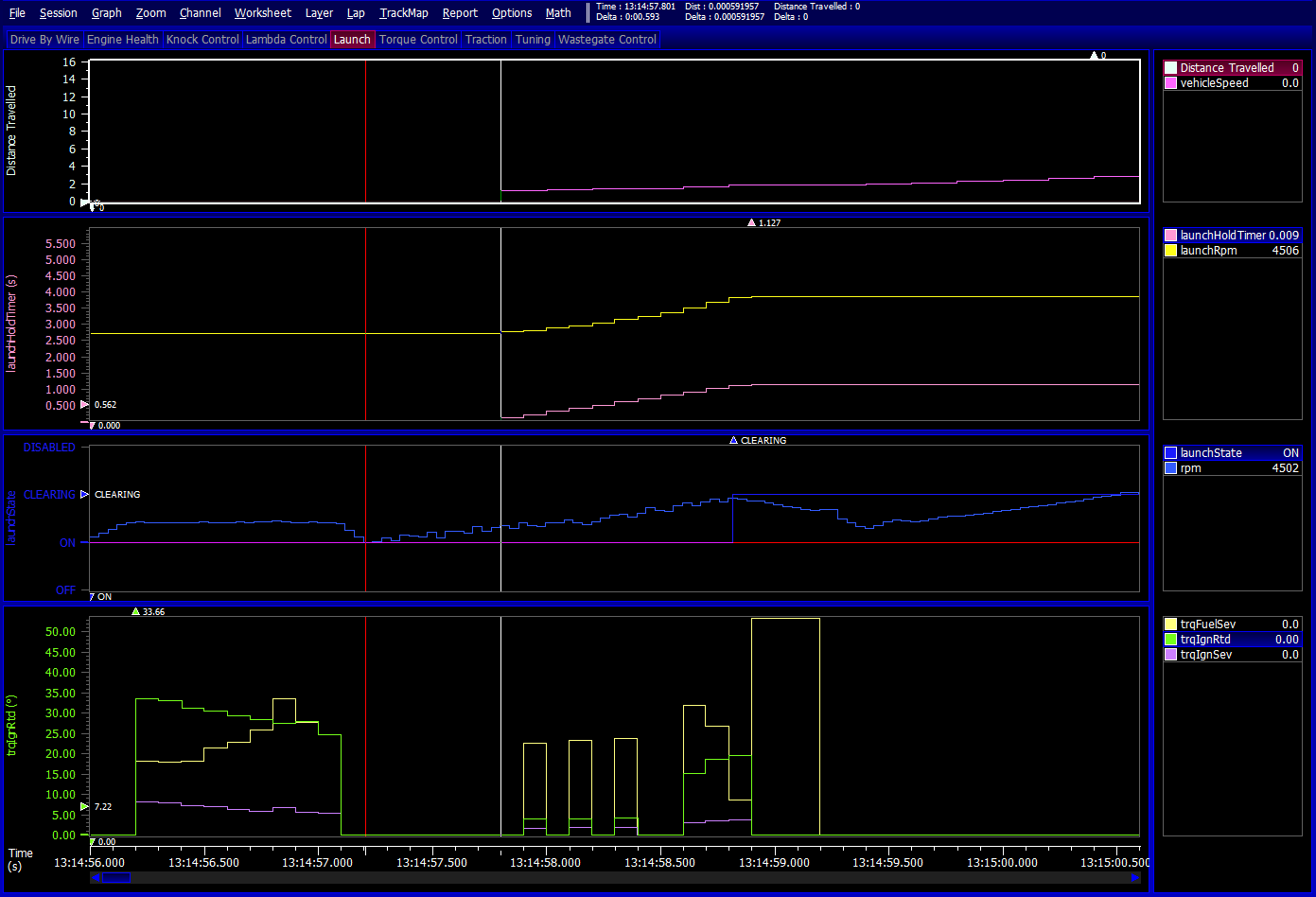

You can see all this happen in the screenshot of your log below
Since 2014 Syvecs firmware has improved massively in this regard, and I've improved what I do with it too. With your car we still have the problem of it being 4wd and spinning all 4 wheels, so the launch hold time is the way to go (with Syvecs). I would recommend you look at updating the firmware to add the Stage and Launch individual phases, and I would also work on using more retard and less cut. You're cut tables already do this to an extent but with more tuning it can be improved.
Looking at some more of your original logs, we could speed up the vehicle speed logging to test, but on launch it pops up immediately to about 20km/h so you could raise the 1.6km/h exit thresholds to a more normal 10km/h. This means that if you creep in staging while launch is active (unlikely on in a sprint/hc event) you don't trigger the launch hold timer.
