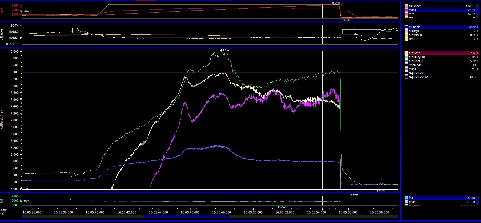

On 1.2 bar boost rail pressure is stable on full throttle. On 1.4 bar boost it goes down then injector duty cycle goes to 100% and then rail pressure goes back to target. I can not find why so help needed.

There's nothing on that graph to get any help.
Proper log is needed, vehicle details, and ensure you're logging what all the fuel controls are actually doing relating to pump/pressure etc. Both high and low pressure.

Attached you may find log I have. I will make new log with all controls logged. I did not logged all for hi pressure.
Vehicle is RML Cruze WTCC from 2011 season. Engine is Swindon BTCC. ECU is custom Life Racing with standard firmware.

You seem to be loading up a pretty cold engine there ?
And I dont really see any fuel controls that might give any indication of whether there is a problem as such. FP1 I can only presume is the low pressure side and is remaining pretty static, which would suggest it is ok.
AFR's are fairly stable and close to target throughout though.

I told the driver to warm it up properly next time. Problem is that when we start dyno fans all temperatures go down very quickly on light load.
FP1 is low fuel pressure.
We will try again in two days. I will play with hi pressure fuel pump controls and log everything. Problem is that I can't find any difference between 1.2 bar MAP when everything is fine and 1.4 bar MAP where problem starts. There is no significant rise in fuel flow from 1.2 to 1.4 bar MAP and hi pressure target is same. Maybe there somewhere is limit for current hi pressure fuel pump control settings. I am not sure about some settings there. Control valve hold angle is 45 degrees on all RPM. Should I try to put higher values on higher RPM? Also Base Load Duty Multiplier is 0.5. This seems to be low.

But there are no big changes in the base tables.....but cumulatively, there are small changes and the end result does follow to a degree.
This is pushing graph scaling a little, but you can see in that area, map, fuel base, fuel final and injector duty....do follow the same patterns as do AFR's get ever so slightly richer at those same areas.
As said, your setup may just be quite sensitive to very small changes in that area. It isnt to say there isnt a problem elsewhere, but it may just need a little fine tuning.
But again, there is no info there relating to high pressure...so impossible to say whether there is an issue there.
