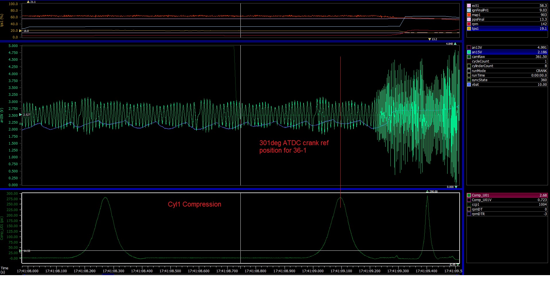

Timing references are setup after TDC in Scal, so factor that in. Some ecu's do seem fussy about where the gap is etc, but have never heard any Syvecs info to say it's a concern.
36-2 is becoming more popular where the gap becomes more defined though.
This is mine for a visual reference, 36-1, with the DTA this had a tooth ref of 67 deg BTDC for the first full tooth after the gap.
Same setup on my Syvecs I have it around 301.5degATDC, using the second tooth after the gap as the reference.
As graph shows, cyl1 compression is on the bottom graph to show you where TDC occurs, relative to tooth count. If we could overlay a 720 graph on View...would could examine the various events much easier. But we cant lol ( and I've asked )
crank ref syvecs.jpg (400.25 KiB) Viewed 28704 times

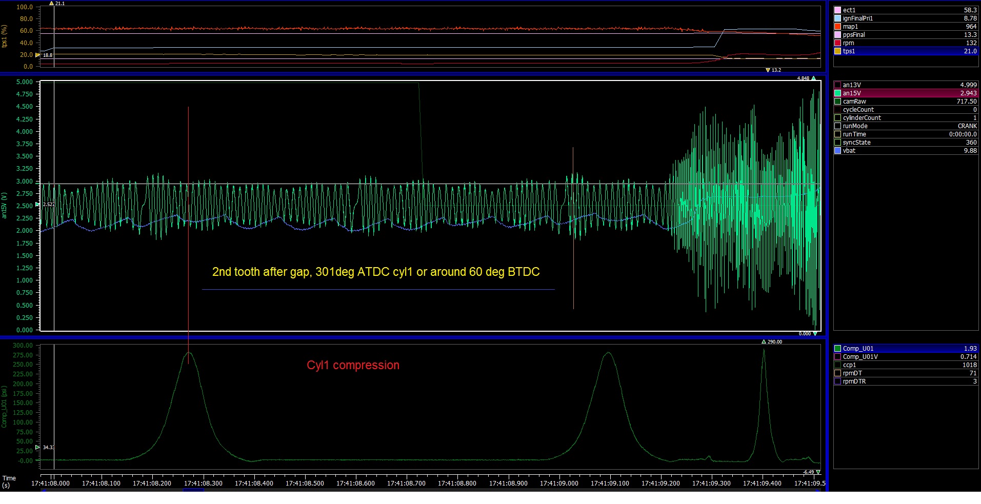

edit, notations on my first pic pic probably didnt make so much sense, so have amended it here
crank ref syvecs2.jpg (410.17 KiB) Viewed 28703 times
