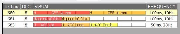

I'm looking for the can bus details.
So what the frame IDs, and payloads are for all the GPS and g values.
Any help is appreciated

I have another device which I can confgure to output CAN frames, I would need to know the frame IDs to use and how to populate the payload.
So yes, I want to try and use a third party device if possible.

Posted: Sat Sep 14, 2019 12:10 am
From the Plex config
plex syvecs can.jpg (29.46 KiB) Viewed 26166 times

by MikeyB571
Thanks Tim,
That's exactly what I need :)
