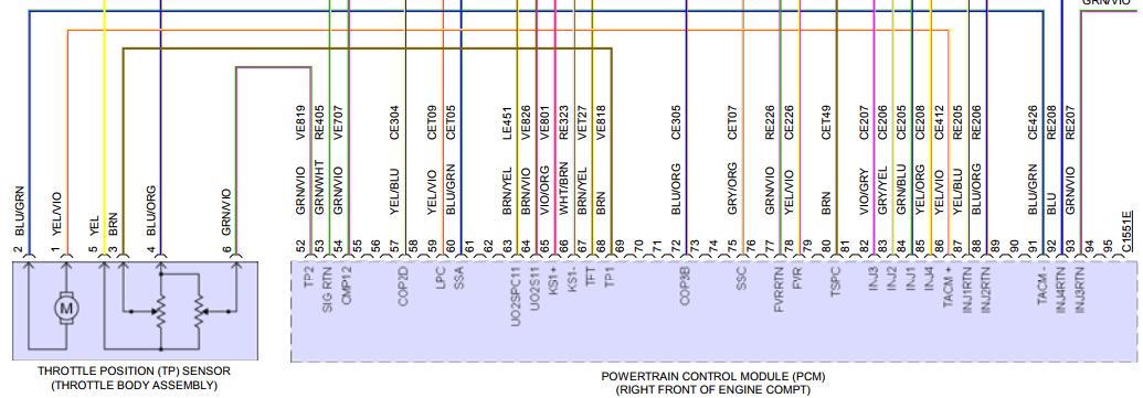

The two H-bridge outputs should be enough to control the DBW throttle, below is the factory ford schematics

Isn't the common practice to have two half-bridge outputs designated for DBW control, thus making a full-bridge?
H-BRIDGE #03 / DBW MOTOR +
H-BRIDGE #04 / DBW MOTOR -

The normal way of driving the DBW though from say an S8, IS with two of those outputs, even if only one is specifically assigned.
ie, +ve to HBridge 01, and -ve to Hbridge02 assigned as full bridge.
Or for a positive 12v PWM trigger to something instead of lo-side ( in my case this is a time delay relay that needs a 12v trigger ), I have this wired to HBridge03, and nothing to Hbridge04, again configured as full bridge.
