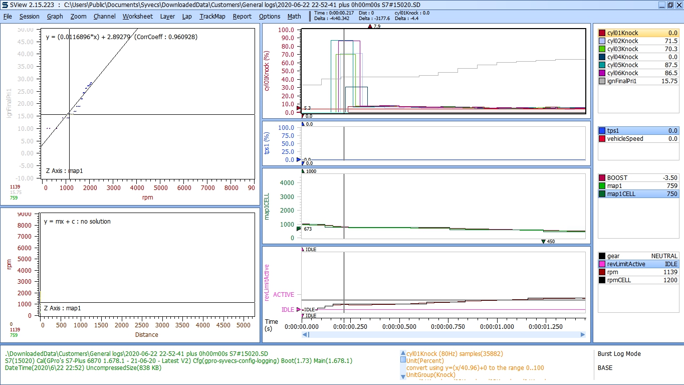

I tweaked my knock gain and gain tuning to get all 6 cylinders knock values to 3.0 on idle. I had to use the lowest gain possible of 0.111 along with a gain tuning of
cylinder 1 - 0.91
cylinder 2 - 0.89
cylinder 3 - 0.90
cylinder 4 - 0.91
cylinder 5 - 0.90
cylinder 6 - 0.91
I just wanted to confirm, is this normal behaviour? having to lower the gain to the lowest possible value in order to get the knock noise to 3.0 on idle? engine is a 2JZ-GTE.

Using bosch wideband knock sensors, I tried the settings above but even on WOT at 7,000 rpm it peaks around 6.5 which is too low I assume? going to increase the gain higher and ignore the 3.0 rule at idle. Do let me know if anything I am doing doesn't sound right.

Thanks for the tips Rice Racing, managed to induce some knock at 0.3 bar of boost and sensor picked it up nicely.

Another little pro tip, most engines will show 'knock' when you start them, this is a really quick initial zero stress way to see if you have the sensor set up right physically and in software, which yours seems to be doing now ;)
