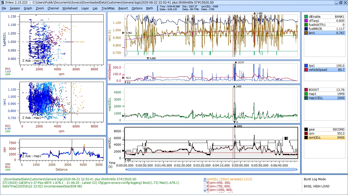

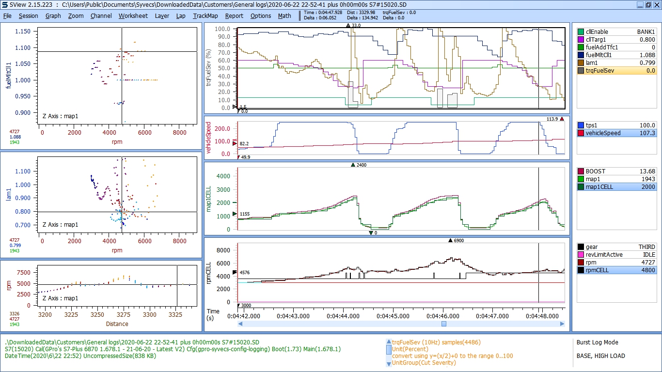

Also its bad practise to start stressing the engine without the base fuel being in the right direction (fuelMltCll1 <= 1.000), you want to be rich of your target not the other way as when limiters of any sort are applied the ECU correction is off and then its down to how good you set it up, not how good the cll control is.
~10% weak of target = bad
another
another

Fueling on WOT is near perfect with under 3% adjustments from closed loop lambda, the small WOT pulls on this log is from a much colder night then when it was originally mapped so I am adjusting my air charge temp multiplier to get it fueling spot on again. And as for running very lean on WOT, keep an eye out when TC engages. As it naturally lean spikes.
