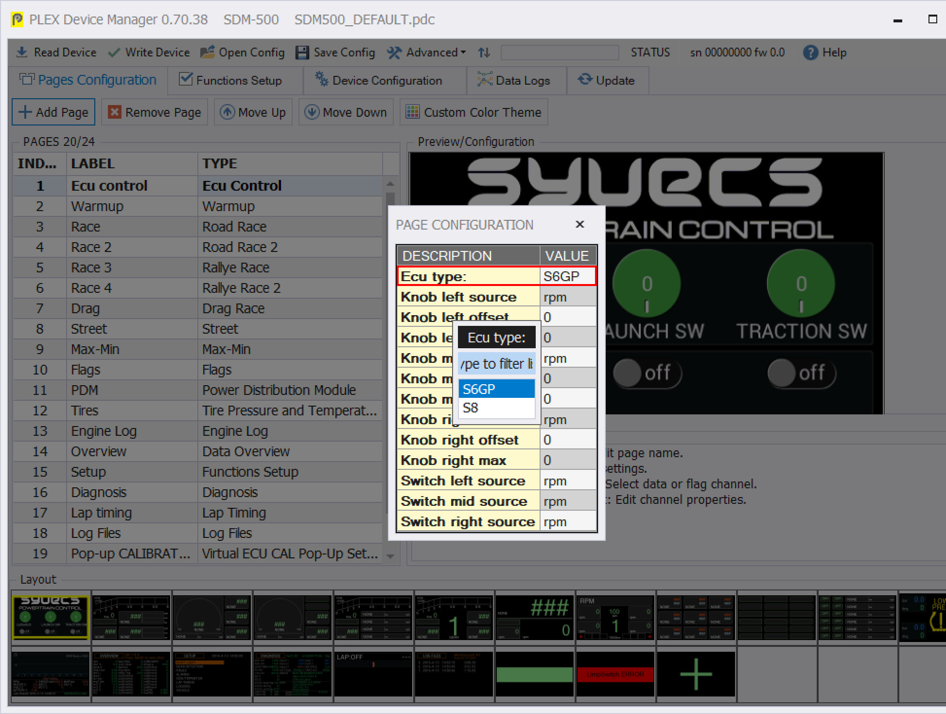

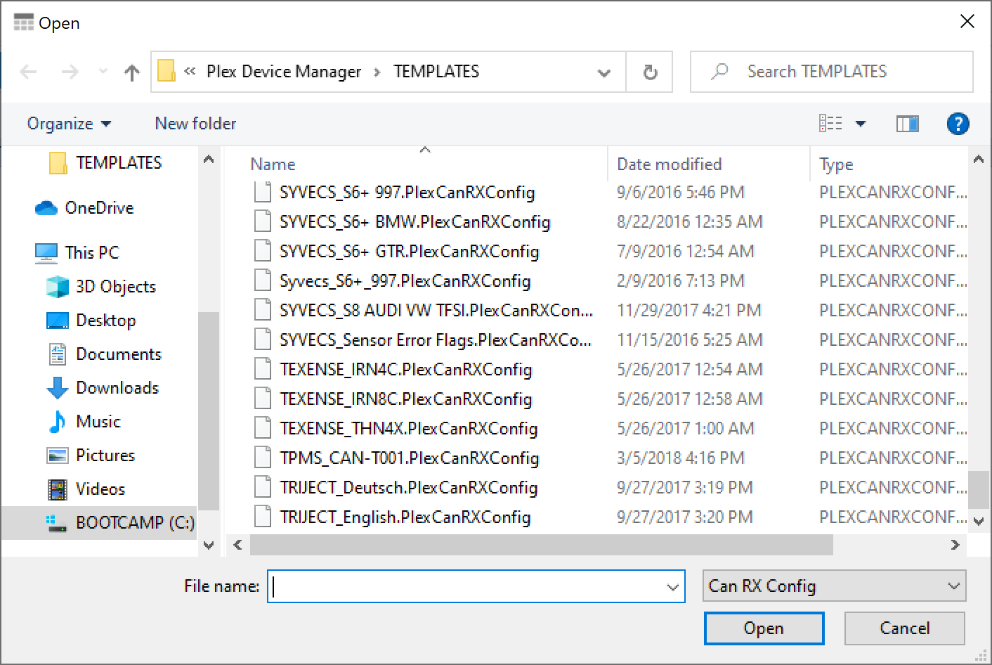

i keep running in to configurations that seem to support the s6 and s8 but not s7
basicly asking if its supported ? if yes which one shoukd be used s6 or s8 in the config
See SYVECS_S8_AUDI_VW TFSI ?

S6+ is more akin to the S7+, So I would try that.
But what is the problem ? What bit isn't working ?
is it wired correctly ? On the diagnostic screen on the Plex, is it receiving any CAN data ?

The page configuration you are showing are just display items, not really anything of consequence.
