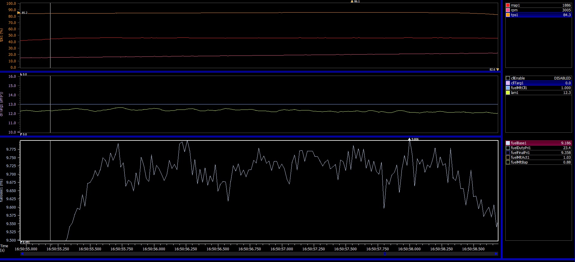

Re: WOT from low RPM vs high RPM
Posted: Sun Nov 29, 2020 10:54 pm
Fuel closed loop multiplier stays at 1 because closed loop is off.
If you think some corrections are causing the changes....log all the corrections ?
Does it do the same thing on regular fuel ?
Also a little odd that when it transitions from CL on to off.....the CL target drops to zero ?
Although an extreme representation...fuel base is also fairly up/down for the area shown....so whatever mapping is in those cells could be smoothed a little ?
logger RPM is very stable, logged MAP is very stable...so why is fuel base a little up/down ?
- syvecs fuel up down.jpg (260.87 KiB) Viewed 45675 times
