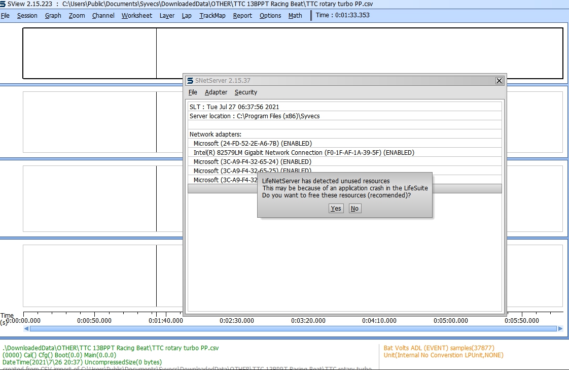

I'm trying to pull in a CSV (sample below), it has around 180000 rows.
Get errors with SNet failing and if i do manage to get the file in it seems to not have all the data there.

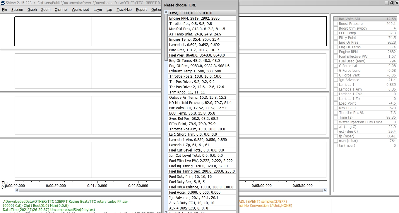

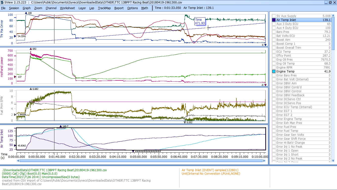

If its a big file and assuming you have used an editor first to get it into the right format?
then its normal for it to hang up, what you have to do is let it do its thing, will eventually get there as it crunches through it I have found.
hang up.jpg (294.2 KiB) Viewed 13985 times
works eventually.jpg (673.16 KiB) Viewed 13985 times
Posts: 524
Re: Import CSV into SView
635,102 rows in that example ;) works fine *eventually*

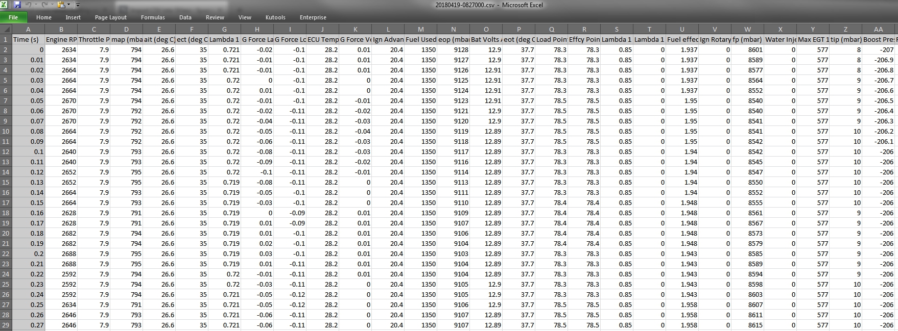

Thankfully don't have to do too many but every now and then a clown rocks up with a Mowreck turd or other nugget that I have to take a look at and their software is so mega shit that I just have to go through this process :(
Just make sure you get rig of all the ID data at start, same for VBOX files, same process.
Can be things like too many numbers after a decimal point etc, just use find replace and you will smash through it pretty quickly.
I also like to delete irrelevant rows in Xcel too helps.
But yes its normal for it to show the message, just wait a while and it will come good on its own.

Unfortunately every time i get the message that connection to Snet server has been lost and that the program will exit :?
Posts: 1412
importing .csv into Sview is a PITA.
And I think you manually need to select "time" first...and then in the next option manually click all the values you wish to import ? If you get that bit wrong I think it exits the way you say.
