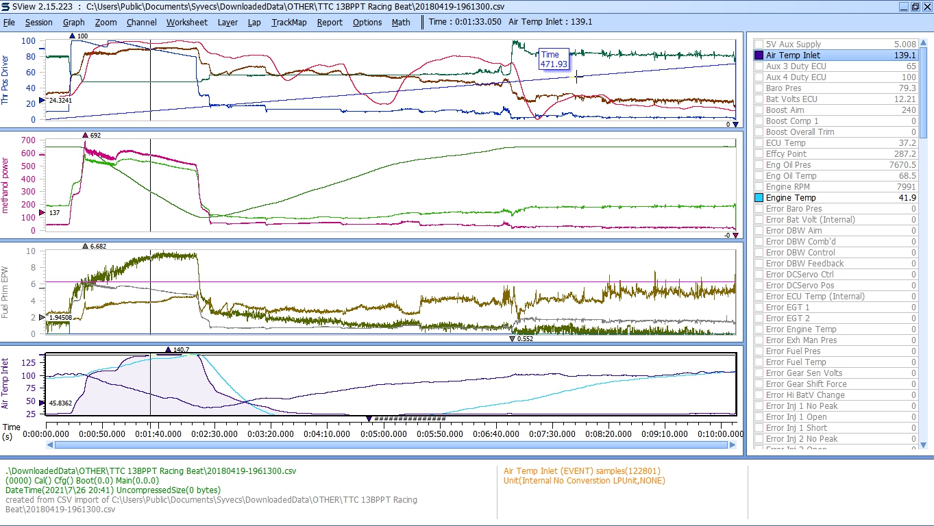

If its a big file and assuming you have used an editor first to get it into the right format?
then its normal for it to hang up, what you have to do is let it do its thing, will eventually get there as it crunches through it I have found.
hang up.jpg (294.2 KiB) Viewed 13993 times
works eventually.jpg (673.16 KiB) Viewed 13993 times

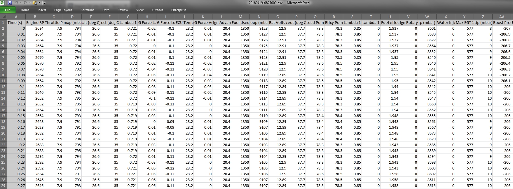

Just make sure you get rig of all the ID data at start, same for VBOX files, same process.
Can be things like too many numbers after a decimal point etc, just use find replace and you will smash through it pretty quickly.
I also like to delete irrelevant rows in Xcel too helps.

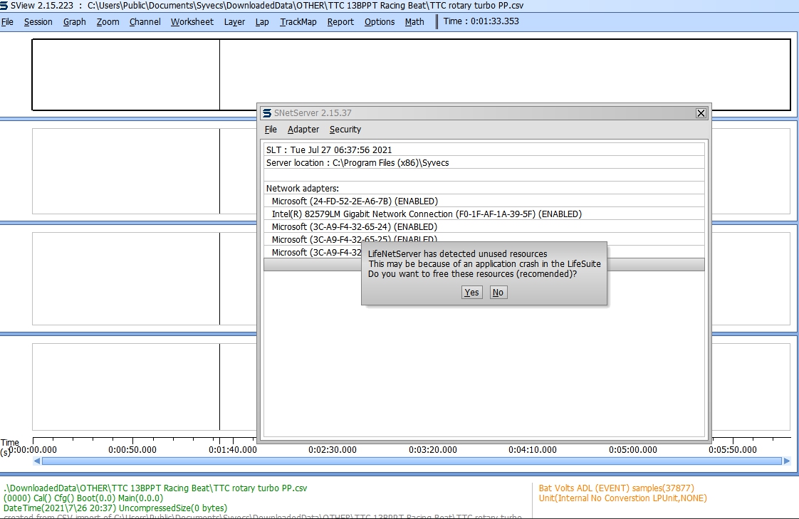

Unfortunately every time i get the message that connection to Snet server has been lost and that the program will exit :?

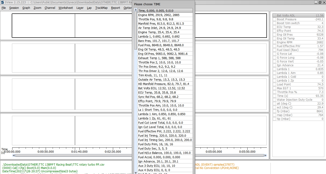

And I think you manually need to select "time" first...and then in the next option manually click all the values you wish to import ? If you get that bit wrong I think it exits the way you say.
