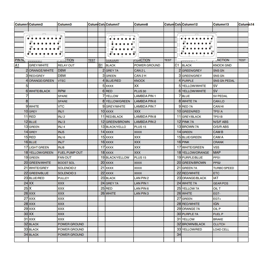

One easy way to start would be unplug the two larger connectors from the ecu and power it up via only the B, middle plug.
That should eliminate most of the external power/sensor/actuator type wiring to see if the ecu is still alive and happy.

Have you confirmed power/ground at the relevant pins on the B plug at the ecu ?
B1 ground, and in your case B13/B19 ? ( as you're backfeeding power to the lambda sensor from B7 )
When this has power, can you confirm either comms, or no comms ?
And as said before, I would be doing this with the A and C plugs disconnected to remove as much of the loom from the ecu as possible.
