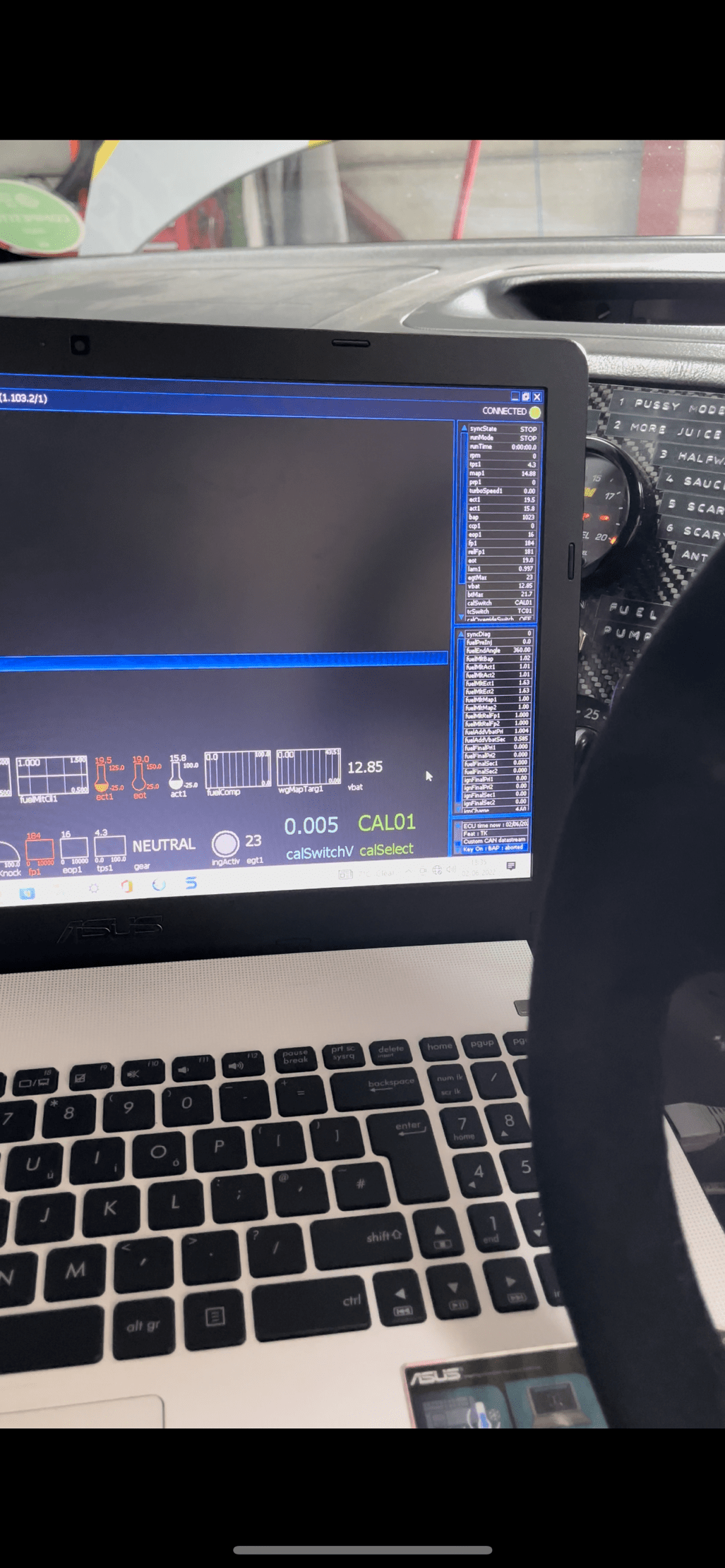

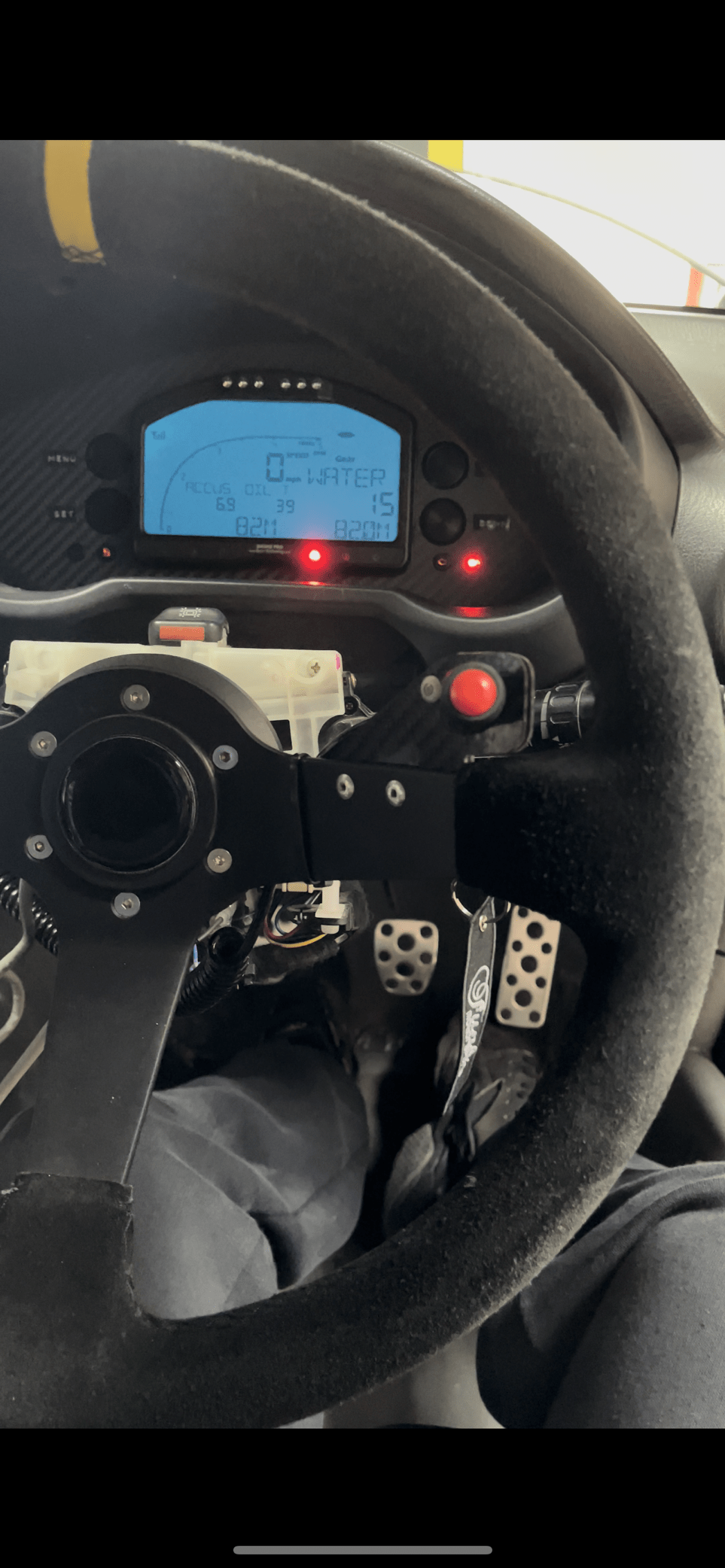

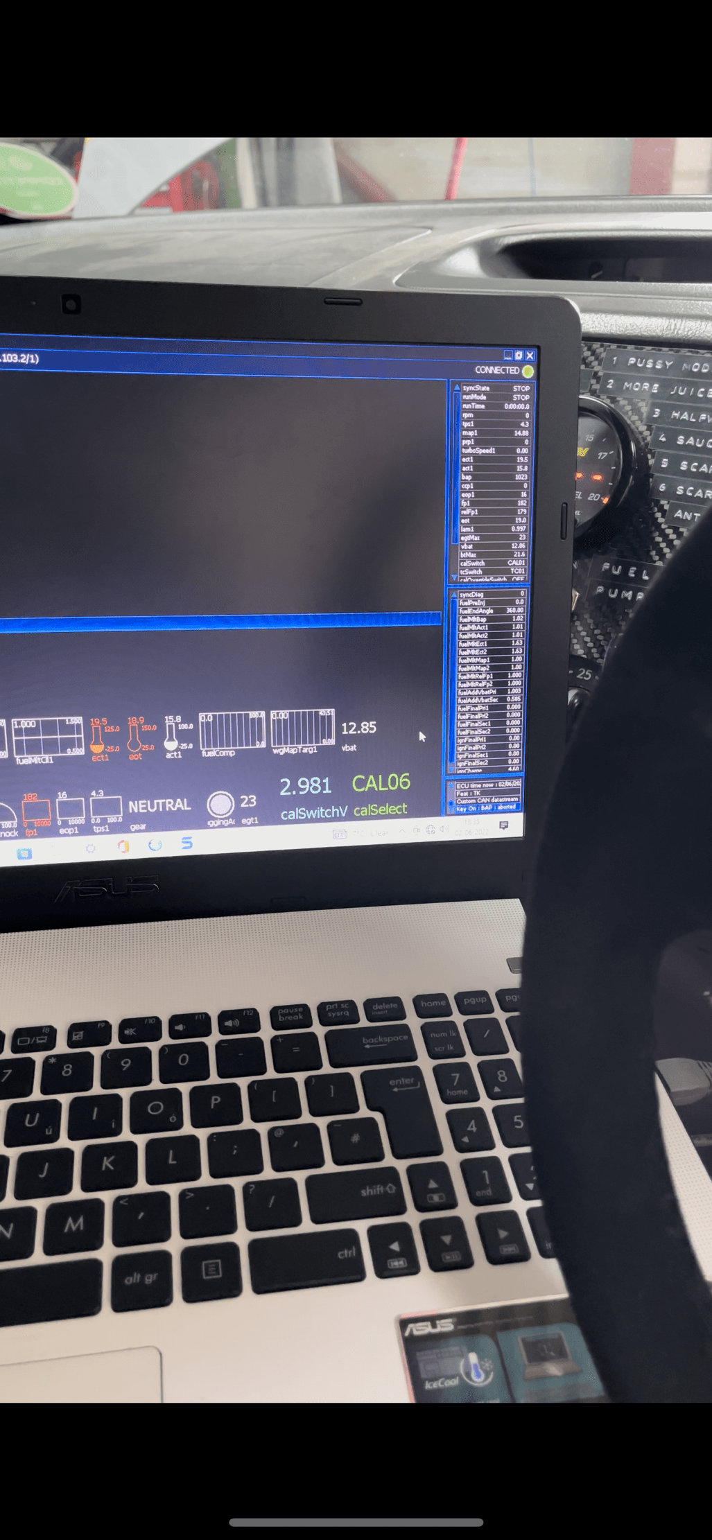

Thankyou for the responses, much appreciated, I thought I’d update you with what I did, I went with the momentary switch grounding the signal wire to the ecu, this did exactly what I wanted and I’ve altered the calibration in cal 1 to suit. I’ve added some screen shots below, apologies for the poor quality but I think you can make out the cal switch voltage and cal on screen.

- Here is with the button not pressed on the current cal 6 on the rotary switch

- Here’s the cal 1 override with button depressed

- Here is the scramble button on the wheel
