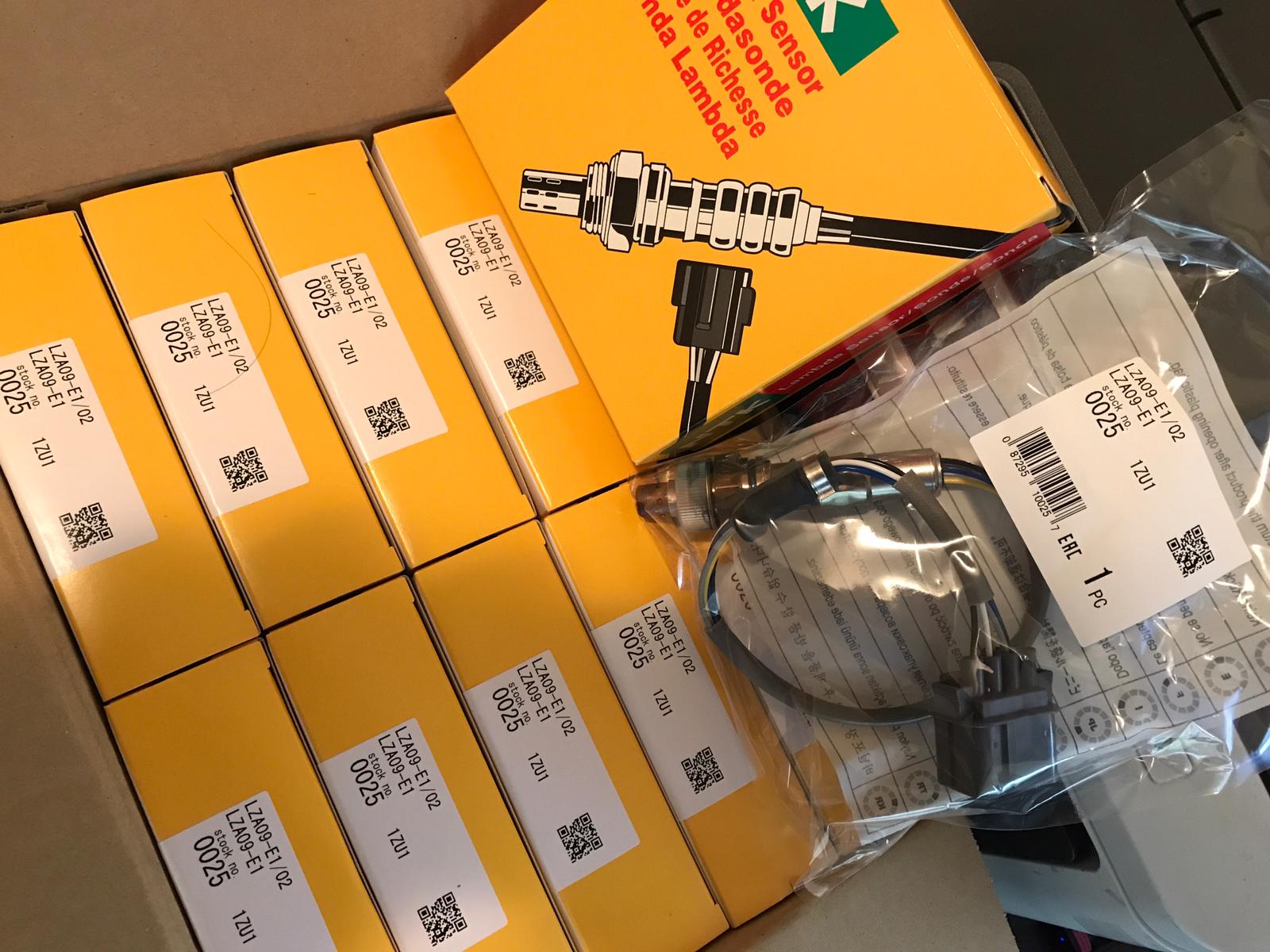

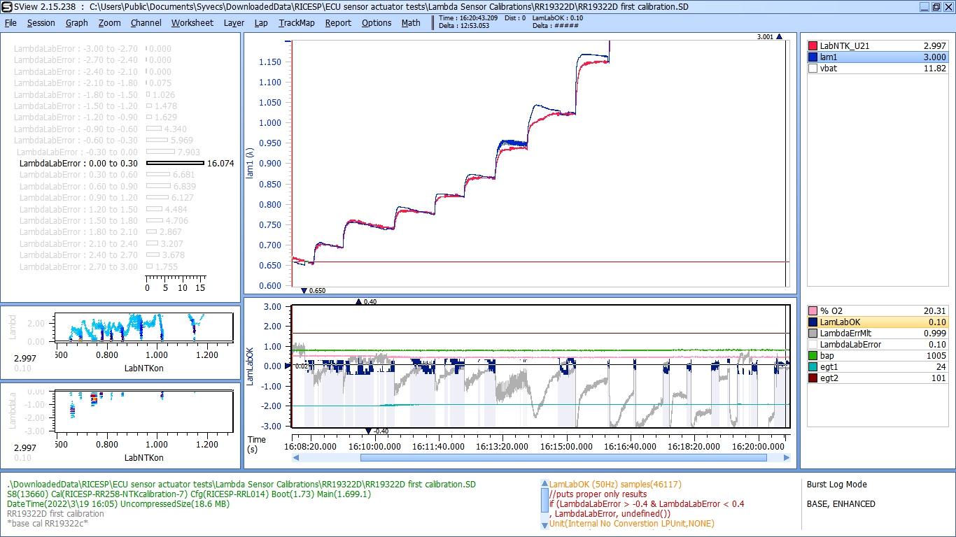

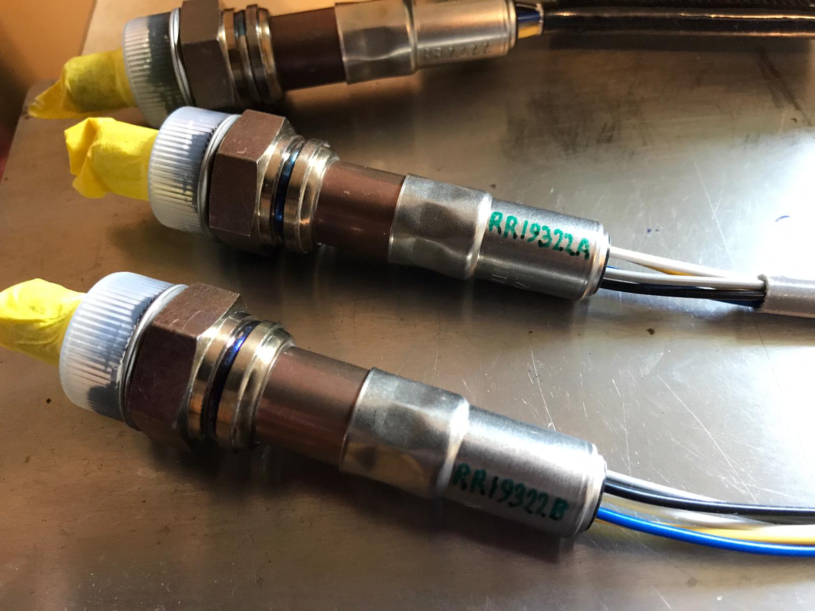

Ok, we keep stock of these 'custom NTK' sensor in boxes of 10 as below. These are a plug & play using the stock connector for any Syvecs kit. It takes a couple of days to turn around for those interested.
Every sensor is logged and validated. Pertinent info kept on file is date calibrated and conditions when it was done
- Baro pressure
Temperature
- Relative humidity
% O2 in air
- Accuracy to laboratory grade NTK
These will be available in stock to dealers and end users alike, you can contact Syvecs Dealer or myself for pricing.
Once you have the sensor, email the serial number on the unit to obtain the linearization file to upload to your sensor database.

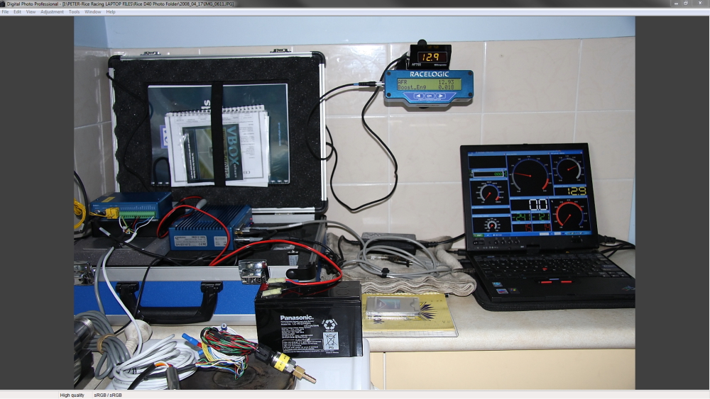

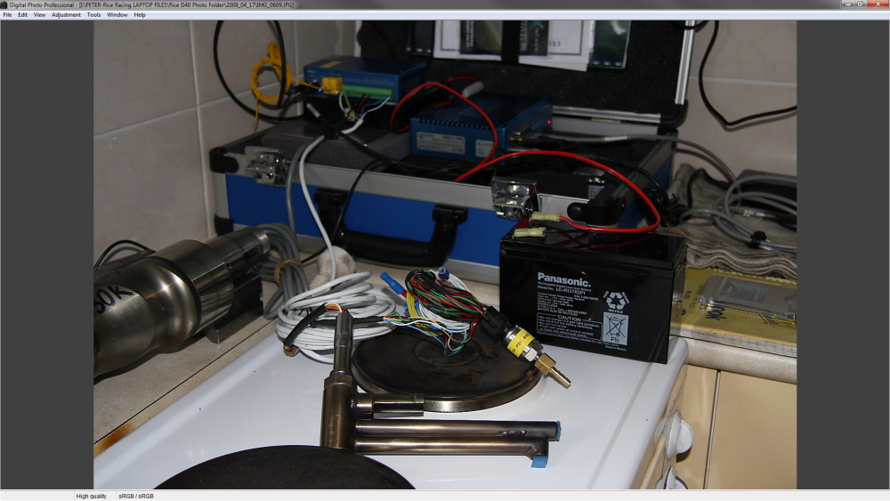

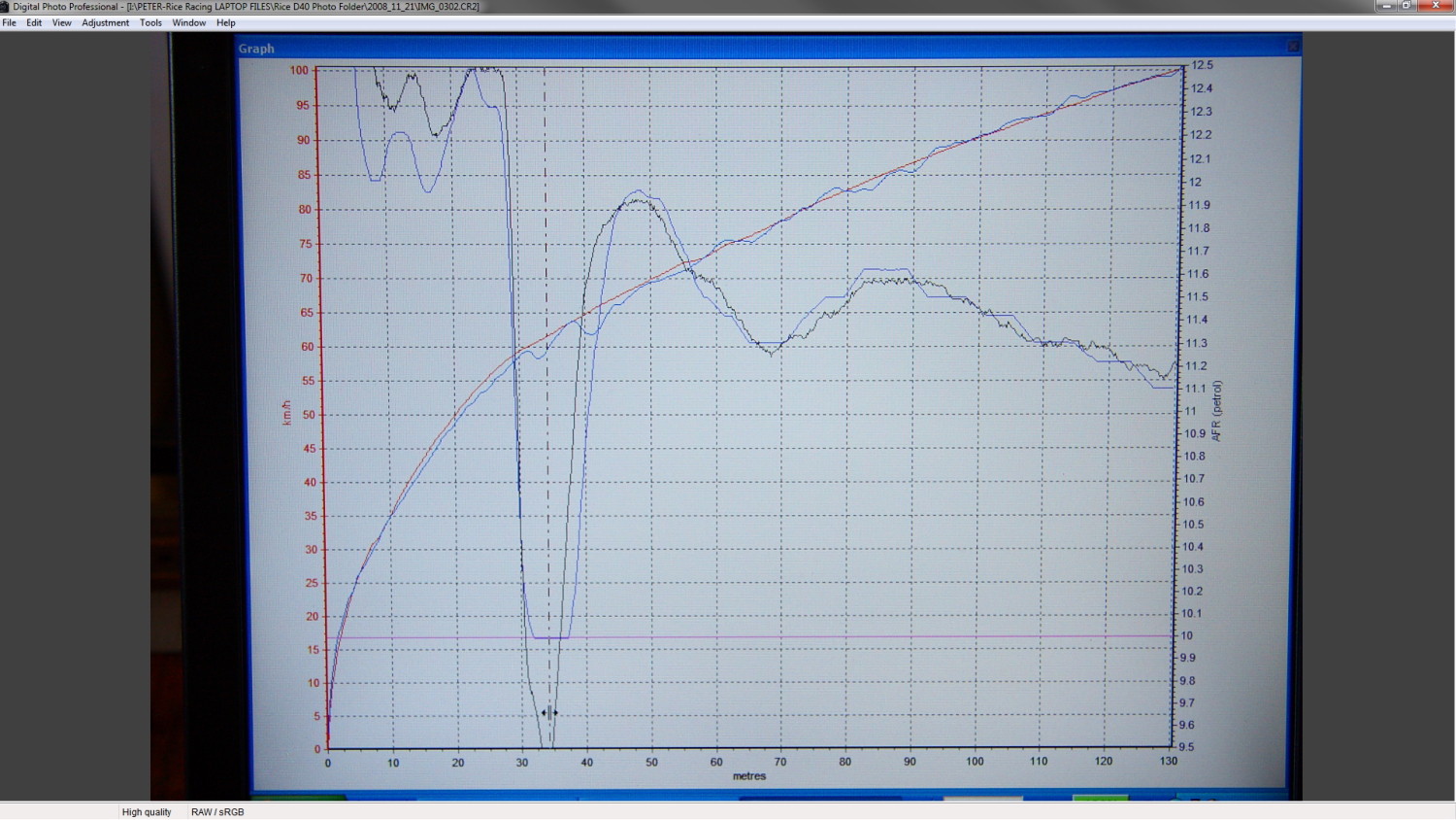

But still good information, so in 2008? I had a customer complain that the Neko AF-700 was out 1 AFR v his dyno meter, the thing was mounted in the turbine exit (high pressure point) v the tail pipe probe on the dyno meter, this was also an old LSM-11 type which was common lower cost more durable day to day sensor for shops to use, could be molested Fritzl style for years without much thought.
We simply made a test probe and put on an OEM consistent car and repeated multiple tests on same hour, this car when run with one meter would do back to back results you could not see difference in traces, so swapping out the meter type was valid to tell differences. We ran the $1000 true lab grade NTK sensor in the test meter then followed up by the bespoke EPROM Motorsport NTK (NEKO meter) you can see the results, pretty close to each other.
It is funny over the years doing so much of this you forget just the sheer qty of information and some times need to revisit it all! Especially now knowing more of how these things work and why and what can influence and end users results when measuring at different points in an exhaust especially.

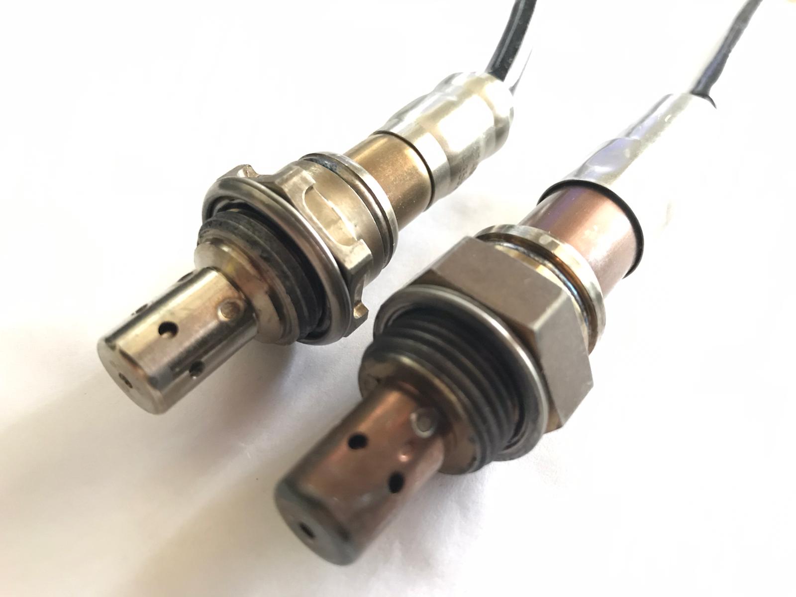

- Honda_PU-73198.jpg (271.17 KiB) Viewed 265770 times
- Google NOTKuntz 2.jpeg (85.39 KiB) Viewed 265770 times
