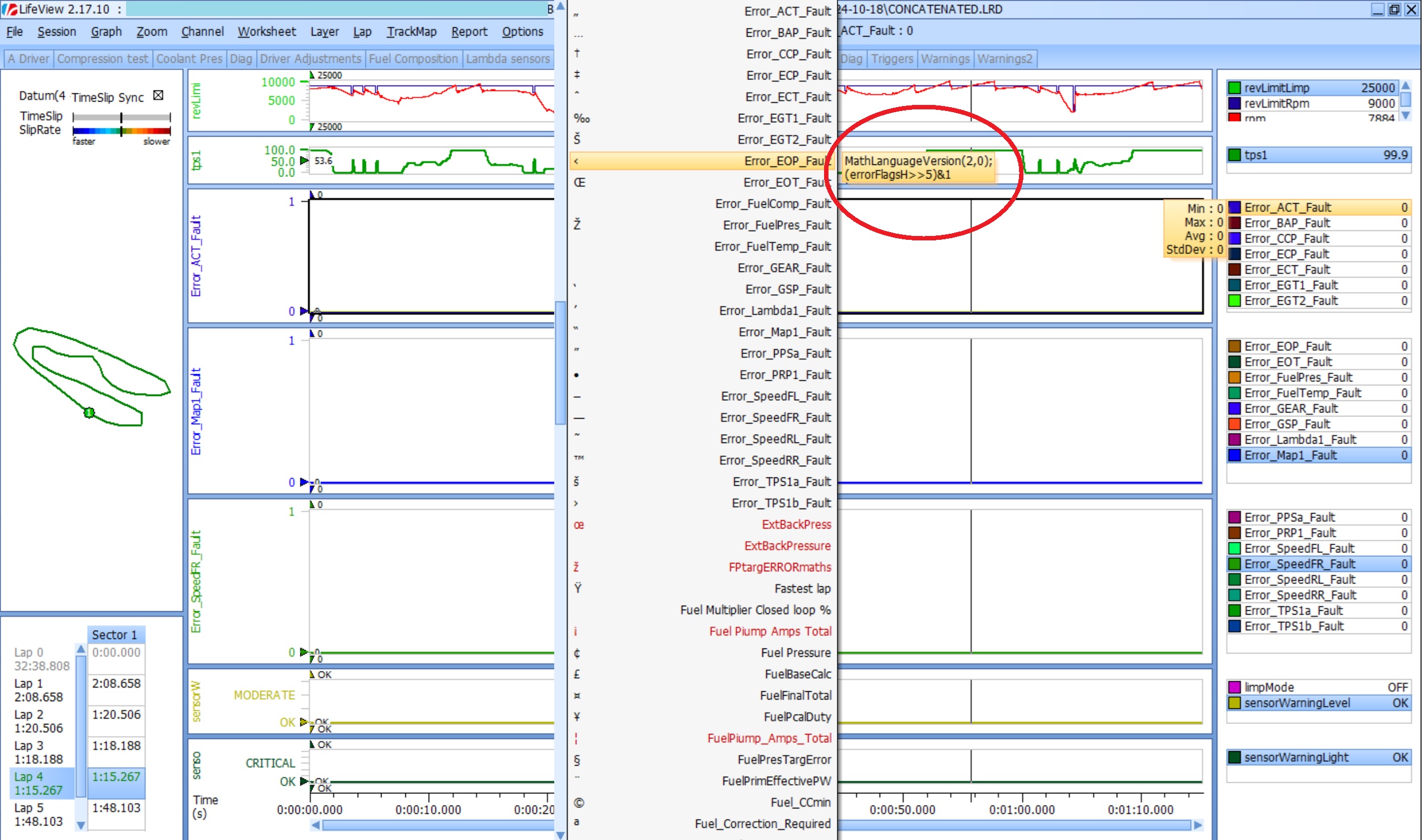

The individual sensor errors can be extracted from “errorFlagsL” and “errorFlagsH” by using the maths circled in red in the screen shot below.
For the EOP sensor fault example shown the “5” in the maths refers to the 5th bit in “errorFlagsH” which in the “Error Flags Items Bit Assignments” in the ECU calibration is assigned as EOP.
Note that “errorFlagsL” refers to Bits 0 to 15 in “Error Flags Items Bit Assignments” and that the 1st bit is “0” and the 16th bit is “15”.
And for “errorFlagsH” refers to Bits 16 to 31 in “Error Flags Items Bit Assignments” and that the 1st bit is bit 16 and the 16th bit is bit 31.
Once the maths is set up it is a great way to instantly spot any sensor problems in the logging.
