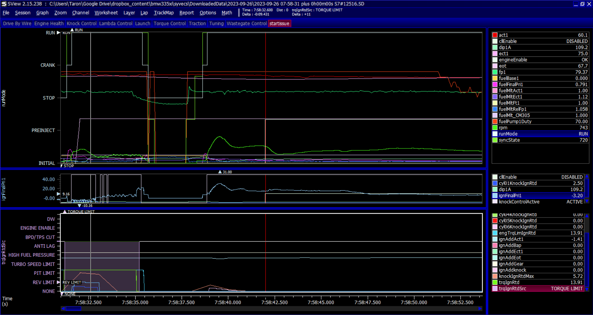

looks like torque limit trip is getting triggered.
torque limit trip.jpg (224.22 KiB) Viewed 46746 times
anyone knows where is this configured ?

Re: total timing drop during cranking
Posted: Tue Sep 26, 2023 5:46 pm
no idea on the torque limit.
But you do not appear to have the lambda working correctly, it's only logging whole numbers. Odd.
There are a couple of huge "knock", noise spikes on cyl 1 then cyl 6. Like really huge whatever is causing the noise not long after starting.
Something very weird is going on during cranking, and around the time of the timing change, where runmode goes from crank, to stop, to crank, yet shows an rpm reading throughout.
Timing might be getting pulled back via idle control, but you are not logging enough to see if that is the case.
Has it ever been setup and tuned correctly ? has it ran correctly ? or new install ?
Even right at the start of the log, runmode says stop, yet it is clearly cranking as it has an rpm reading. Which seems odd.
And for some reason your DBW target shot up to 100%, yet no movement at the pedal. This appears to be during cranking, around 380rpm....I can't see why anyone would ever want the throttle to be aiming for 100% during starting though.

and I can actually hear the knock honestly. This is forged engine I was just assuming this are the piston noise as they just stop after it starts, maybe I do heave loose injectors which leak? I will recheck
the runmode drops to crank after run because rpm drops lower than 600rpm which is runmode crank threshold, this is cause because engine cant keep up the running ?
looks like timing is being pulled back by 13.9 through trqIgnTrd which is most likely activated by LORQUE LIM TRIP.
and maybe noise is appearing because of the liming drop ?
regards
