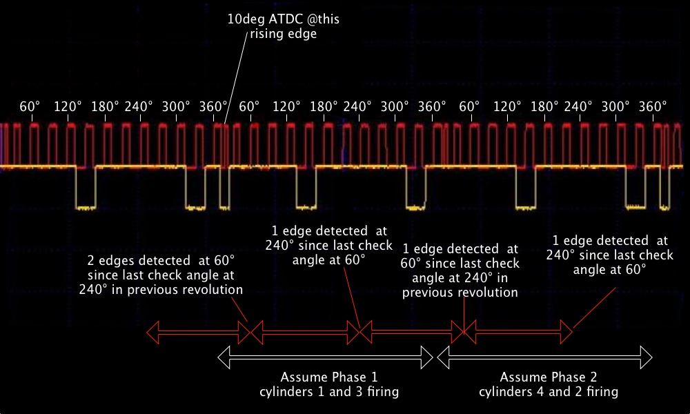

It's not easy to explain the manual cam check list, with you 10 deg info I can sort a cal file for you.
Essentially the check angles in the cam check list are chosen so that there are a different number of events in each phase. Looking at your scope trace, there are 3 events in one phase and 2 in another. The checklist works like a a counter, you are looking at the number of events since the last check angle
Using rising edges for cam.
So check angles at 0 and 270.
Phase 1 0=2 270=1
Phase2 0=1 270=2

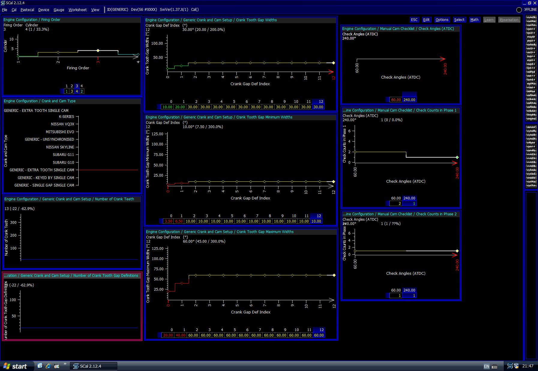

So below I have a screenshot of all the relavent settings except reference angle, which for us will be the tooth after the extra tooth, so depending on the choice of edge it will be at 30deg or so, and we would check this with a timing light to be sure.
k20 syvecs settings
k20 syvecs settings
The manual cam checklist is mostly explained below. The nice thing about it is we are not so fussed about having exact numbers for the purposes of synchronisation, just the number of events in a crank angle range of our choosing. In each phase we create as many angles as we want, and from one angle to the next we simple need to know how many cam events there have been. So the ECU can determine the phase they each need to be different, so we choose the angles carefully. It is important to note, that the check angles at the first check angle in the first phase are not from TDC, but from the last check angle in the last phase.
You can also get the car running in sync 360 and CamRaw will tell you where the ECU thinks the angles are. In the case below I would estimate 20°, 120° and 340° in phase 1 and just 120° and 340° in phase 2. When the engine runs in sync 720 however it will report those cam angles wrt the full 720° engine cycle so they will become 20,120,340,480,700.
It's also worth noting that if the sensor is equally effective and reliable on both rising and falling edges, we can choose either of them under the sensors menu for the crank and cam sensors. For some trigger patterns and strategies it might be useful to offset an angle of a cam sensor so it is nicely positioned between crank sensor events (in the case of keyed by single cam) or that it is not very close to TDC and liable to drift from the beginning of one phase to the end of another (in the case of Single Gap Single Cam).
I have assumed the extra cam tooth is in phase 1 when cylinders 1 and 3 are firing, but there is an easy way to check. First of all get your crank setup sorted and then under "Starting->Minimum Engine speed for 720 sync" set that to some speed higher than start or idle speeds, get the engine started and running half right in sync 360 then rev beyond the minimum to enter 720 synch. If the phases are wrong the engine will stop dead, in which case all you need to do is swap the checklist counts in each phase. So 2 and 1 in phase 1 with 1 and 1 in phase 2 would become 1 and 1 in phase 1, with 2 and 1 in phase 2.
