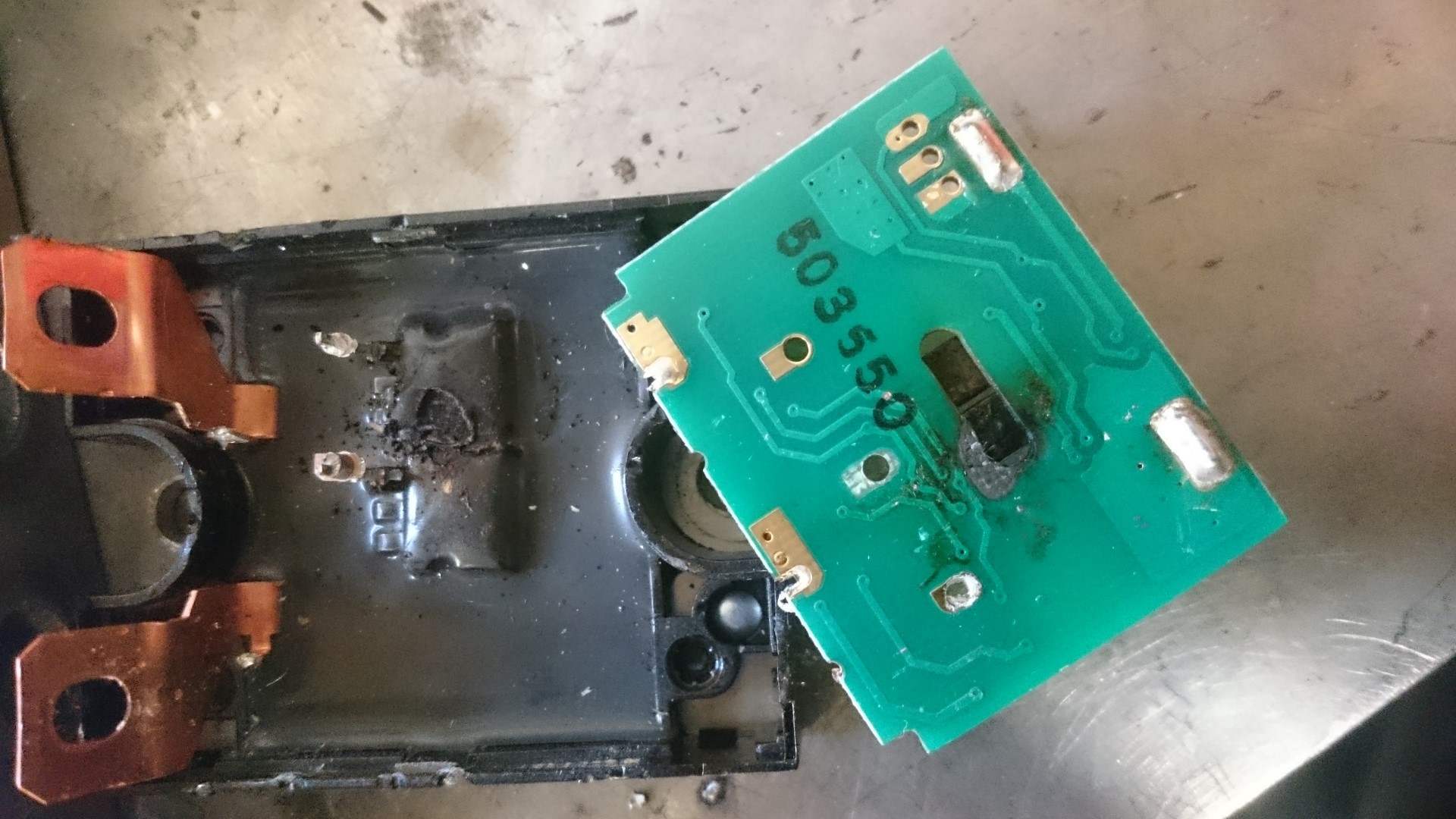

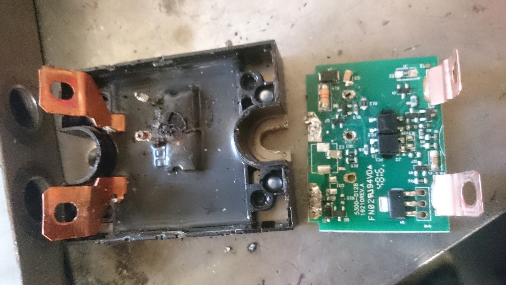

Out of interest....how did you kill them ?
I killed one myself, but pretty sure it was a wiring short the way I soldered them onto the diode for convenience then heat shrinked them.....and the heat was a little too much for the wiring sheath and as I crossed the wires over each other, pretty sure they shorted at some point. lol
Mine went up in lots of smoke, raging as it was a proper Crydom one, not even a cheapy ! lol
Given the actual load through the flyback diode would be veyr small...I dont think it would need a huge diode ? I think mine was around a 5A piece.
Mine worked fine for initial testing, went for a drive and again all seemed well. Got home, turned the car off but the pumps stayed running, although definitely not at full power
It was during probing to find out WTF was going on the SSR went up in a cloud of smoke.

Re: Output Current Limits
Posted: Tue Jun 27, 2017 12:23 pm
by T04GTR
i killed one, a 40 dollar china one, from jaycar. testing the fan pwm. it took about 1 min to fail. i tested it at 1000hz, not much happened under 70% duty. put it down to 500hz and within about 10 secs i heard the fan motor belt squeal as it went closed circuit and gave it full power.
i bought another one (different brand), and it was turning on straight away, apon testing i noticed that the pwm output (fan3) was showing 100ohms to ground with the output switched off, and removed from the cal....
so i moved it to slave1 output 20. (slave 1 ignition4 according to the pinout sheet i got) re tested and same thing. with a 10 amp diode going from the load+ to ground.
(i had bat to the relay, from the relay thru the motor to ground.
signal was a 500ohm resister from the bat + to sig +. then sig- out to the ecu.
i used the 500 ohm resister because i was scared some bad shit was being sent thu the signal wire into the ecu. somehow.. not sure how i killed an output. but version 1 was with no resister. so im guessing it was getting flyback thu the mosfet when it was "on"
and i had a 1k resister across the signal posts.
i had a 3rd relay at work, so i wired it up a little differently, bat + to motor, from motor to relay then to ground. sig was wired the same as the earlier ones. this time i had it on the hoist, and just touched the pwm sig to the relay to test different frequency. 500hz seems to work well, but it gets to hot to touch after about 5 secs.. ive given up on the ssr idea. i need to bite the bullet and get a proper fan module. but i cant find any info on the pwm frequency sent to the oem modules.
im sure the guys have that info. as its an 600w audi module i think il get.
Posted: Tue Jun 27, 2017 6:53 pm
Did you heat-sink the SSR? at 60A, a 100A SSR will need a 1C/W heatseak to keep it cool and for it not to die.
I would have no hesitation in using a decent 100A SSR (e.g. Crydom) properly heatsunk, with catch diodes wired as per manufacturers recommendations. And if you can use the Syvecs software to limit the initial PWM so it soft starts (surely possible?) then even better.
Posted: Tue Jun 27, 2017 6:54 pm
Anything I've read about the cheap ones, is dont go over 100Hz.
That's why I bought the Crydom, it stated it can run to 1000Hz although I think I tried it at 800.
The Chinese SSR's I bought were more like £10, so no idea how they'll work.
But before I drove mine, I was ran the pumps all way down to around 45% up to 100% and it seemed to do it no problem, SSR never even got hot.
I'm sure the failure was my own fault with the diode/heatshrink/wiring
I did not use any resistors etc, it all worked fine without them, and turned off ok during testing. SSR's seem to want the current to flow in one direction only too....ie the supply/load are fixed terminals, whereas with an old relay you can use either terminal.
