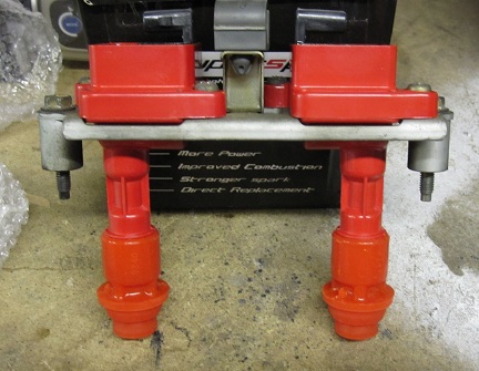

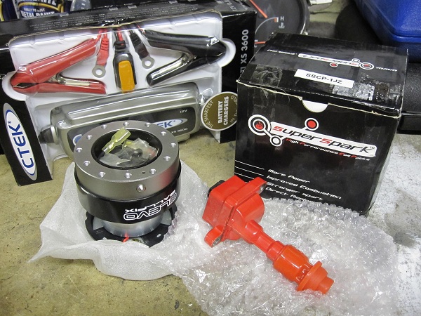

Hey Jurgen,
I went with SuperSpark direct replacements on my 2JZ-GTE.
They were cheaper than OE units and with a Syvecs do not require any other ignition mods (CDi, DLI et).
