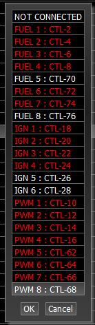

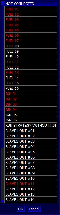

Hello,
Have the AUX1-8 (PWM1-8) output been renamed FUEL 9-16 in later releases?
Previous versions also gave the control board pin number alongside the output type and number, but in 1.69 I just see the output type and no control board number?
Older version...
Latest 1.69
Cheers,
Jezz.

PWM1 (CTL-10) = FUEL9
PWM2 (CTL-12) = FUEL10
PWM3 (CTL-14) = FUEL11
PWM4 (CTL-16) = FUEL12
PWM5 (CTL-62) = FUEL13
PWM6 (CTL-64) = FUEL14
PWM7 (CTL-66) = FUEL15
PWM8 (CTL-68) = FUEL16
Cheers,
Jezz.
Re: Output pin names, have they changed?
Posted: Sun Aug 14, 2016 9:11 am
I need to go back to 1.50 for it to have the old numbers, all newer versions say FUEL instead of PWM/CTL
TBH I did notice a change in the software when I did the output test yesterday, mainly noticing it was easier to correlate the two from I/O config to the output I tested
But never though much as to why it was easier.
So the new numbering makes sense within the software, even if it may slightly alter excel/wiring table setups.

1) Yes, PWM1-8 were re-named as FUEL9-16, this happened when the S6 firmware was enhanced to allow more than 8 injectors and it was simplest to just rename them all - that way you can still choose (max 12 assigned at the mo). This is also more consistent with the S8 naming convention. The CTL numbers were dropped because they refer to pin numbers most people will never use (the 100 pin interface between the control board and the carrier).
