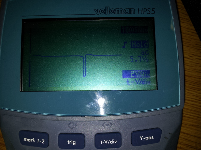

It could be that you might need to tweak the dwell a little. A CDI should work with almost no dwell but it could be the ignition outputs are taking a little time to go high before being dragged low.
Can you scope the ignition outputs to check you are getting a sensible square wave?

Hi Paul, thanks for your time.
Scope attached of ignition output.
Yes its on sequential each cylinder is on an output from the M&W CDI.
Coil charge time is on 2.5ms from 13v onwards.
Lambda target I tried from 0.95 to 0.75 nothing seemed to make a difference on Ethanol, even timing +/- 20deg
no difference at all, don't forget that on gasoline it works perfectly so the power to ignite the ethanol is the issue probably.

Re: Ignition breakup help needed.
That looks fine on the scope and 2.5ms is fine for CDI.
I would check your CDI wiring and setup in general as I have used the Pro14 with an S8 no problem at all. Check you have a good +12v supply and good grounds for the CDI and all the normal things.
It could be the coils, personally I tend to find OEM coil on plug units to be very good and I would be sceptical of any aftemarket stuff.
