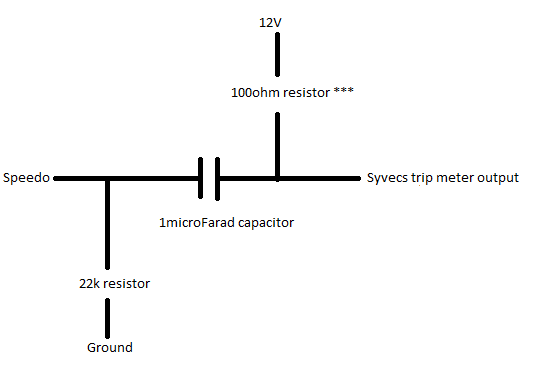

The Nissan speedo needs a sine wave yes, but it doesn't need to be a perfect sine wave. A poor quality sine wave will work, as long as it crosses 0V. The speedo triggers on 0V, and needs 10000 pulses per km, or 16000 pulses per mile. My pulses per meter is set to 10 under Output Functions->Trip Meter for my km/h speedo.
You can use the following circuit to convert the digital trip meter output into a sine-ish wave which will trigger the speedo.
Nissan Speedo drive.png (5.74 KiB) Viewed 23635 times
You need a 100ohm 12V pullup, then a simple capacitor and pulldown resistor. You may need to play with the value of the pullup resistor (hence the asterisks), to get it working cleanly. I might have used a 1K resistor, can pull the dash to check if you don't come right.
