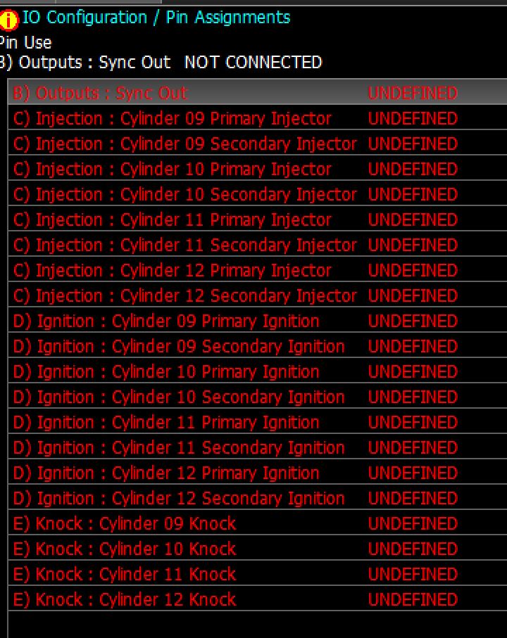

Yep - converted my cal to 1.79, flashed FW to 1.79 - loaded from disk - all apparently successful - however checking further in 1.79 I have
Outputs : Sync Out as UNDEFINED - which I guess is the issue - thing is its not there at all (at least not that I can see) in v1.79 and my only choices are NOT CONNECTED (I'm guessing this is the only valid choice) or IGN 1 thu 6.

- Undefined-179.JPG (167.23 KiB) Viewed 26473 times
Re: trouble going from FW 1.74 --> 1.79
That would be the error, yes. None of your I/O must be UNDEFINED. Change all UNDEFINED items to NOT CONNECTED, if not in use.
