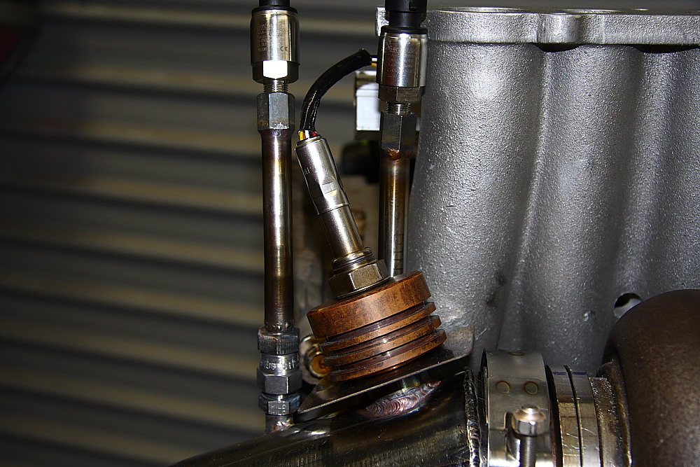

Your EGT is very low on the run you sent me so no reason why you could not run the sensor closer to the turbo outlet (right on it) like this below.
This is using a racing quality NTK sensor with special heat sink I made. NOTE: This uses one of my self made internal 347SS remote sampling chambers using venturi effect inside a solid copper heat sink. I tested this to constant 1150deg C for 2 hours straight on the sample probe end and the hex temp was never over 550 deg C :D

As Peter has covered above...it kind of depends on what EGT's you are seeing..and overall design.
Clearly the trend with these drag cars now is effectively no exhaust, which clearly makes things difficult for lambda sensors.
So for me, anything I work at has a full exhaust, so ensuring the sensor can run cool but also nowhere near fresh air is not a problem.
Something like Peters adaptor should cover you for both the above scenarios though
