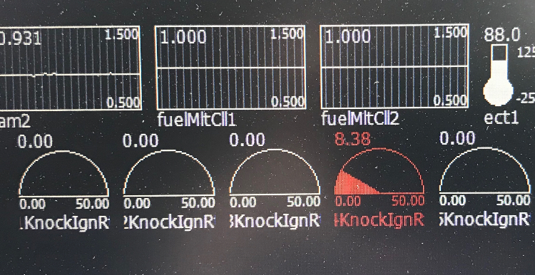

Sorry I don’t know the correct names to use but I plugged my laptop in for the first time on my S6 and number four cylinder knock was flashing red and reading a number of 8.38 is this something I should be worrying about I will try upload picture
It’s a half moon icon at bottom of scal screen there is 10 I think and they read as cylinders. I got a freind to sit in car and drove up the road and the same cylinder no-4 flashed up red again when I changed into 4th gear

It should be further investigated. ECU determined a knock evidence so retard the ignition. It may be a lift off det when changing gear or a real detonation.
