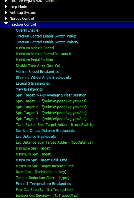

On the video it shows 11 speed breakpoints, but on my Life F88 ECU it shows I have 15 breakpoints?
Is the number of breakpoints configurable, or is it down to firmware changes that has increased the number of breakpoints since the video was made?
Also if I change the speeds on my 15 breakpoints, when I go back in to the Spin Targets (1-4) they graph is colour coded showing lots of red and amber. Is this a warning, is something wrong with the settings?
Also I'm looking for some usable TC settings, to start as a baseline. Are there any documented anywhere?

Number of breakpoints etc are user definable.
The colours simply indicate you've changed the numbers by a particular amount ( when online, not offline )
Once you've saved, D/P they will restore to green ( might need to move away from that screen and back again too )
As for settings.....entirely up to you to decide.
How much wheelspin might you want it to allow under certain circumstances for your car ? Review your logs, your driving style, the sort of g-forces you might encounter....and whether under high g's you might want to allow wheelspin or not, or keep a tight reign on it. Different areas of the track etc.
Presumably under most you wouldnt want to allow a lot of wheelspin given the type of car, it's not really a drifter. But it'll be down to your driving style.
Also view logs when you are accelerating with good grip....I know on my car, I can see as much as 6, 7% difference between F/R wheel speeds when I know there is no wheelspin, which seems odd. Especially with proper low profile stiff sidewall tyres. But it happens every time. So I dont want any controlling action within that range.

Where do I set the number of speed breakpoints?
For the graphs, where spin target 1 is set to 30% at 0.25G at 10MPH, what does that actually mean? And does the gradient slope in the right direction? Is it too aggressive?
I have 11 cal positions for the TC switch, so is it best to use posn 1 to 5 for dry weather settings TC, and 6-10 for wet, and 11 for off?
Sorry for the questions, I like to understand whats going on so I can make better sense of the settings.

I dont think you can change the actual number of breakpoints here...but probably no real need to anyway. But you can change their values ok.
30% slip at 10mph....is only 13mph driven wheel relative to 10mph undriven. So in percentage terms it seems a lot, in real terms it will allow almost no slip at all before it starts to cut power so could be quiet intrusive ( if TC is even active at only 10mph which is another setting option )
Likewise it will be aiming for this max slip target when your lateral g-force is up to 0.25g ( left or right, doesnt matter )

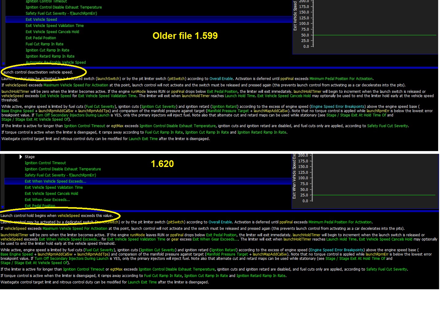

You need to look on your map to see if your launch is time based or speed based with regards to how long the launch "timer" will be active. "Launch ramp mode"
Also, the help files on SCal or LifeCal at bottom of screen explain the functions, and sequence of actions for them.
Although must admit....the help file seems a little contradicting in it's explanation of exit vehicle speed, earlier saying this was a launch de-activation speed....later saying it is now an actual launch control activation speed. ( ie move from stationary to launch hold timer which ramps the launch )
I use speed based on my car, I had this value set to a high speed....ie I expected controlling actions up to this speed, and on logs this does appear to happen with it following and logging a speed/rpm ramp etc, even if launch hold timer stays at zero throughout, actually only starting to count once the high speed value is reached which is at the end of 1st gear anyway.
