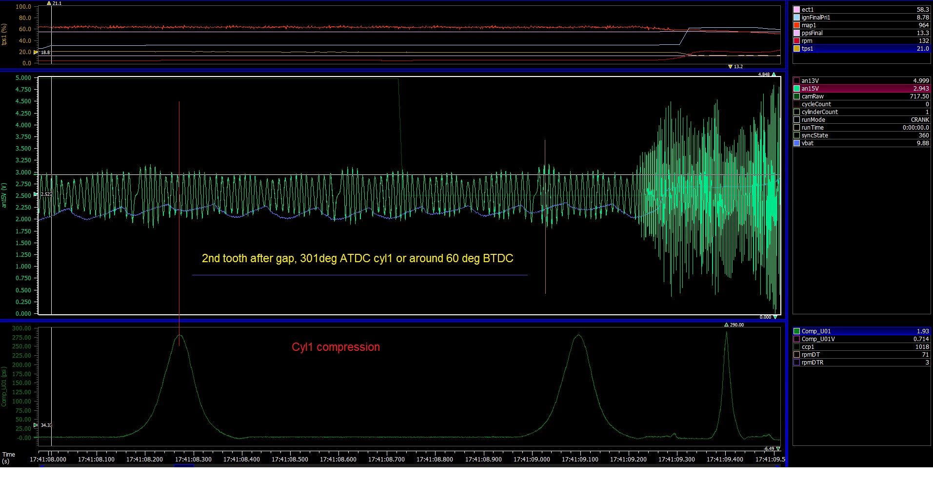

Timing references are setup after TDC in Scal, so factor that in. Some ecu's do seem fussy about where the gap is etc, but have never heard any Syvecs info to say it's a concern.
36-2 is becoming more popular where the gap becomes more defined though.
This is mine for a visual reference, 36-1, with the DTA this had a tooth ref of 67 deg BTDC for the first full tooth after the gap.
Same setup on my Syvecs I have it around 301.5degATDC, using the second tooth after the gap as the reference.
As graph shows, cyl1 compression is on the bottom graph to show you where TDC occurs, relative to tooth count. If we could overlay a 720 graph on View...would could examine the various events much easier. But we cant lol ( and I've asked )

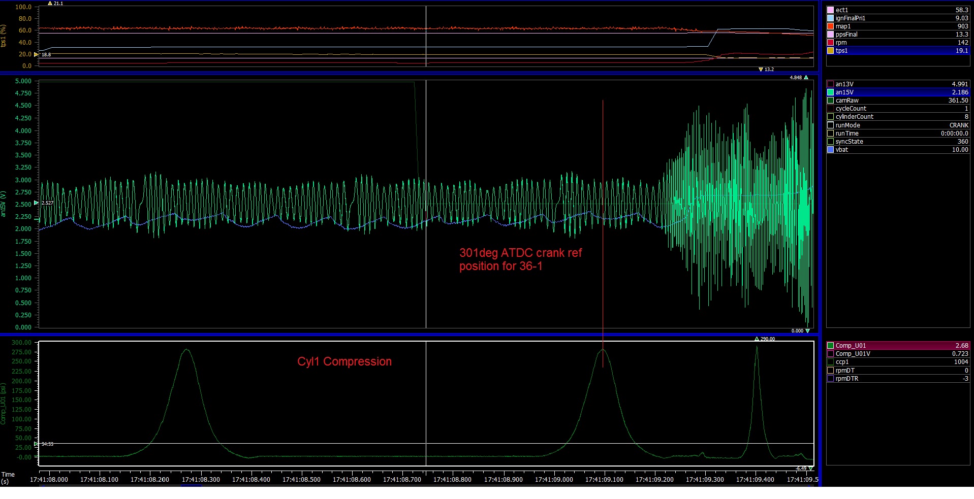

edit, notations on my first pic pic probably didnt make so much sense, so have amended it here

Steve what engine do you have, and is that cylinder pressure under cranking in your log? What kind of sensor detects that?

Just a cheap chinese pressure sensor, adapted onto a fitting from a compression tester. Obviously cyl1 plug isnt in place, but it will let you do a running compression test.
I think it was either a 300psi pressure sensor, absolute. So it can read vac too. Resolution was only listed at around 2ms, so not the fastest by any means
Any lag would be negligible at cranking speeds, but relative to cam trigger it is apparent if you rev it up a bit. Whether that's expected, the sensor..or other, I don't know.
I've never tried a faster sensor. The likes of Pico's WPS is supposed to be very fast...but then it's near a grand, so it'd bloody need to be lol.
