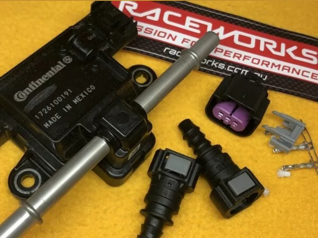

Looking for anyone who's got experience with the Continental type flex fuel sensors and how to spot potential fakes.
I've just received one, from what I considered to be a low risk vendor, and it arrived with a silver sticker designated SE1002S on. It wasn't adhered particularly well so curiosity got the better of me and I lifted it to reveal that, for some reason, the part number has deliberately been ground off :?
Serial batch number is 1726200208
Any opinions welcomed :D

pictures ?
Is it branded Continental ? Any QR type codes etc on it ?
I bought one from the US a while back, and the price did seem cheaper than average although it was part of a kit. But quality etc of the piece lead me to believe it is genuine.

Yes branded Continental as per the picture. There's is a QR code on the side which is just a number '60227872'.

After some Googling I did find one other source on an eBay store that appears to be scored out but I can't for the life of me figure out why.
Most sensors are either 13577394 or 13577379
It was from a well known supplier so perhaps I'm being a little paranoid...

Pretty sure mine had the code laser etched into it.
I'm sure I did take photos....damned if I know where they are now.
Mine was a different design of sensor.
Although quality of the item in your picture looks to be good ? Plastic casting, markings etc

Some sellers just erase part numbers either so people wont google and buy elsewhere, or they may claim it's something different than others are selling.
Re: Fake flex fuel sensor
When the fitting of after-market flex fuel sensors was unheard of, the first few suppliers bought the Continental sensor, ground numbers off, then stuck a label over it to pass it off as their own.
These days, the parts are well known, but someone somewhere obviously still thinks they are still to be kept secret :roll:

Thanks for the response Tim. Everything about the sensor looks legit, it just struck me as odd that the part number was ground off.
