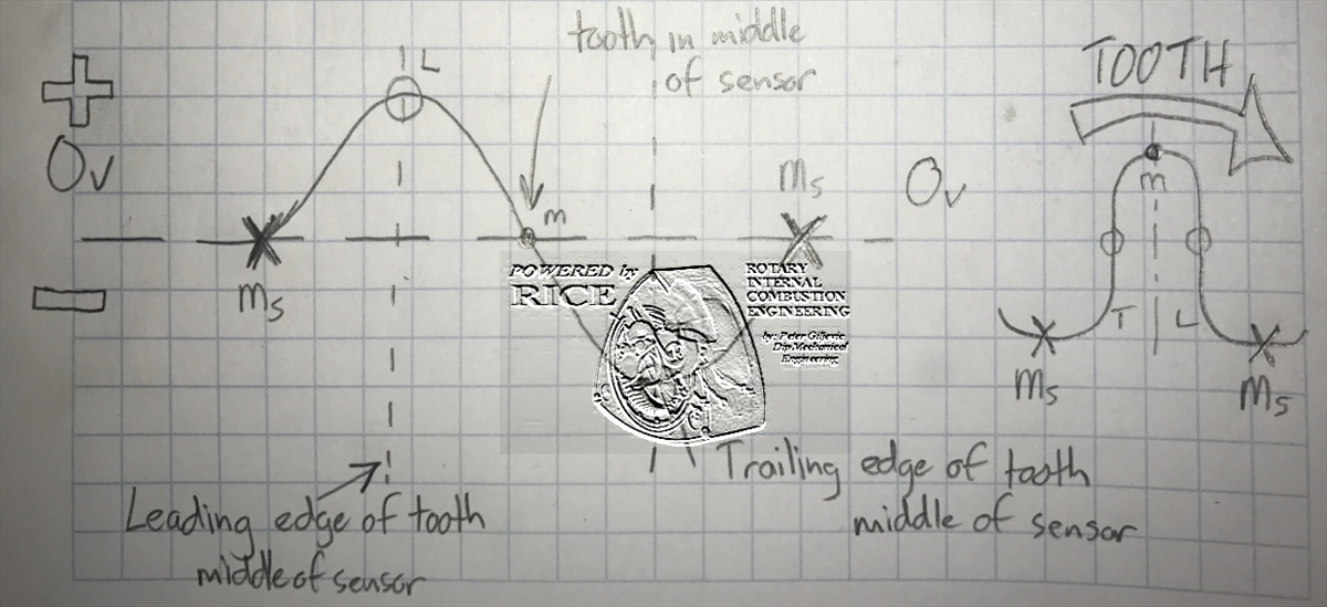

Stevie did a good job above.stevieturbo wrote: Wed Aug 28, 2019 10:23 pm edit, notations on my first pic pic probably didnt make so much sense, so have amended it here

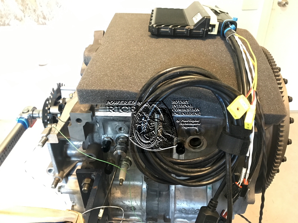

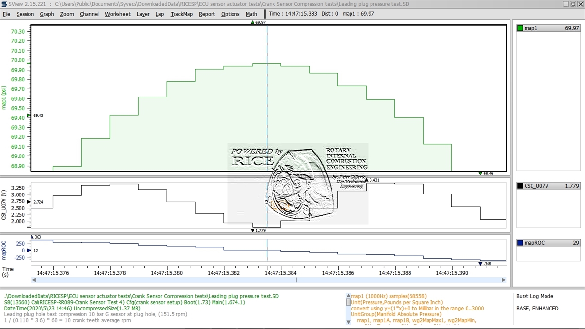

Here I same idea of logging the crank wheel I made up and a Syvecs pressure sensor (of appropriate range) to do a non running or roughly cranking speed engine TDC indirect measure, as its on a total shit box of an engine (Wanker or Wankel)
Also debunked a rubbish technique someone high lighted to me about using Mr Bubbles to do a similar thing....... that is not so nice
VIDEO > https://www.youtube.com/watch?v=wtOWk260sPc
And a few [pics] below....
