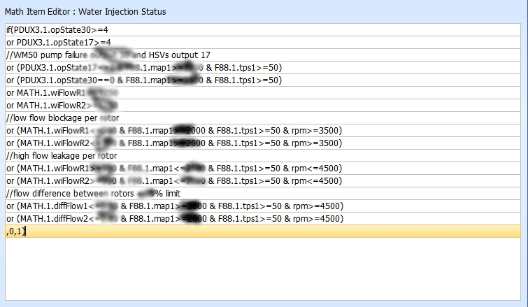

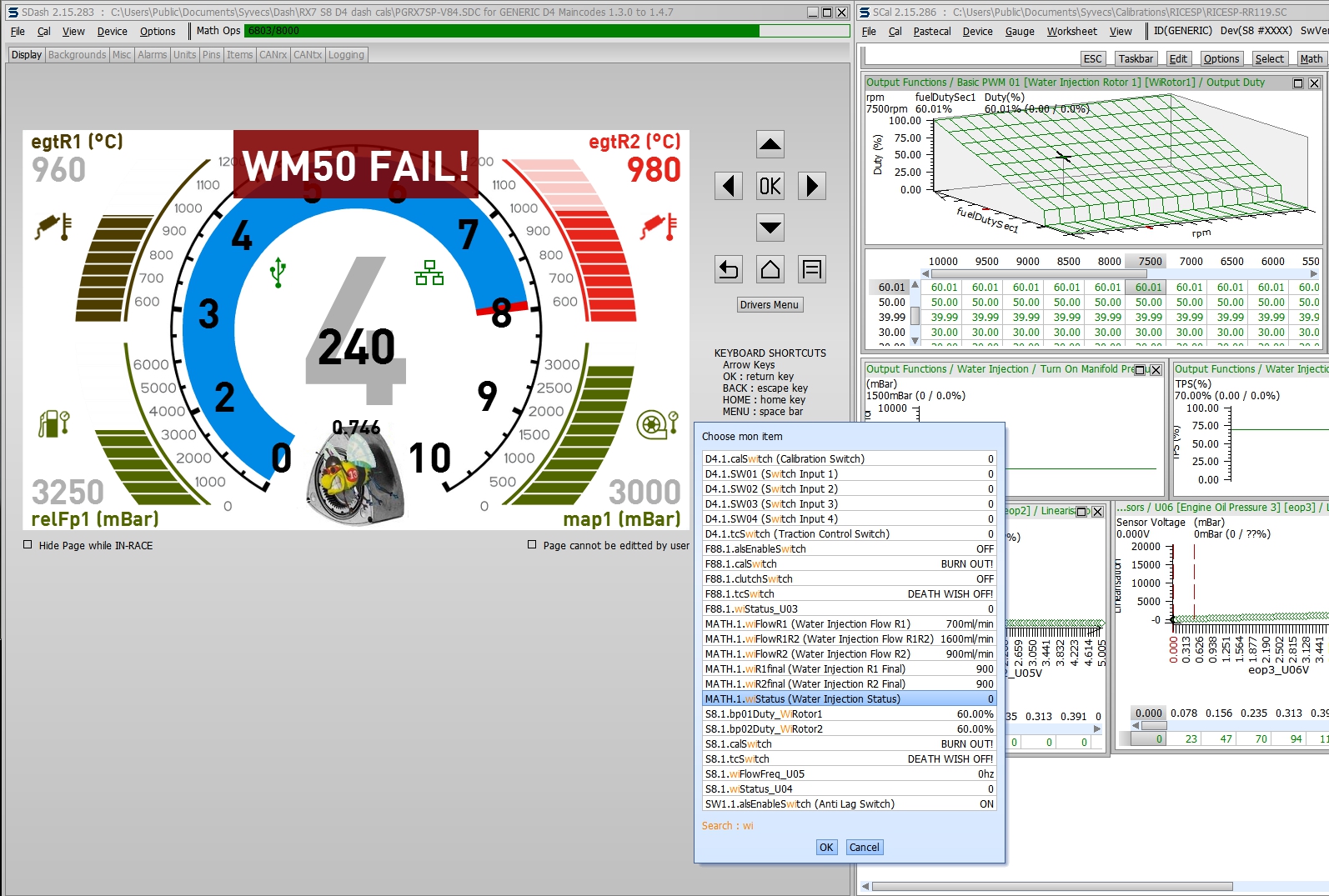

Now doing full integration with Dash/ECU, running complete strategies to measure flow/s, status, and per bank or rotor control.
Basics are:
*low flow
*high flow
*differential flow
*Solenoid fault
*Pump fault
Other items to follow....
Basics are:
*low flow
*high flow
*differential flow
*Solenoid fault
*Pump fault
- wiStatus 1500cc per rotor.jpg (202.12 KiB) Viewed 239051 times

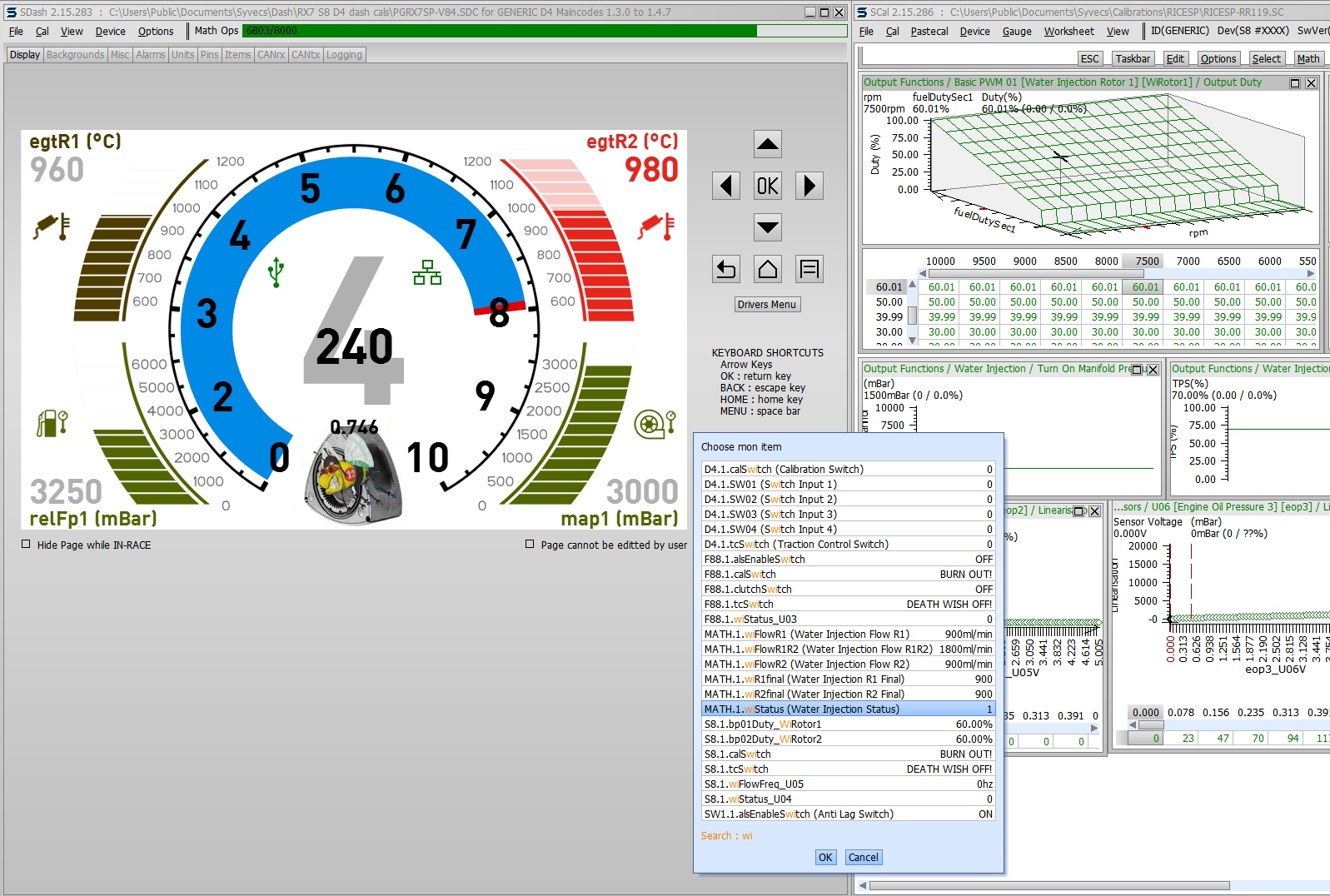

Simulation testing the control logic, all works
Maths used is allot more than posted above but hope it helps people interested in doing this.
Final Solution counters all Leak Block or Differential detection limits (Bank 1 Bank 2) or in this case per rotor

To do the control items I showed an example of above you need the maths ability of a LR/Syvecs D4/D5/D8 dash unit.stevieturbo wrote: Mon Aug 10, 2020 5:45 pm So have they finally allowed frequency inputs on the ecu, or did you have to do a workaround ?
For the frequency input currently need the use of both ECU and dash and wheel speed B channels used on ECU. It is down on the list to allow generic frequency input ability though.
Other power circuit related stuff I am using the PDUx3 states and the D4 dash to give status of the high speed valves and WI pump.
